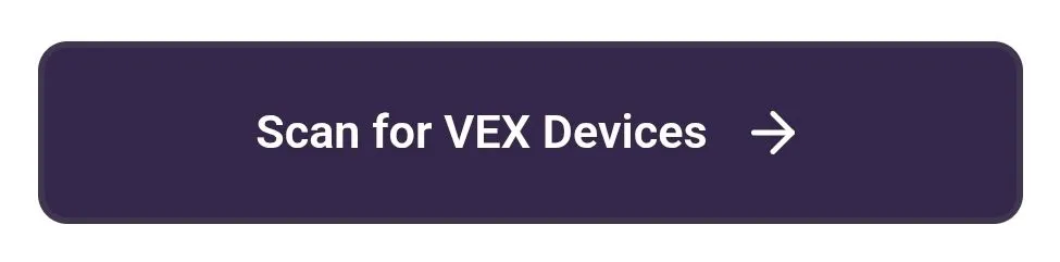

Scan for VEX Devices button in the VEX Classroom App.
Select Scan for VEX Devices to detect all of the 123 Robots that are currently turned on.

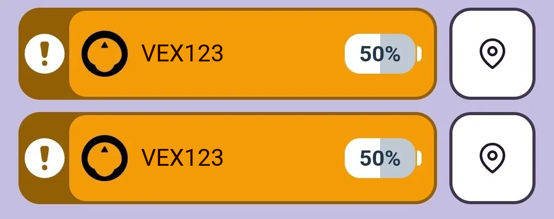

VEX Devices list in the VEX Classroom App showing two 123 Robots named 123 003 and 123 001. Both entries are shown in orange with an exclamation point icon and a battery level of 50%.
Each 123 Robot that is turned on will appear in the VEX Devices list.
The default name for the robots is "VEX123."

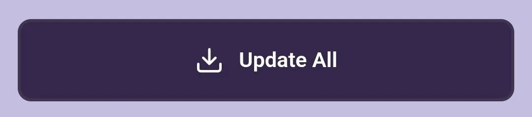

Update All button in the VEX Classroom App.
Before you can name the devices, they will need to be updated. Select Update All at the top of the screen, and you will see each item begin the update process.
This will update the robots one at a time, so you will see the progress bar move through each robot individually. Each update can take up to 2 minutes to complete. For more information about updating the firmware on multiple devices with the VEX Classroom App, see this article.

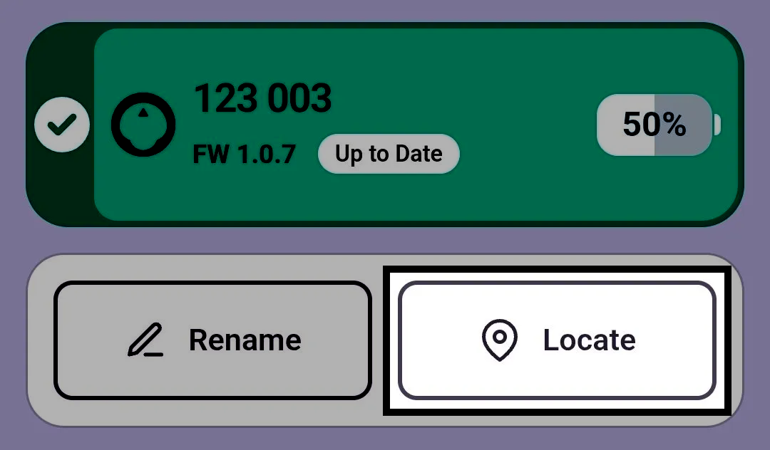

Device info page for a 123 Robot named 123 003 in the VEX Classroom App, showing firmware version 1.0.7 marked Up to Date and a battery level of 50%. The Locate button is highlighted.
After the robots have been updated, you can begin to name the devices so that their labels match their name within the VEX Classroom App and VEXcode 123.
To begin, select the first 123 Robot in the VEX Devices list. Then select Locate to identify which robot it is. For more information on how to locate a 123 Robot in the Classroom App, see this article.

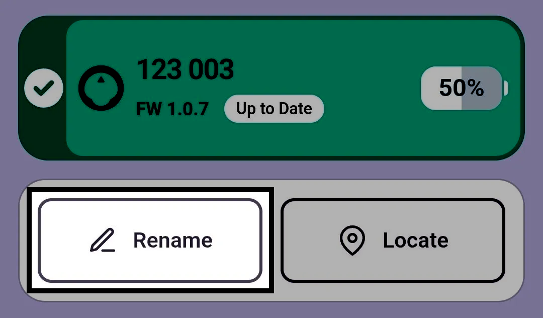

Device info page for a 123 Robot named 123 003 in the VEX Classroom App, showing firmware version 1.0.7 marked Up to Date and a battery level of 50%. The Rename button is highlighted.
After locating the 123 Robot, select Rename to change its name to match its label.

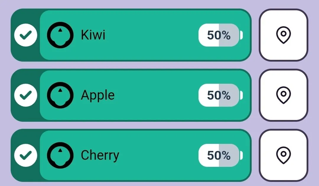

VEX Devices list in the VEX Classroom App showing three 123 Robots renamed Kiwi, Apple, and Cherry. Each entry is shown in green with a check mark and a battery level of 50%.
Continue this process until all 123 Robots are located and named.

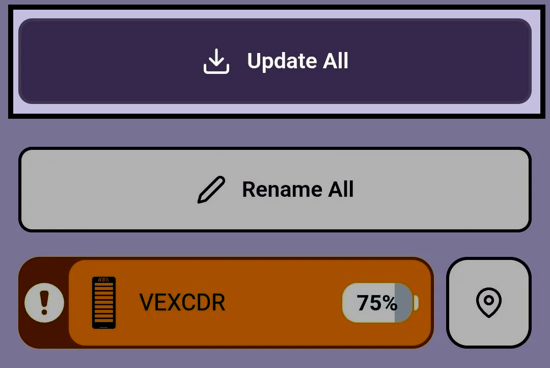

VEX Classroom App with the Update All button highlighted above the Rename All button. Below them, a VEX Coder named VEXCDR is shown in orange with an exclamation point icon and a battery level of 75%.
Coders can also be updated using the Update All option at the top of the screen. Or, you can update each Coder individually by selecting the Coder and then selecting Update.
The default name for VEX Coders is "VEXCDR."
For more information about updating Coder firmware with the VEX Classroom App, see this article.

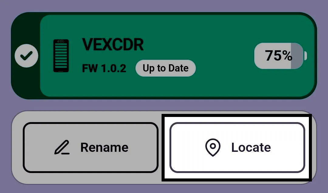

Device info page for a VEX Coder named VEXCDR in the VEX Classroom App, showing firmware version 1.0.2 marked Up to Date and a battery level of 75%. The Locate button is highlighted.
Once the Coders have been updated, select the first Coder in the VEX Devices list. Then select Locate to identify which Coder it is. The indicator light on the Coder will flash yellow.
For more information about locating and renaming VEX Coders, see this article.

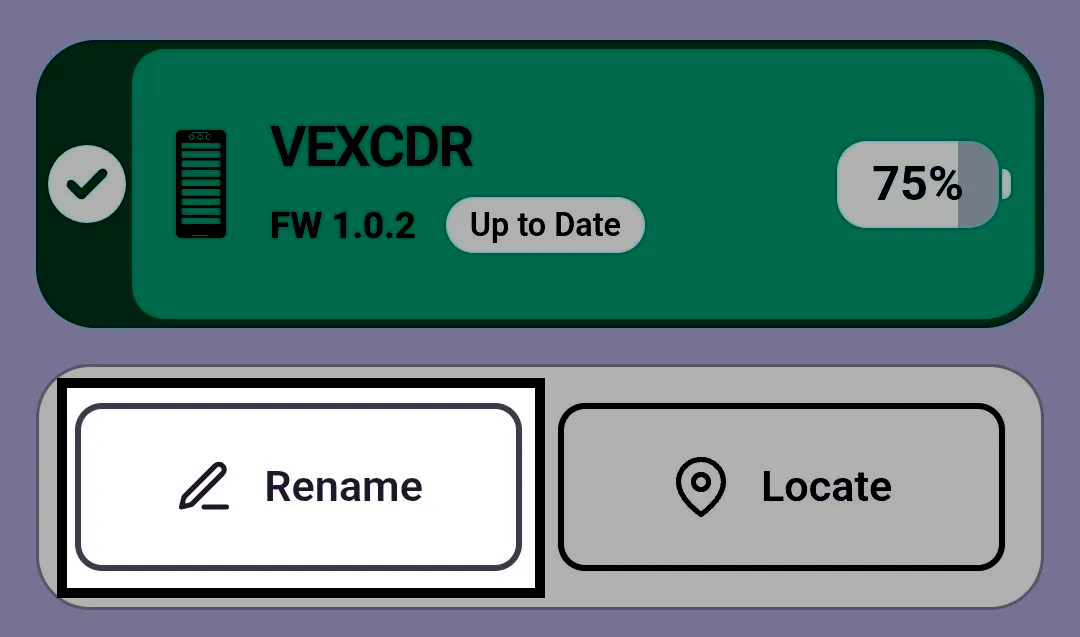

Device info page for a VEX Coder named VEXCDR in the VEX Classroom App, showing firmware version 1.0.2 marked Up to Date and a battery level of 75%. The Rename button is highlighted.
After locating the Coder, select Rename to change its name to match its label.

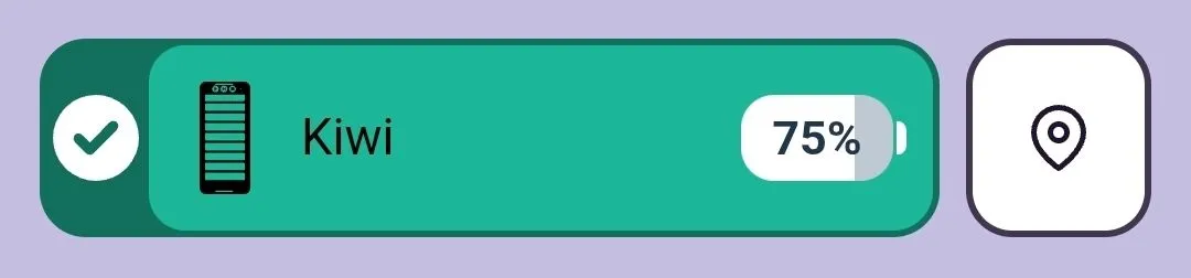

VEX Coder renamed Kiwi in the VEX Devices list, shown in green with a check mark and a battery level of 75%.
Continue this process until all Coders are located and named.
