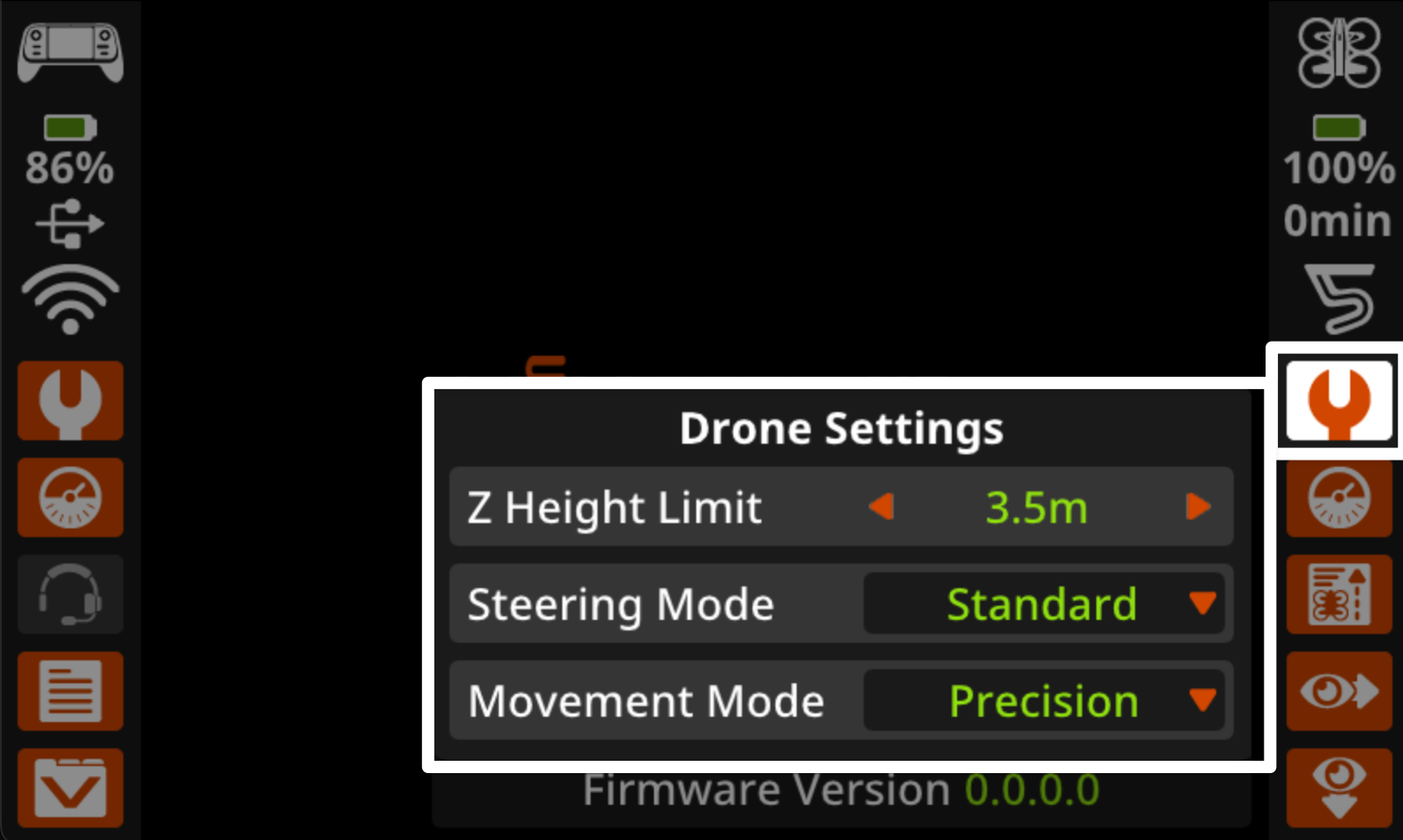

Problem: Drone is flying faster or slower than expected
Two VEX AIR Drones fly side by side, the one on the left moving more slowly, and the one on the right moving more quickly and zigzagging.
Symptom:
  • The drone drifts wildly while hovering and/or struggles to maintain level height.
  • The drone moves and turns more quickly or slowly than expected when controller joysticks are moved.
Possible Cause:
  • Damaged propellers.
  • A different Movement Mode is selected.
Solution:
  1. Verify the Movement Mode selected in the drone settings. The Movement Mode will stay from one flight session to the next, so if the controller was previously set to a different Movement Mode it may still be on that setting. Each Movement Mode provides a different amount of stability assist and flight speed, from Precision (slowest), to Balanced (somewhat faster), to Performance (high-speed, non-stabilized). Learn how to change drone settings, like Movement Mode, on the controller with this article.
  2. Inspect each propeller to ensure it spins freely, is securely attached, and is not damaged. If the propellers are not functioning properly the drone may not be able to maintain control or move accurately. Follow the steps in this article to clean or replace a propeller.
Problem: Drone is not flying to desired height
The VEX AIR Drone Controller screen with the Drone Settings menu open in the lower right quadrant. The first option reads Z Height Limit and is set to 2.5m.
Symptoms:
  • The drone stops climbing even when the throttle is increased.
Possible Cause:
  • Maximum Z Height Limit is set too low.
Solution:
  1. Adjust the settings for the Maximum Z Height of the drone in the drone settings on the controller. The Z Height Limit setting stays from one flight session to another, so if it was changed previously, it may need to be adjusted for your current flight.
