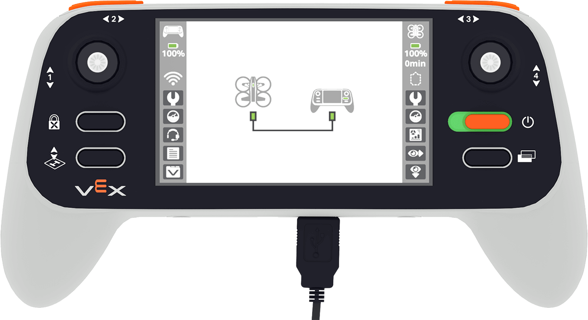

Controller is shown powered on and with its USB-A cable connected to the drone. The screen has a wired connection icon that shows a cable being used to connect the controller to the drone.
A wired connection image will show briefly on the screen when the controller begins pairing with the drone. The USB icon will also appear on the left while the controller is wired to the drone.
Once both LED indicators on the controller and drone are blinking and the live feed from the drone's forward-facing Vision Sensor is visible on the controller's screen, the two have been successfully paired. This animation shows this pairing process.
