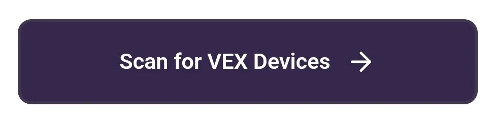

Scan for VEX Devices button in the VEX Classroom App.
Select the Scan for VEX Devices button to detect all of the GO Brains.

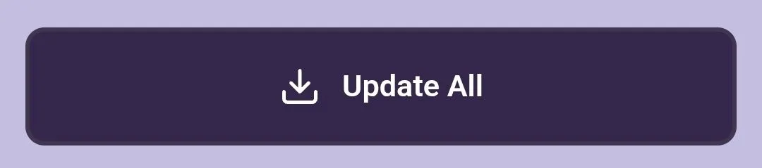

Update All button in the VEX Classroom App.
Before you can name the GO Brains, they will need to be updated. Select Update All at the top of the screen, and you will see each GO Brain begin the update process.
This will update all of the GO Brains sequentially. Each update can take up to 2 minutes to complete. For more information about updating the firmware on multiple GO Brains with the VEX Classroom App, see this article.

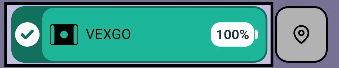

VEX Devices list in the VEX Classroom App with a GO Brain named VEXGO highlighted. The entry shows a check mark and a battery level of 100%.
After the brains have been updated, you can begin to name them so that their labels match their name within the VEX Classroom App and VEXcode GO. All VEX GO Brains begin with the same name - "VEX GO."
To begin, select one of the brains from the VEX Devices list.

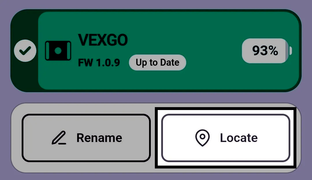

Device info page for a GO Brain named VEXGO in the VEX Classroom App, with the Locate button highlighted.
From inside the device's info page, select Locate to turn the GO Brain's indicator light yellow to indicate which brain that is.

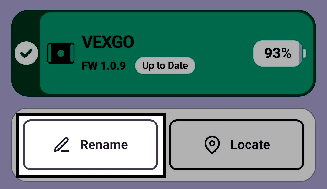

Device info page for a GO Brain named VEXGO in the VEX Classroom App, with the Rename button highlighted.
Select Rename to change the name of the brain to match its label.

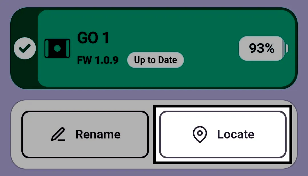

Device info page for a GO Brain named GO 1 in the VEX Classroom App, with the Locate button highlighted.
If the brain appears, then another group may have mistakenly used the robot. Select the brain and then the Locate button to locate the missing robot.
Once the specific GO Brain is located, the button on top of the brain will turn yellow as shown in this animation. Turn it into a classroom search and have everyone look out for the yellow brain!
