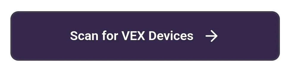

Scan for VEX Devices button in the VEX Classroom App.
When you open the VEX Classroom App, you will see an image of Colonel Jo explaining the purposes of the app.
Select Scan for VEX Devices to begin.

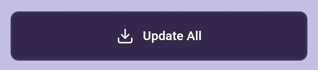

Update All button in the VEX Classroom App.
The firmware on one or multiple GO Brains can be updated at a time using the VEX Classroom App.
Select Update All to update the firmware of all the GO Brains.

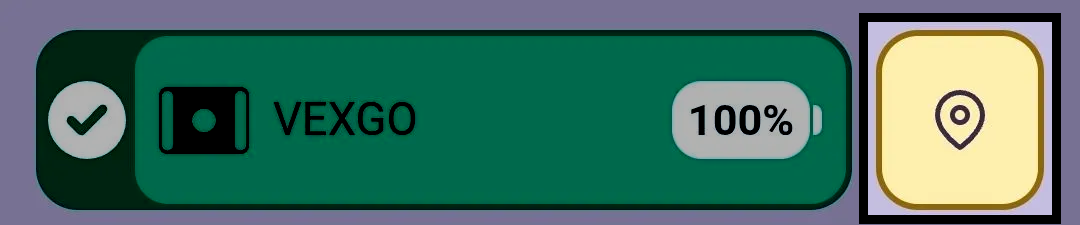

A GO Brain can be located using the app. The location feature identifies a specific brain by making the indicator light on top of the brain turn yellow.

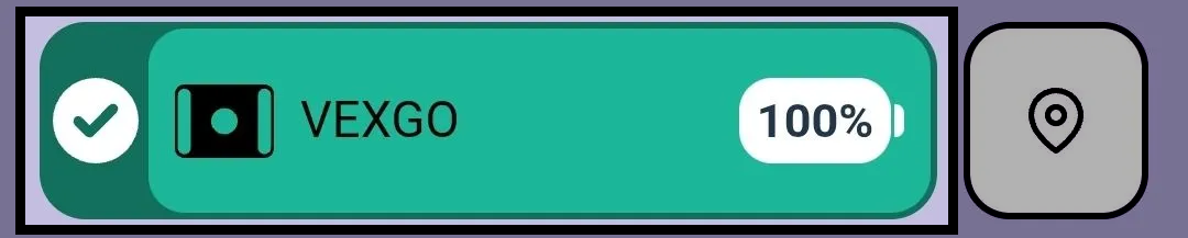

VEX Devices list in the VEX Classroom App with a GO Brain named VEXGO highlighted. The entry shows a check mark and a battery level of 100%.
To locate a GO Brain, find the brain that you want to locate.

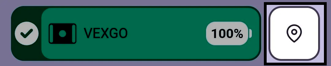

GO Brain named VEXGO in the VEX Devices list, with the Locate icon to the right of its entry highlighted.
Select the Locate icon next to the brain's name.
GO Brain named VEXGO in the VEX Devices list, with the Locate icon highlighted and shown in yellow.
The Locate icon will begin to flash yellow.
Once the specific GO Brain is located, the button on top of the brain will turn yellow, as shown in this animation.

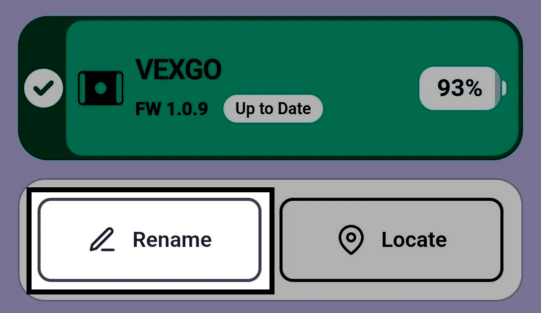

To rename a GO Brain, select the brain that is to be renamed.
Device info page for a GO Brain named VEXGO in the VEX Classroom App, with the Rename button highlighted.
Select Rename.

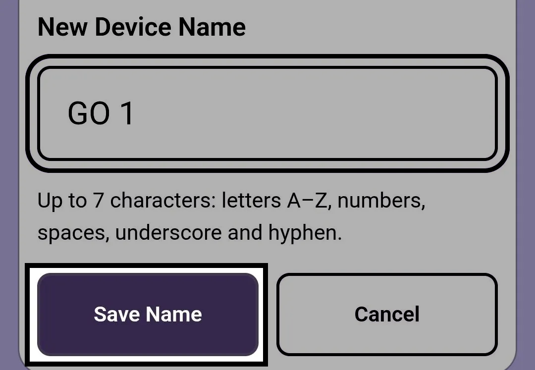

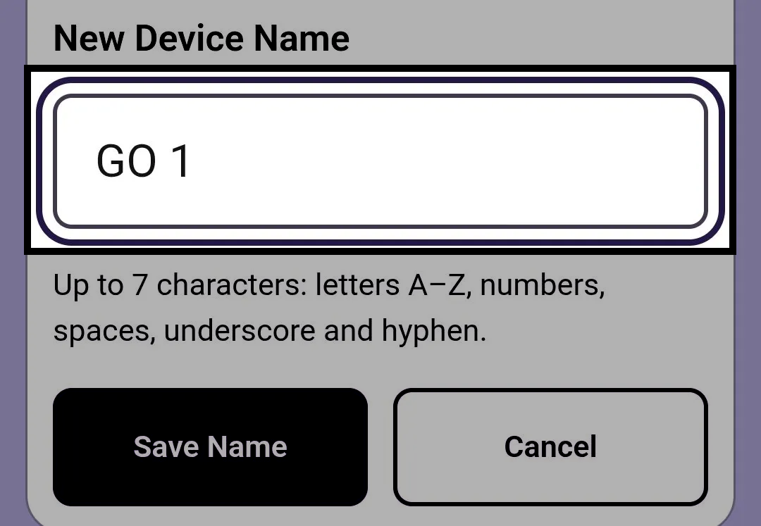

New device name window in the VEX Classroom App with the text field highlighted and GO 1 typed in. The text below the field reads Up to 7 characters: letters A–Z, numbers, spaces, underscore and hyphen.
Select the text field to begin typing in the new name.
New device name window in the VEX Classroom App with GO 1 entered in the text field and the Save name button highlighted.
Select Save Name to set the brain's name.

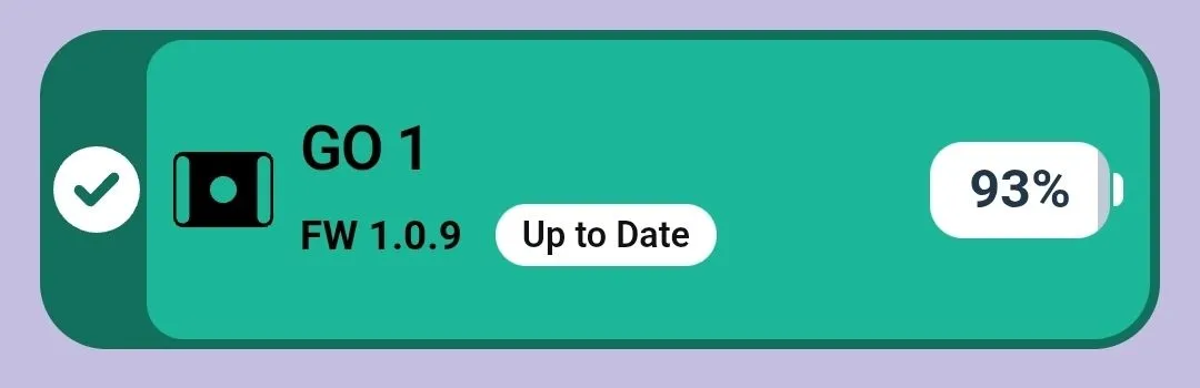

GO Brain entry in the VEX Classroom App showing the new name GO 1, firmware version 1.0.9 marked Up to date, and a battery level of 99%.
The new name will then be displayed.

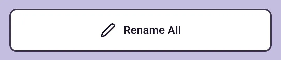

VEX Devices list in the VEX Classroom App with the Rename All button highlighted.

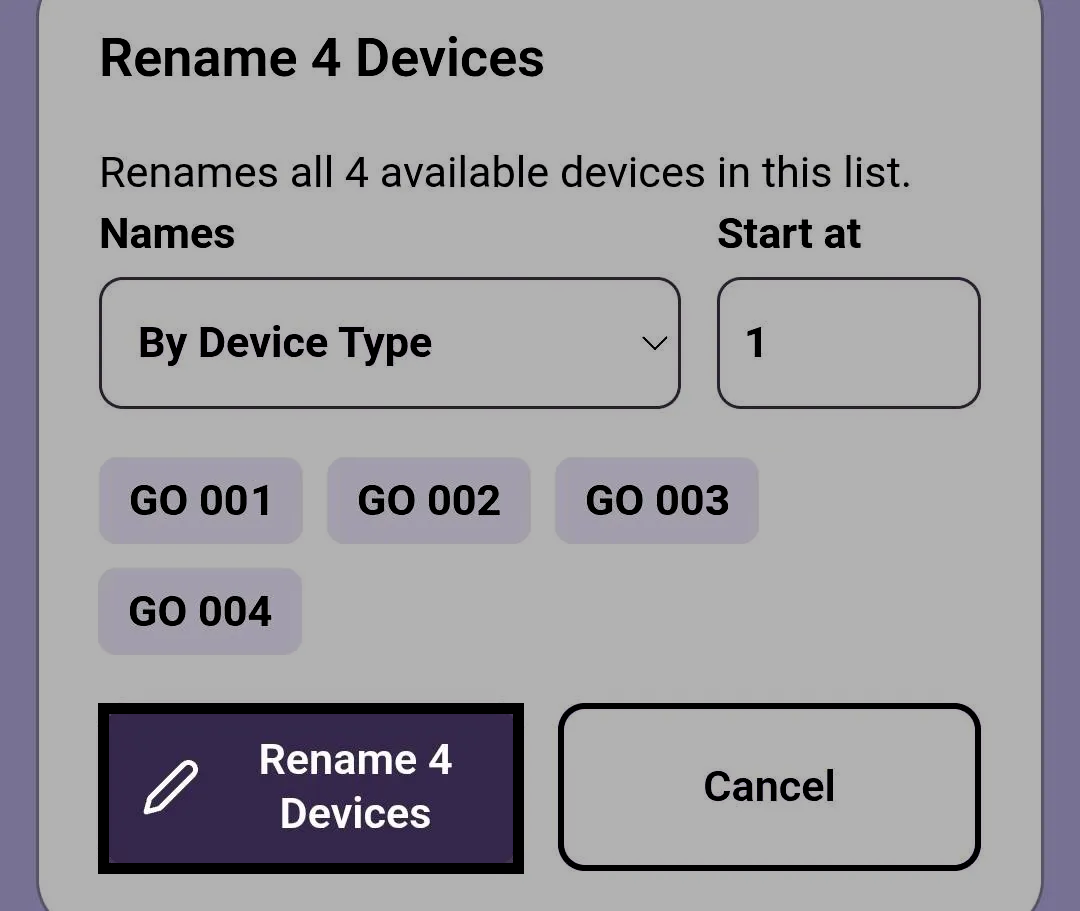

To rename all detected GO Brains at once, select Rename All.

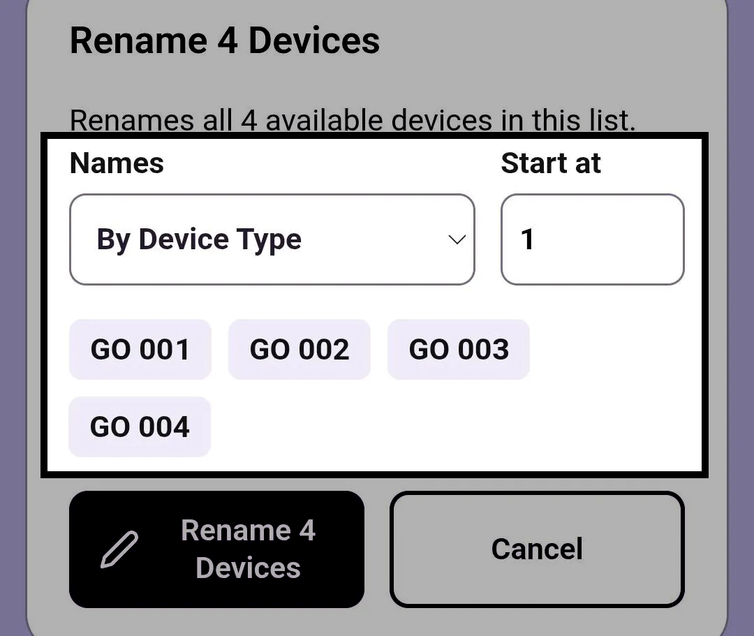

Rename all window in the VEX Classroom App with the default naming option selected, which names each GO Brain GO followed by a number.
By default, each GO Brain is named GO followed by a number, such as GO 1 and GO 2.

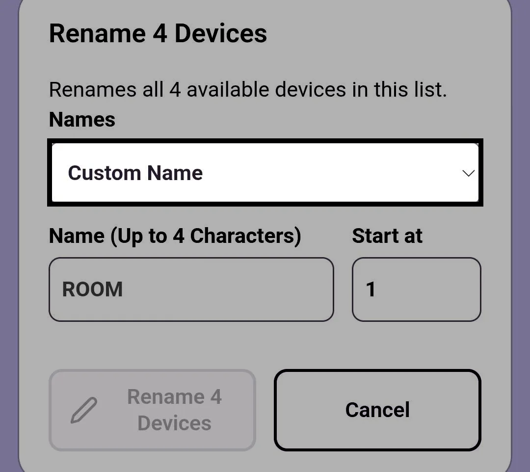

Rename all window in the VEX Classroom App with Custom Name selected in the dropdown menu and a custom name entered in the text field.
To use your own name instead, select Custom Name from the dropdown menu. Each GO Brain will be named with your custom name followed by a number, such as SMITH 1.
Rename all window in the VEX Classroom App with the Rename button highlighted.
Select Rename to rename all GO Brains.

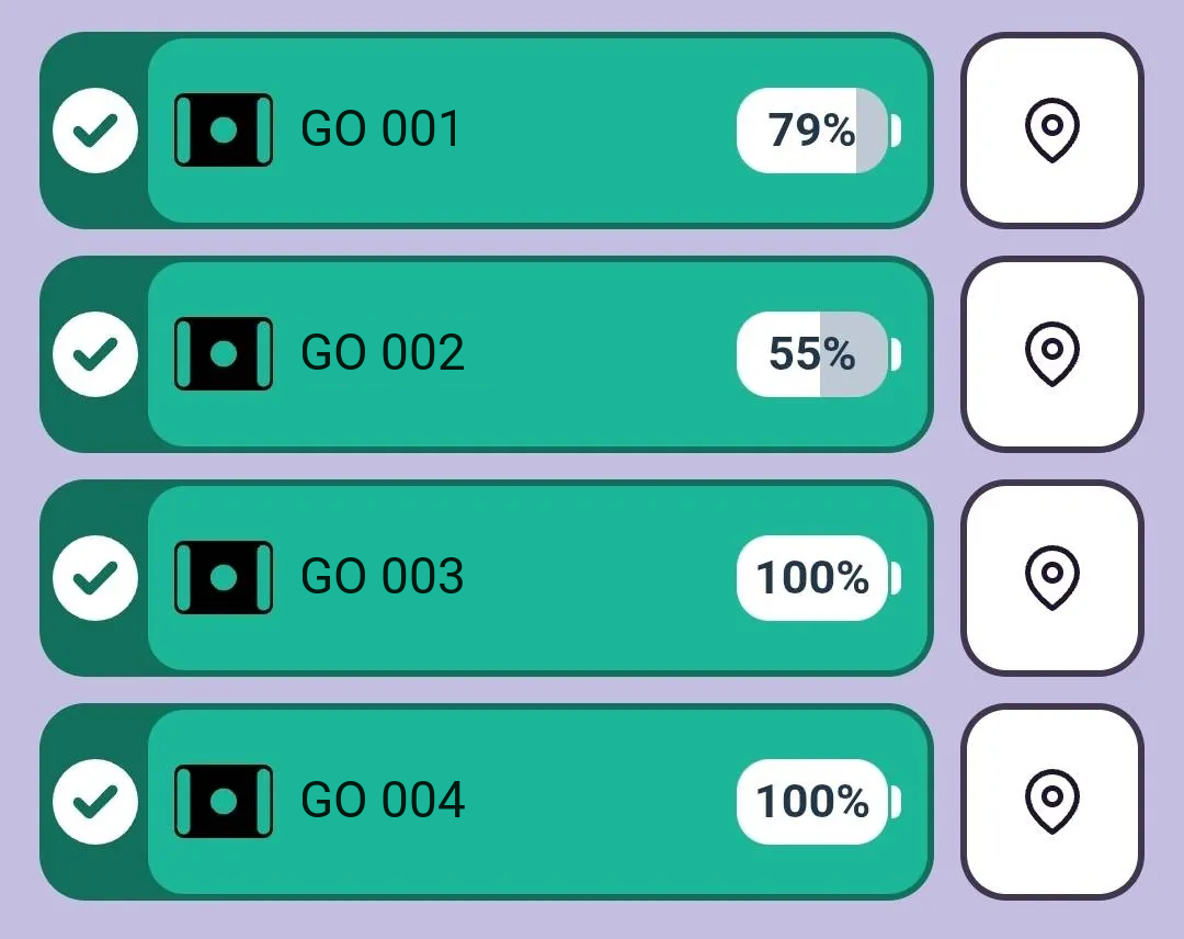

VEX Devices list in the VEX Classroom App showing four GO Brains with their new names.
The new names are displayed in the VEX Devices list, so each GO Brain can be easily identified.

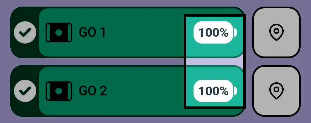

VEX Devices list in the VEX Classroom App showing two GO Brains, GO 1 and GO 2, with their battery levels of 100% highlighted.
The state of each GO Brain’s Battery is listed. This can be used to monitor the battery life of all detected GO Brains.

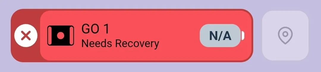

GO Brain named GO 2 in the VEX Devices list shown in red with an X icon and the status Needs recovery. Its battery level reads N/A.
Note that the battery life will not appear if a GO Brain's firmware is in recovery mode.

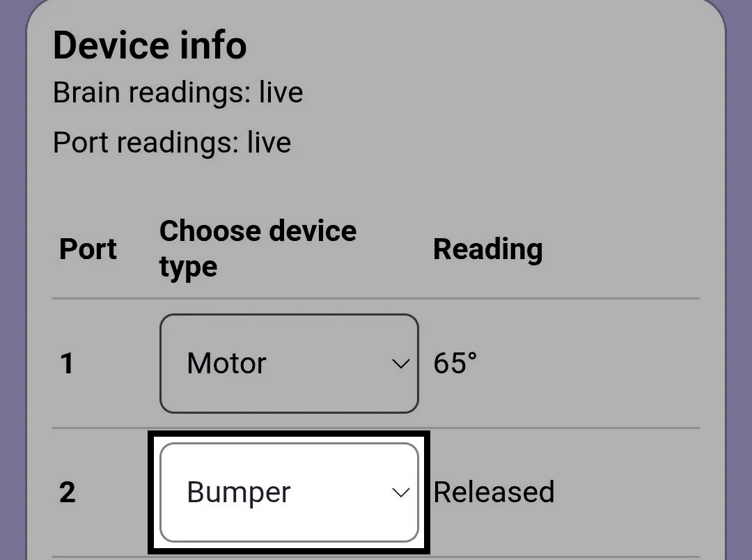

Device info section in the VEX Classroom App showing live Brain and Port readings. Port 1 is set to Motor with a reading of 65 degrees, and Port 2 is set to Bumper with a reading of Released. The Bumper device type dropdown is highlighted.
Scroll down to see the Device info. This will show a Super Code Base configuration of devices. Select the devices to change them and get real-time readings on those sensors.

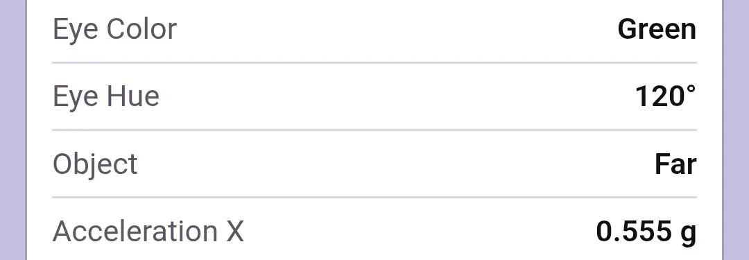

Table of live sensor readings in the VEX Classroom App: Eye color Green, Eye hue 120 degrees, Object Far, Acceleration X -0.005 g, Acceleration Y 0.342 g, and Acceleration Z -0.928 g.
Below is a table that displays the real-time values returned by the Eye Sensor and the GO Brain's Inertial Sensor.

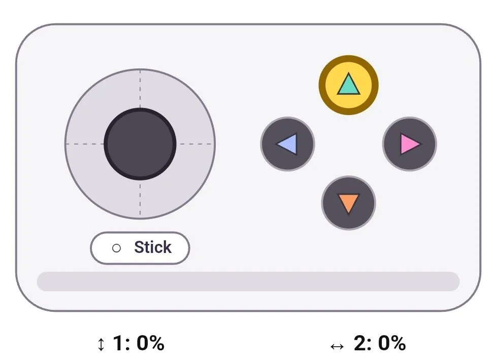

Virtual One Stick Controller in the VEX Classroom App with the joystick centered and the up button highlighted in yellow. Axis 1 and Axis 2 both read 0%.
At the bottom is a virtual One Stick Controller, that will show the position of the joystick and whatever buttons on the controller that are currently being pressed if one is paired to that GO Brain.

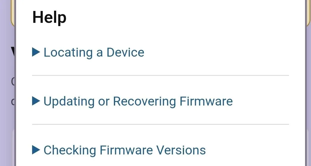

Accessing Help in the VEX Classroom App

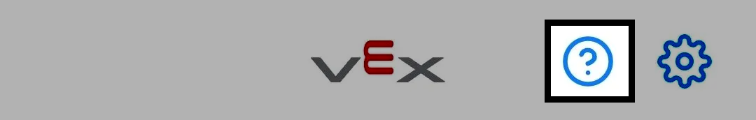

Top bar of the VEX Classroom App with the VEX logo, the Help icon highlighted, and the Settings icon.
Select the Help icon at the top right of the VEX Classroom App.
Help menu in the VEX Classroom App listing four documents: Set up a new classroom, Find and identify devices, Understand fleet results, and Update or recover firmware.
Select the name of the Help document that you want to read to open it in the app.
Select the Help icon again to close the Help documentation.
