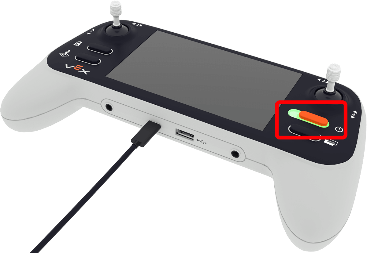

Charging the Controller
USB-C cable is being connected to the Controller's USB-C port.
To charge the controller, connect it to a power source via its USB-C port.

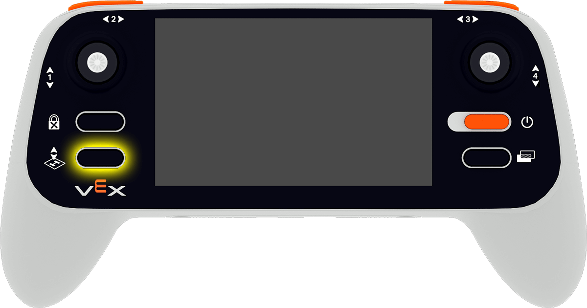

Controller with its Takeoff and Land button highlighted below the Propeller Lock button.
The Takeoff & Land button opens the project menu, allowing a project to be selected and started.
When a project is already running, and the drone is flying, pressing the button opens the landing menu.

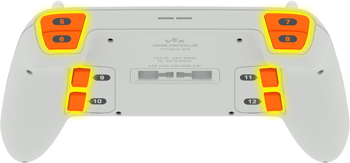

Programmable Buttons
View of the Controller from the back to show its 8 programmable buttons that are labeled 5 to 12. The buttons are organized in four pairs of 2, and the buttons are highlighted.
The controller includes eight programmable buttons that can be used in VEXcode AIR projects, as well as  the default_fly  project. These buttons are labeled with numbers 5 through 12.
For more information about coding the controller's buttons, see the VEXcode API Reference for Blocks or Python.

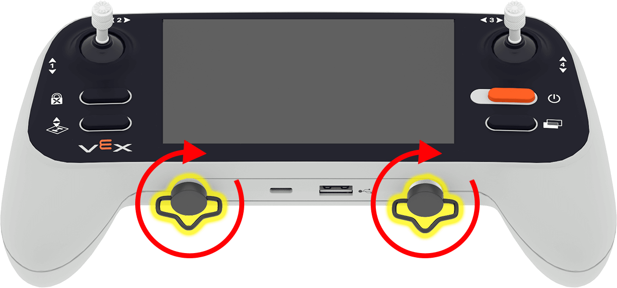

Back of the controller is shown with the two joysticks stored in two small compartments. The joysticks are highlighted to indicate that they must be removed before use.
The controller's joysticks must be installed before flight. They are stored on the back of the controller.
Diagram shows the two joysticks being screwed into their holders on the front of the controller. There is one joystick holder on each side of the controller's screen, and an arrow indicates that they should be screwed in clockwise.
The joysticks can then be screwed into the joystick slots on the front of the controller.
Joysticks should be removed and replaced in the back of the controller when storing the controller in the case.

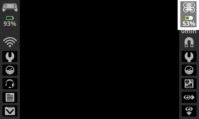

Controller Settings

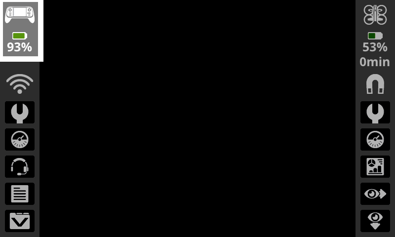

The information and buttons on the left side of the interface reference the controller.
The same image as the one previous, now with the controller battery status information in the upper left corner highlighted, reading 42 percent and showing a partially filled battery icon.
Controller Battery
The top left corner shows the controller's current battery level.
The same image as the one previous, with the USB icon and connection icon highlighted on the right side, below the battery information. The connection icon is green, indicating a drone is connected.
Connection Status
The connection status of the controller is shown below the battery information. There are two connection icons:
  • USB connection - When the controller is connected via USB cable, the USB icon will appear.
  • Drone connection - When the controller and drone are actively connected, the connection icon will show green (as seen here). It will show white when disconnected.

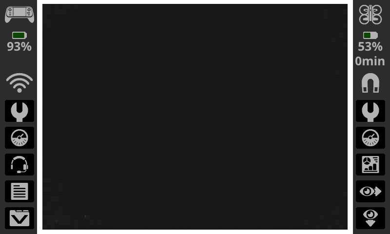

Drone Settings
The buttons and information on the right side of the interface reference the drone.
The same image as the one previous, now highlighting the drone battery information in the upper right corner, showing a drone icon and reading 67% with a partially filled battery icon and 6 minutes.
Drone Battery
The top right corner shows the drone's current battery level, as well as the approximate amount of time left until the battery will need to be charged.
The same image as the one previous, with a magnet icon highlighted below the drone battery information on the right side, indicating that the magnet module is connected.
Module
The Module indicator is below the battery information. This icon indicates which, if any, of the Modules are attached to the drone – Magnet (as shown here), Motorized Hook, or a dotted line icon indicates the Passive Hook Module or no Module attached.

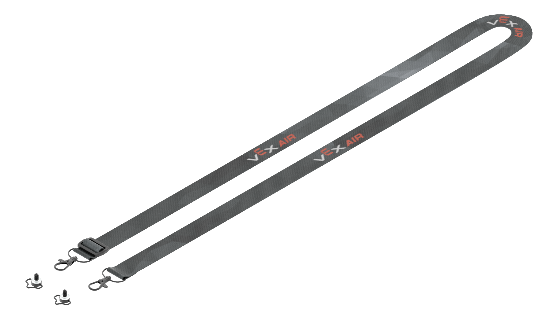

Using the Controller Lanyard
Controller lanyard is shown with its two lanyard pins beside it.
The VEX AIR Drone Controller comes with a lanyard that attaches to the bottom of the controller. Wearing the lanyard helps prevent the controller from falling if the pilot loses grip during a flight session.
