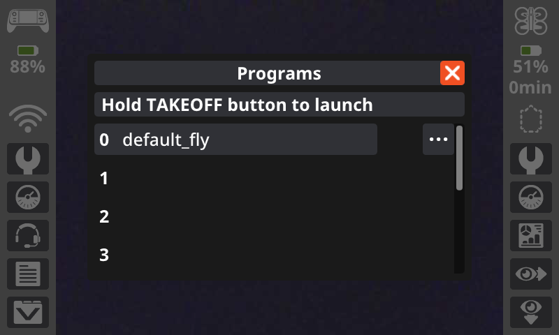

The controller screen with the programs menu open and the default fly project listed in slot 0. The screen reads Hold Takeoff button to launch.
A menu will appear on the screen showing all current projects loaded on the controller.
Press the project that you want to use. The default_fly project allows you to fly the drone directly with the controller.
Once the project is selected, hold down the Takeoff & Land button until the project slot is filled with the color orange. Then, release the button to begin the project.

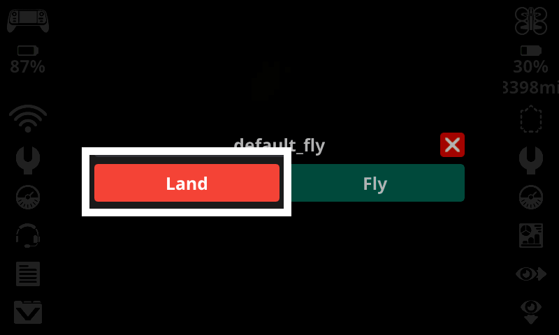

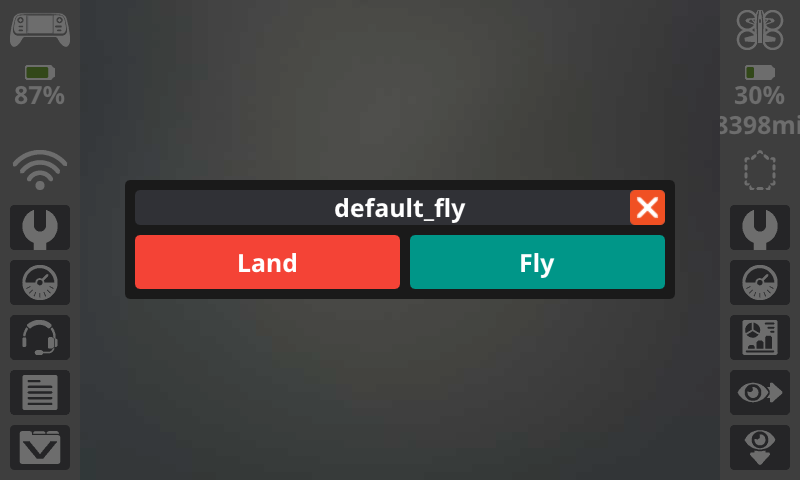

The controller screen with a Mission Summary pop up window in the center. The program flown and Mission duration in minutes and seconds is shown at the top. Along the bottom it reads fly drone to safe location and click land, with a land button beneath.
To land the drone manually, press the Takeoff & Land button while a project is running. A pop-up will appear in the middle of the controller's screen, prompting you to fly to a safe location to land. Pressing Land will stop the project and land the drone.
Once the drone lands, the Mission Summary remains on the screen showing the program that was flown and the mission duration in minutes and seconds. Select Close to close the Mission Summary and end the project.
