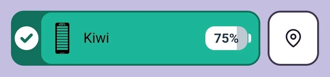

To view a Coder's device info, first select the Coder you want to view from the VEX Devices list. Then scroll down to the Device Info section.

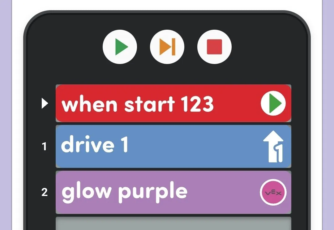

Card Snapshot in the VEX Classroom App showing a virtual Coder with Start, Step, and Stop buttons. The project reads when start 123, drive 1 in slot 1, and glow purple in slot 2. Slot 3 is empty.
The Coder cards that are currently inserted in the 123 Coder will show in the Card Snapshot.

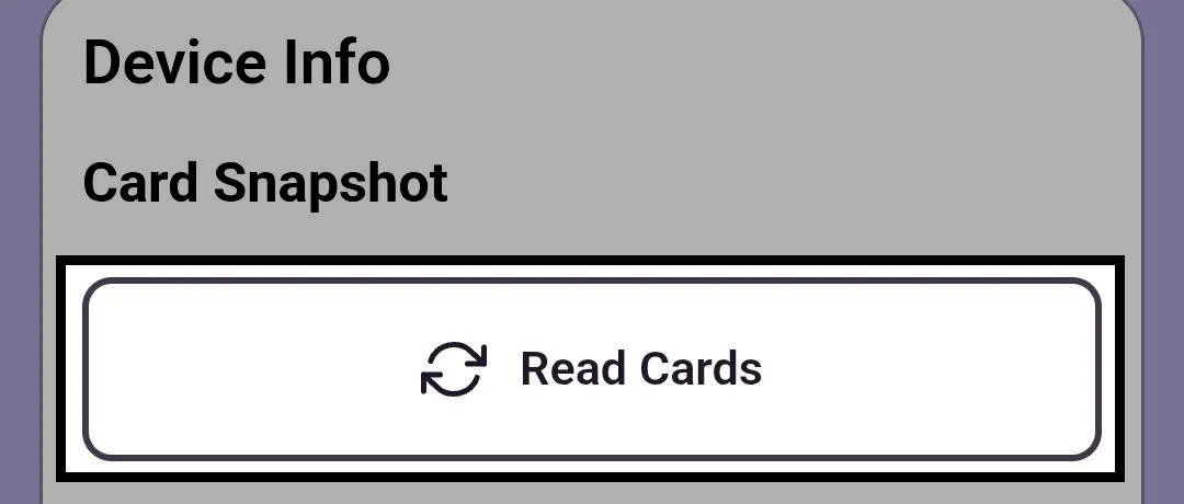

Update Coder Cards
Device Info section for a VEX Coder in the VEX Classroom App showing the Card Snapshot heading and the Read Cards button.
When the Coder project has changed, select Read Cards to view the updated project.

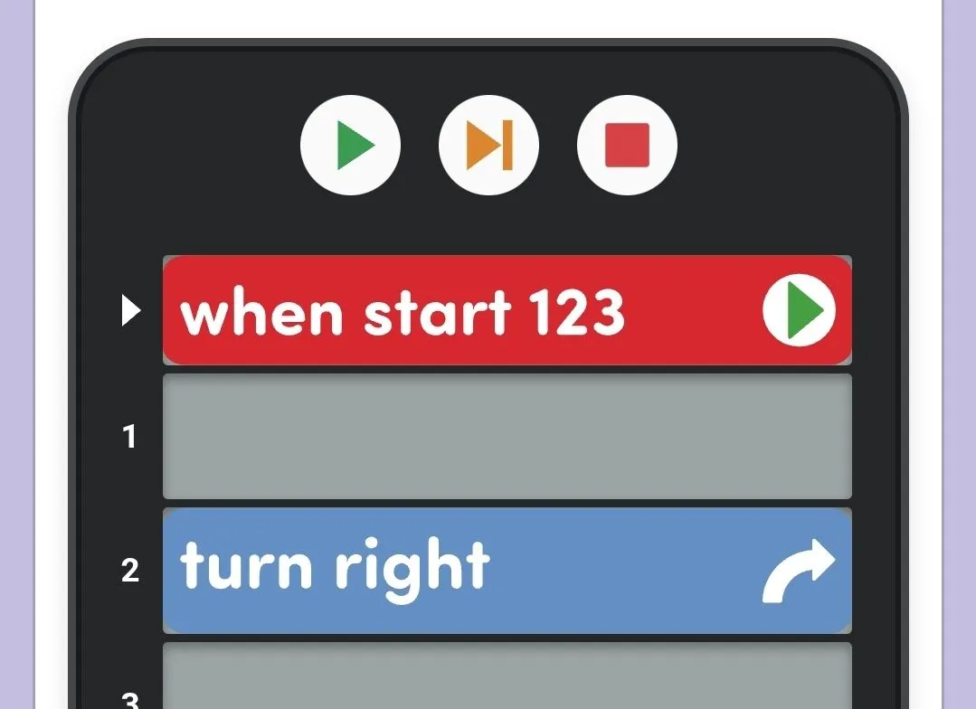

Card Snapshot in the VEX Classroom App showing a Coder project that reads when start 123, an empty slot 1, and turn right in slot 2. Slot 3 is also empty.
If a Coder slot is empty and does not have a Coder card in it, it will show as a blank space in the slots. An empty slot in a project could cause the project not to run as intended.

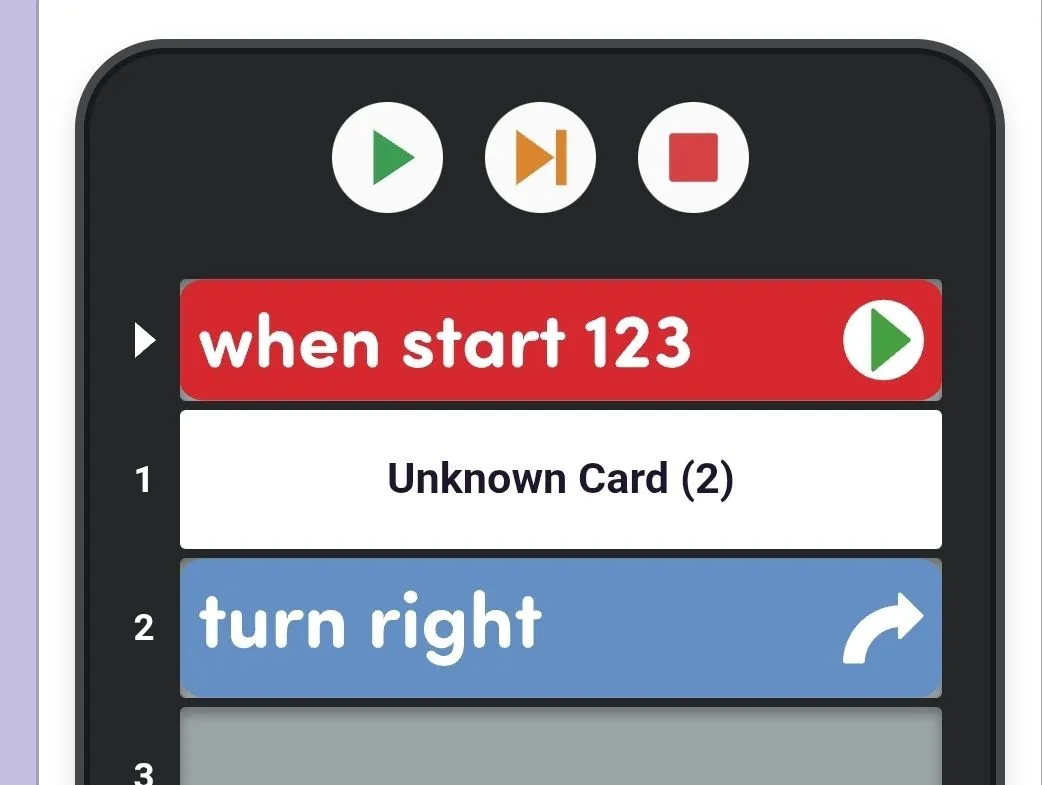

Card Snapshot in the VEX Classroom App showing a Coder project that reads when start 123, Unknown Card (2) in slot 1, and turn right in slot 2.
If a Coder card is not inserted properly (upside down, backwards, bent, etc.) or damaged, it will read "Unknown Card" instead.

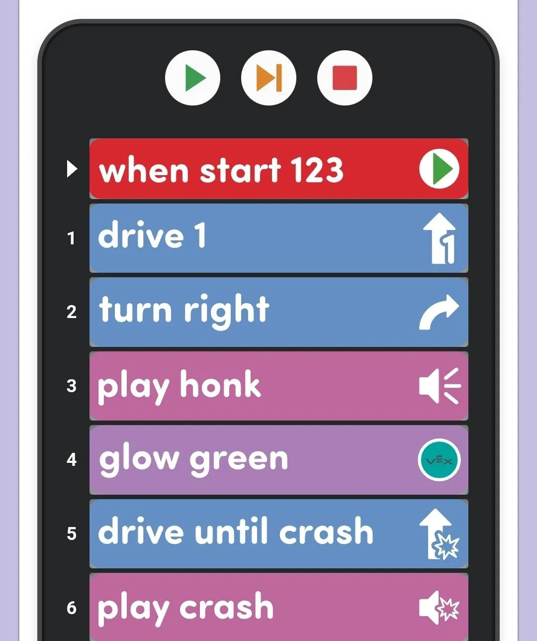

Card Snapshot in the VEX Classroom App showing a complete Coder project: when start 123, drive 1, turn right, play honk, glow green, drive until crash, and play crash.
If the project students have created is not working as intended after verifying that the project logically makes sense, check the device info provided by the 123 Robot in the VEX Classroom App. Follow the steps in this article to learn more about troubleshooting the 123 Robot with the VEX Classroom App.
