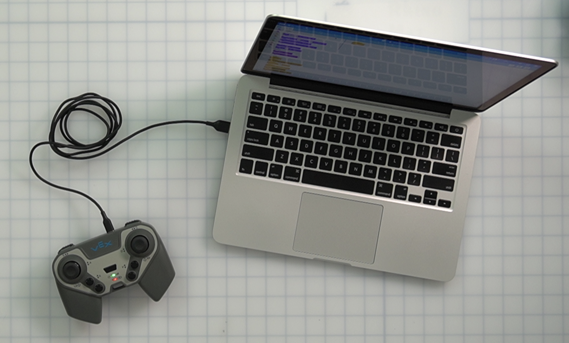

Connect your USB cable
Controller connected to a laptop computer using a USB cable.
Connect the USB cable to both your Mac, Windows, or Chromebook device and your IQ (2nd generation) Controller.

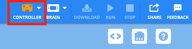

VEXcode IQ Toolbar with an orange Controller icon that is highlighted to the left of the Brain icon.
If the Controller icon in the VEXcode IQ Toolbar shows orange, your Controller and Brain may be  unpaired at any time, or your Controller's firmware may be out of date.
Be sure both the Brain and Controller are powered on, and follow the steps to reconnect if needed.
Or, follow the steps in this article to update your Controller's firmware.

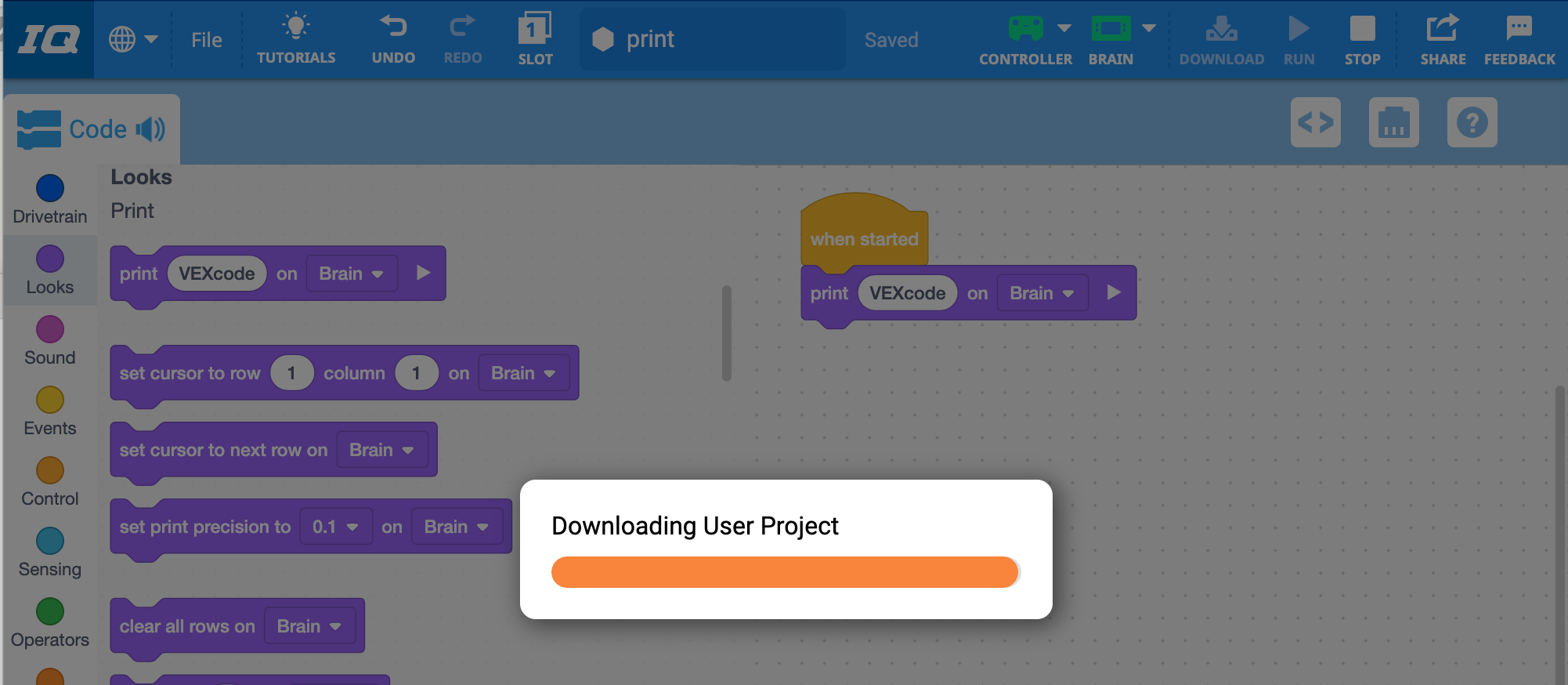

Download your project
VEXcode IQ Downloading User Project prompt with a progress bar that indicates it is still downloading.
With the USB cable still connected to both the (2nd generation) Controller and your device, select Download in the VEXcode IQ Toolbar to download your project. You will see a 'Downloading User Project' progress bar.

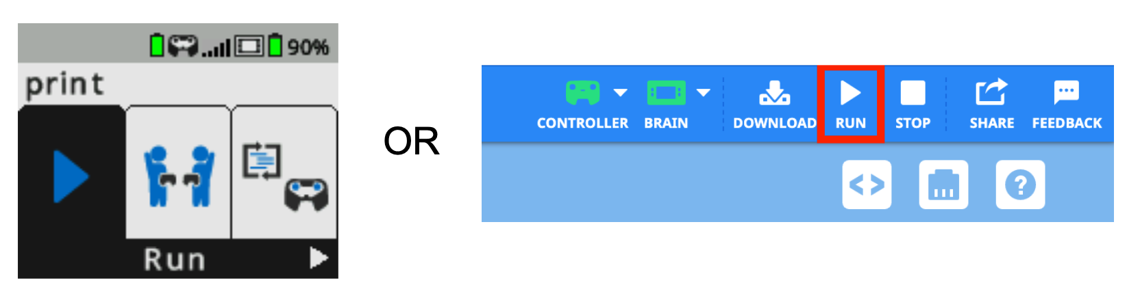

Run your project
Diagram that indicates that the project can be run using the Run button on the Brain, or the Run button on the VEXcode IQ Toolbar.
You will see your project on the Brain screen, and you can run your project using the buttons on the Brain, or the Run button in VEXcode IQ.
