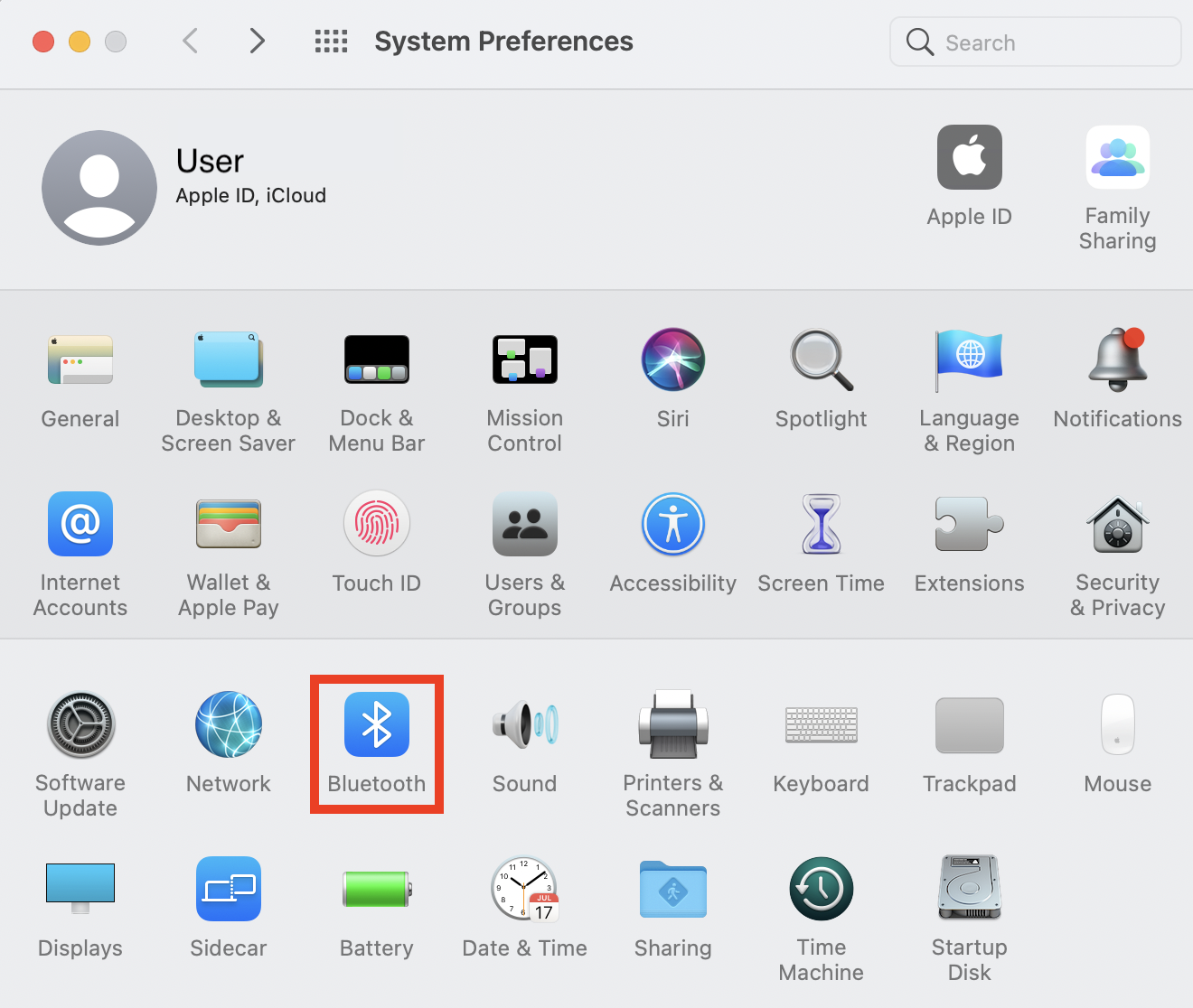

    To ensure Bluetooth is enabled on your macOS device, first open ‘System Preferences.’
    Illustration of Bluetooth connectivity issues, depicting a smartphone and a Bluetooth device with a warning symbol, used in the context of troubleshooting Bluetooth connections.
    Select ‘Bluetooth’ from the list of icons.

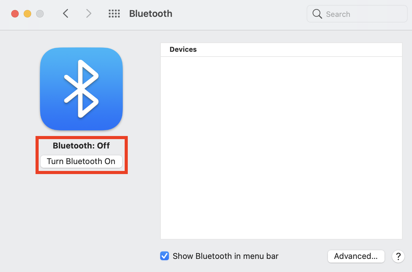

    Off turn on button for troubleshooting Bluetooth connection, showing a toggle switch in the off position.
    The status will display as 'Off' below the bluetooth icon. Select 'Turn Bluetooth On' to enable Bluetooth.

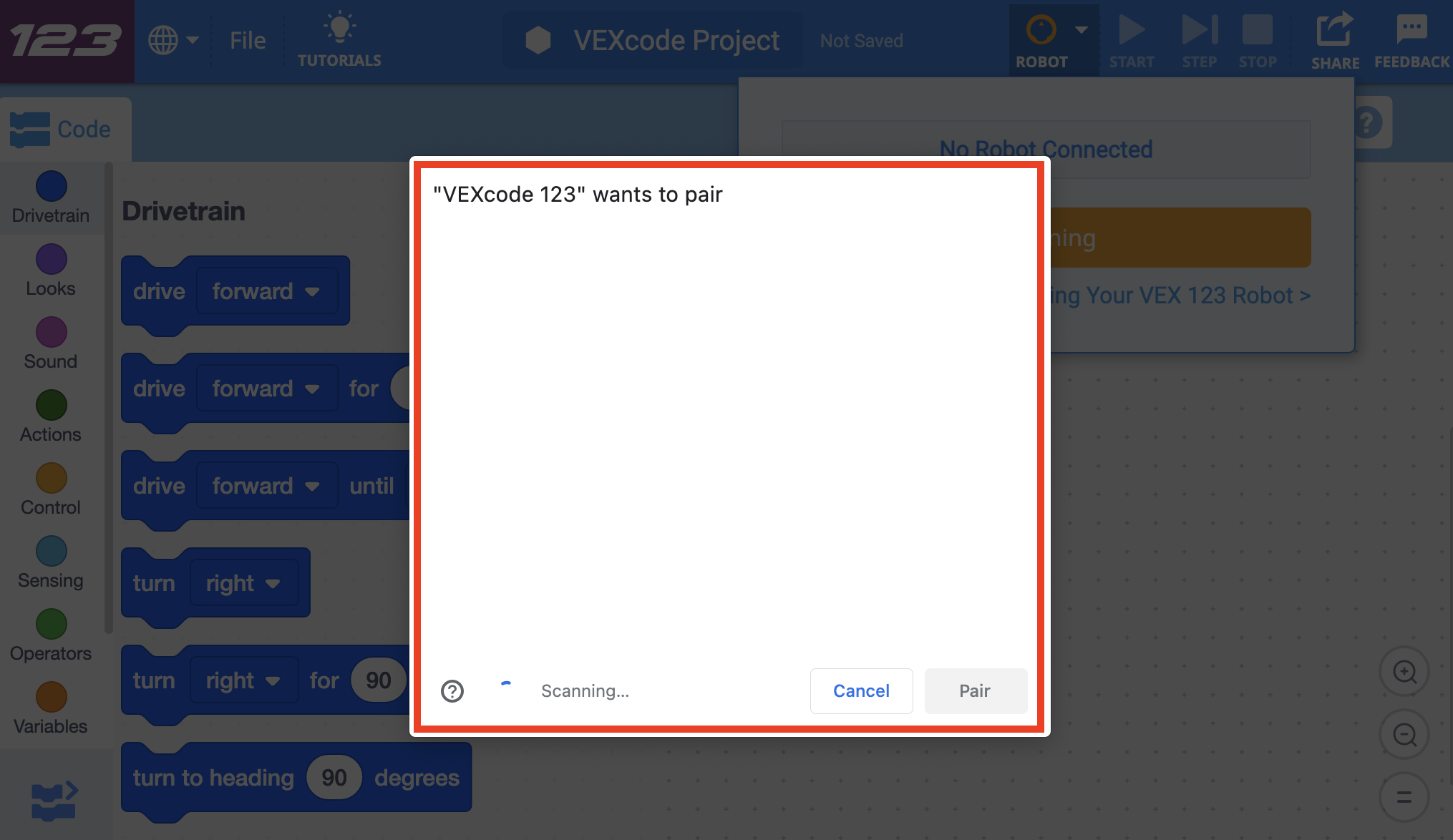

    Note: VEX 123 / VEX GO uses 'Bluetooth Low Energy' and will not appear in the device list in the Bluetooth Preferences Window. VEX GO and VEX 123 are devices that are connected via the Chrome Browser.

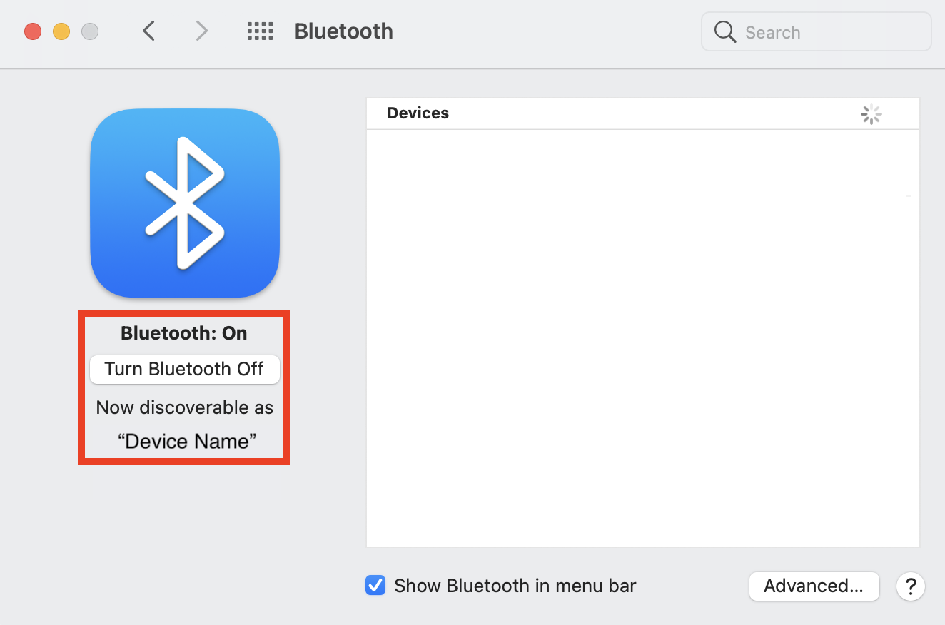

    Bluetooth settings interface showing options to turn Bluetooth on or off, used for troubleshooting Bluetooth connection issues.
    The status will display as 'On' when Bluetooth is enabled, and the discoverable name of the device will show.

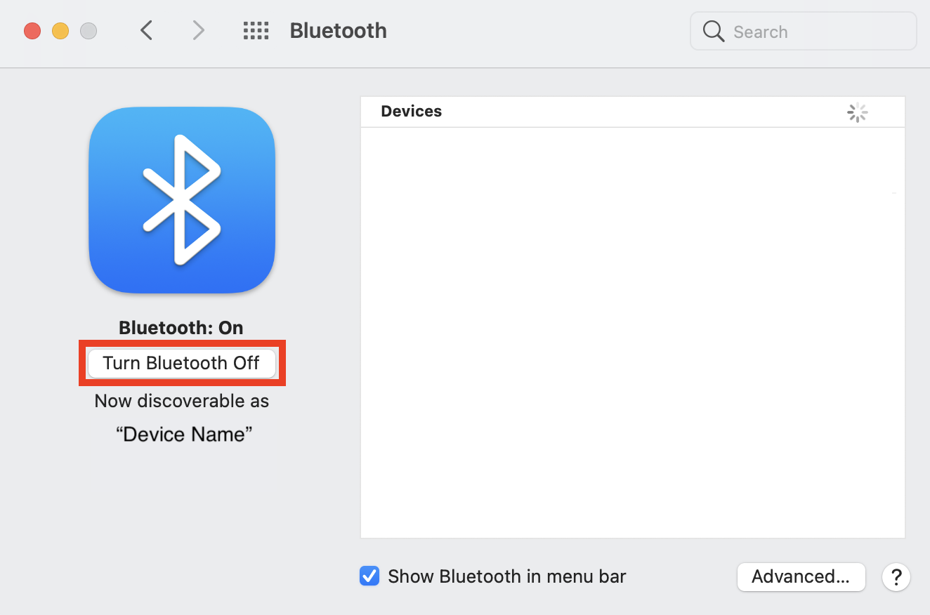

  • Turn Bluetooth off then back on.
    Image of an off button icon, representing the action to turn off a Bluetooth device, used in the context of troubleshooting Bluetooth connections.
    Navigate to the Bluetooth settings using the steps in the ‘Ensure Bluetooth is enabled’ section of this article. Select 'Turn Bluetooth Off'.
    On button graphic for troubleshooting Bluetooth connection, indicating the action to enable Bluetooth functionality.
    Then, select 'Turn Bluetooth On'. The status will display as 'On' and the discoverable name of the device will show.

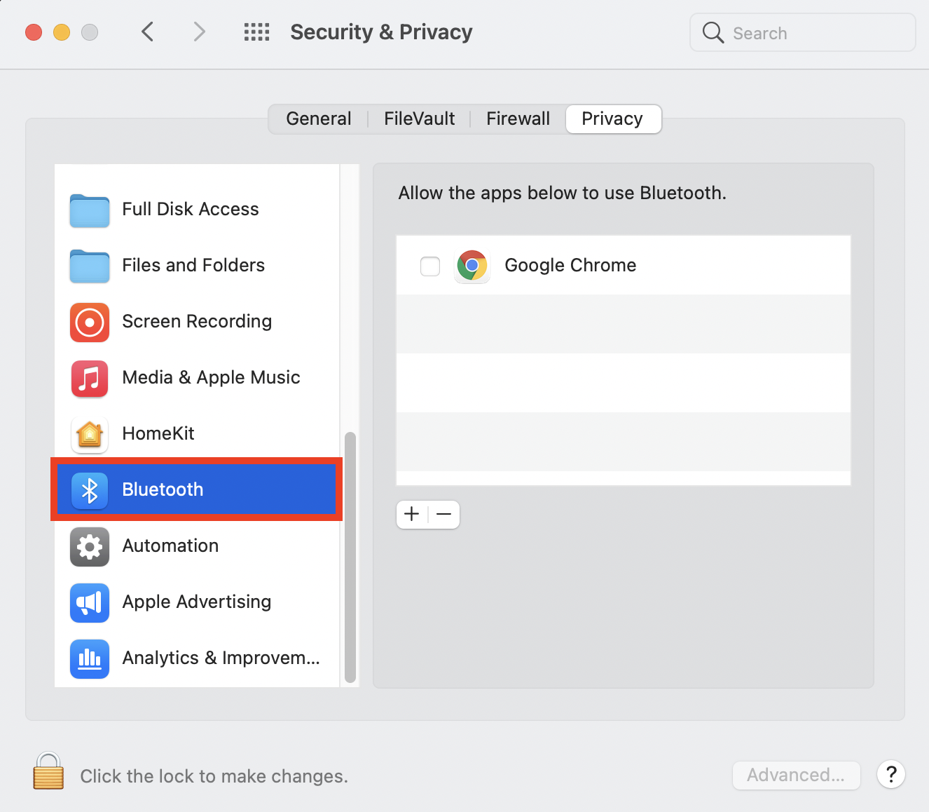

  • Check Bluetooth Permissions.
    Apple settings icon, used in the context of troubleshooting a Bluetooth connection in the general category description.
    Open 'System Preferences’.
    Diagram illustrating security and privacy considerations for troubleshooting Bluetooth connections, featuring key points and visual elements related to device security.
    Select 'Security & Privacy' from the list of icons.
    Diagram illustrating troubleshooting steps for Bluetooth connection issues, including device pairing, signal strength, and settings adjustments.
    Select 'Bluetooth’ from the list of options.
    Screenshot of Chrome's Bluetooth settings page, showing options for managing Bluetooth devices and connections, used for troubleshooting Bluetooth connection issues.
    Ensure the box next to Google Chrome is checked.
