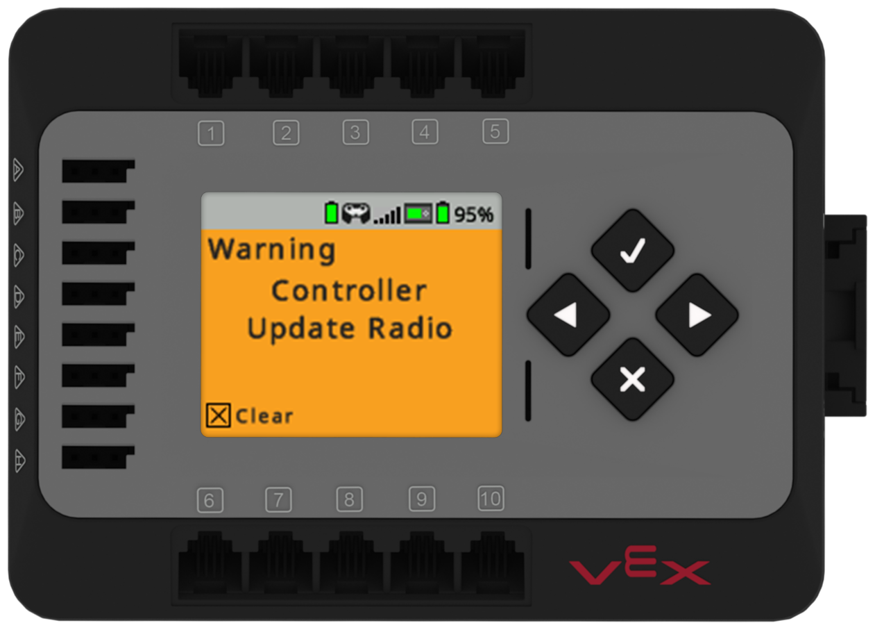

If your Controller and Brain are paired and the Controller firmware is out of date, this error message will appear on the Brain’s screen.

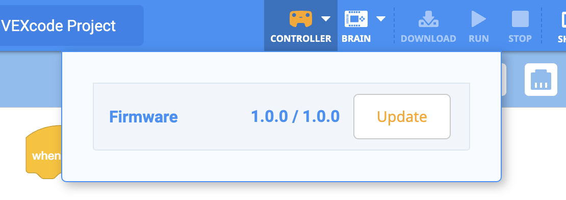

The Controller is connected to Web-based VEXcode EXP and the Controller icon in the Toolbar is orange.

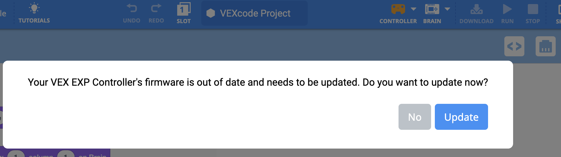

When a Controller is connected to VEXcode EXP via a USB-C cable, a prompt will appear asking “Do you want to update now?”

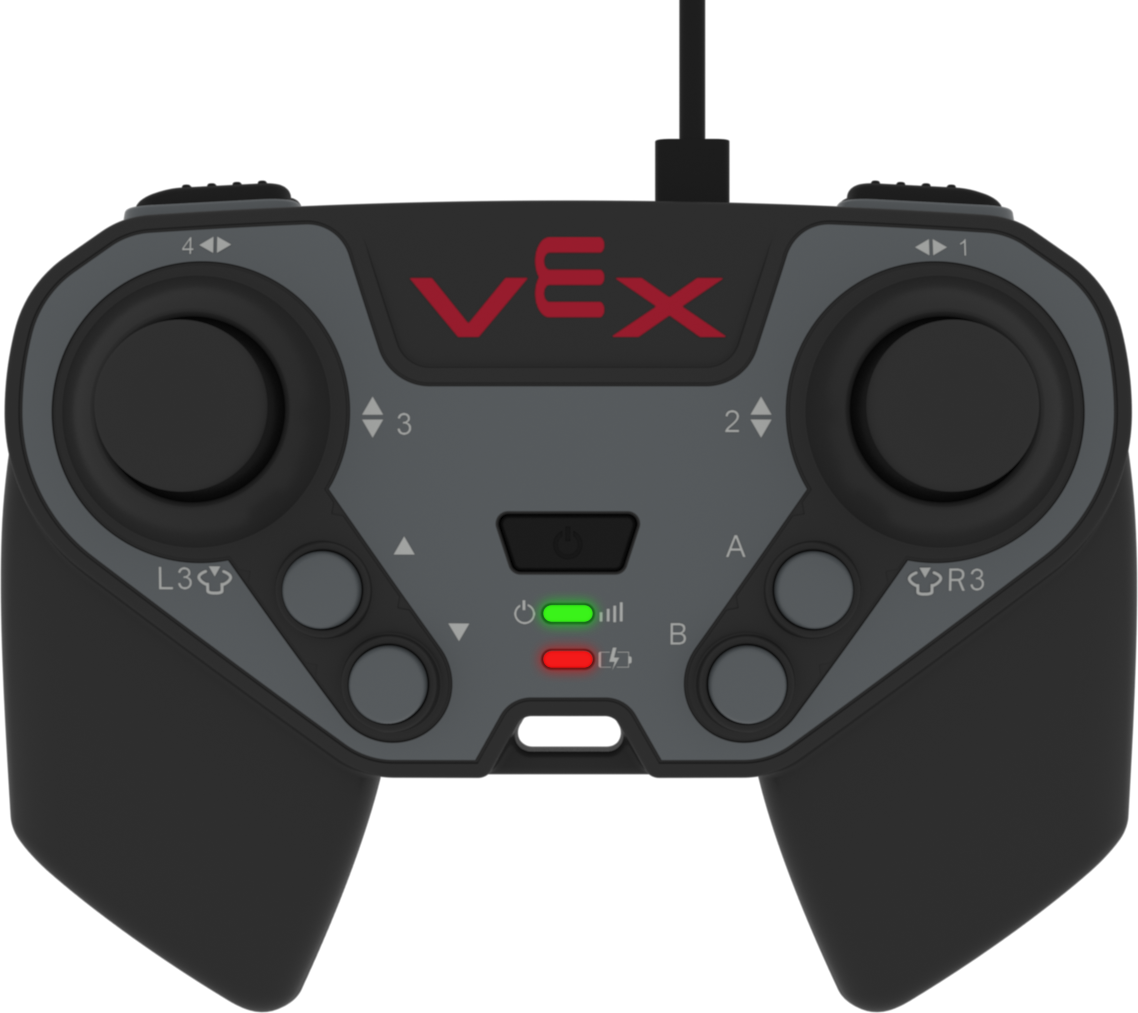

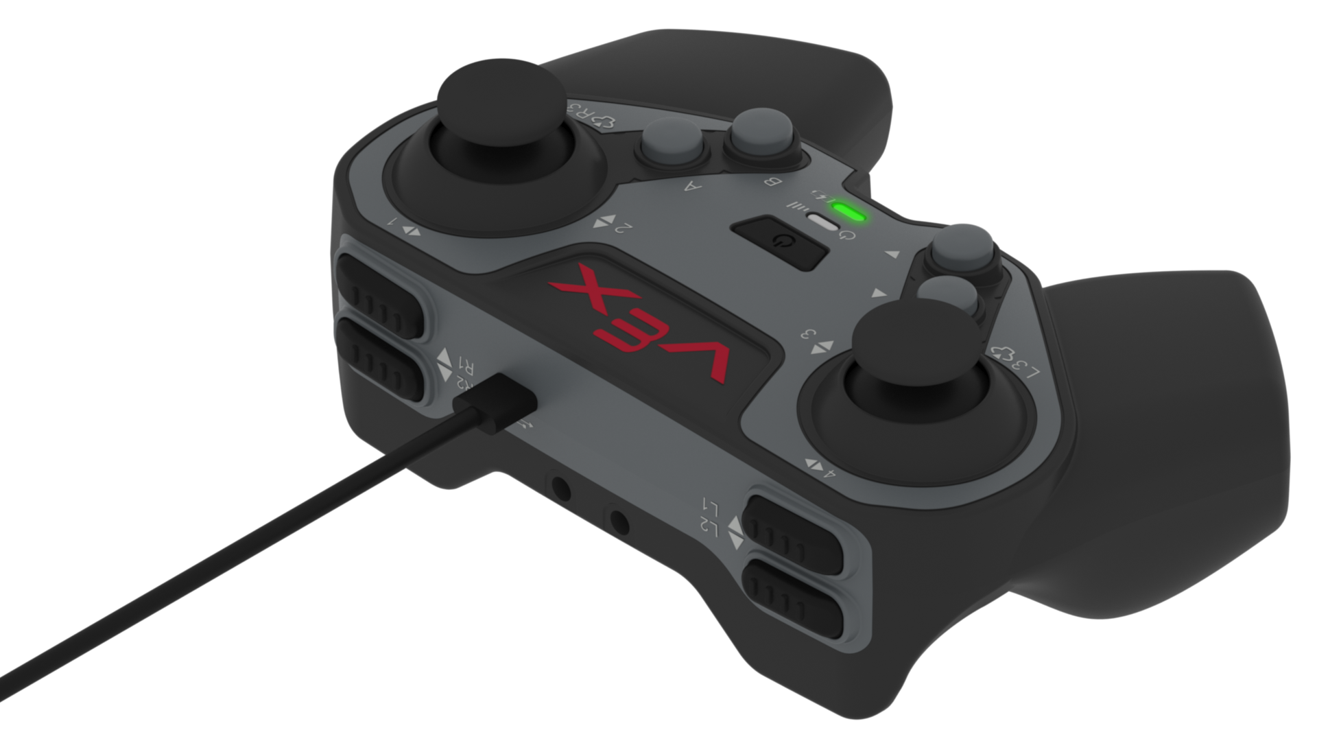

Using a USB-C cable, connect your Controller to your computer and ensure it is powered on. Once the Controller is connected, launch Web-based VEXcode EXP.
One the Controller is connected via USB-C and powered on, both indicator lights on the Controller will be visible.

The Controller icon in the Toolbar will turn orange, and a prompt will appear asking to update.
Select “Update.”

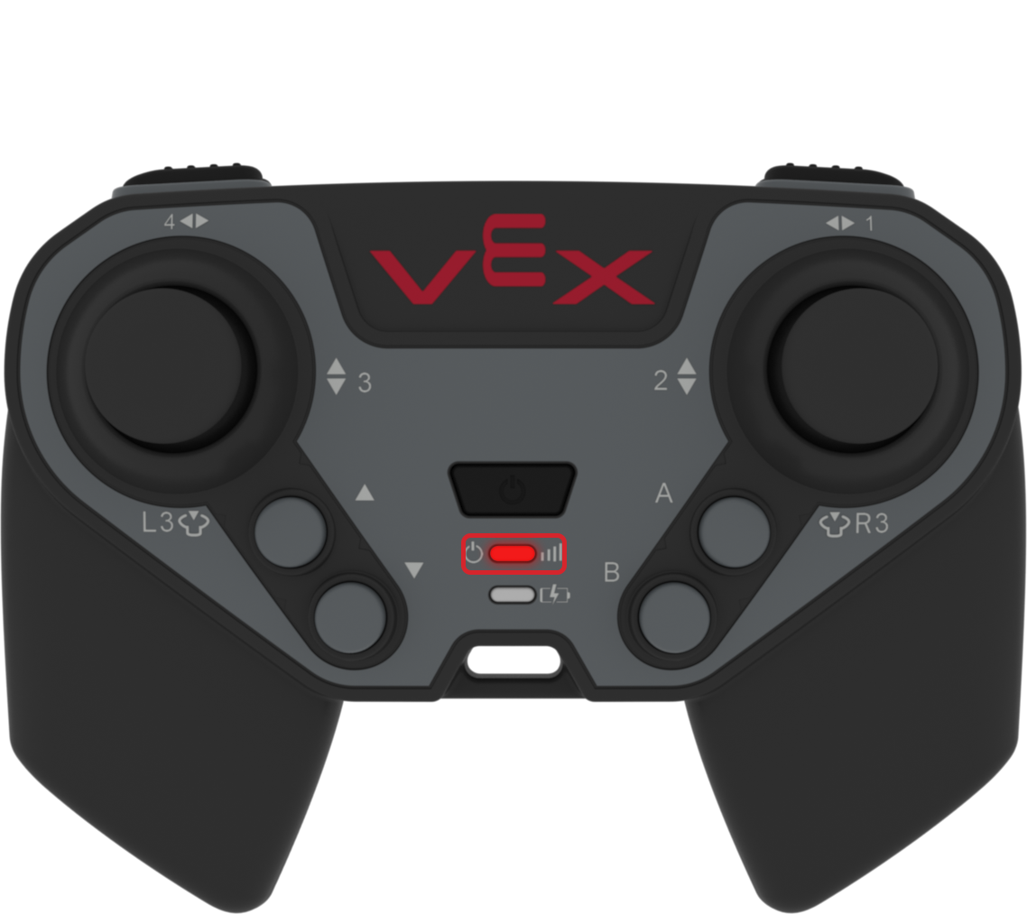

Once “Update” is selected, the Controller will start blinking red rapidly, and the following prompt will appear.
Select “OK.”

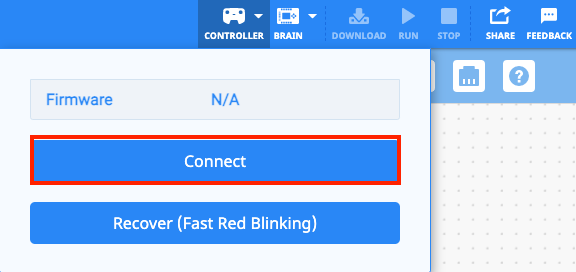

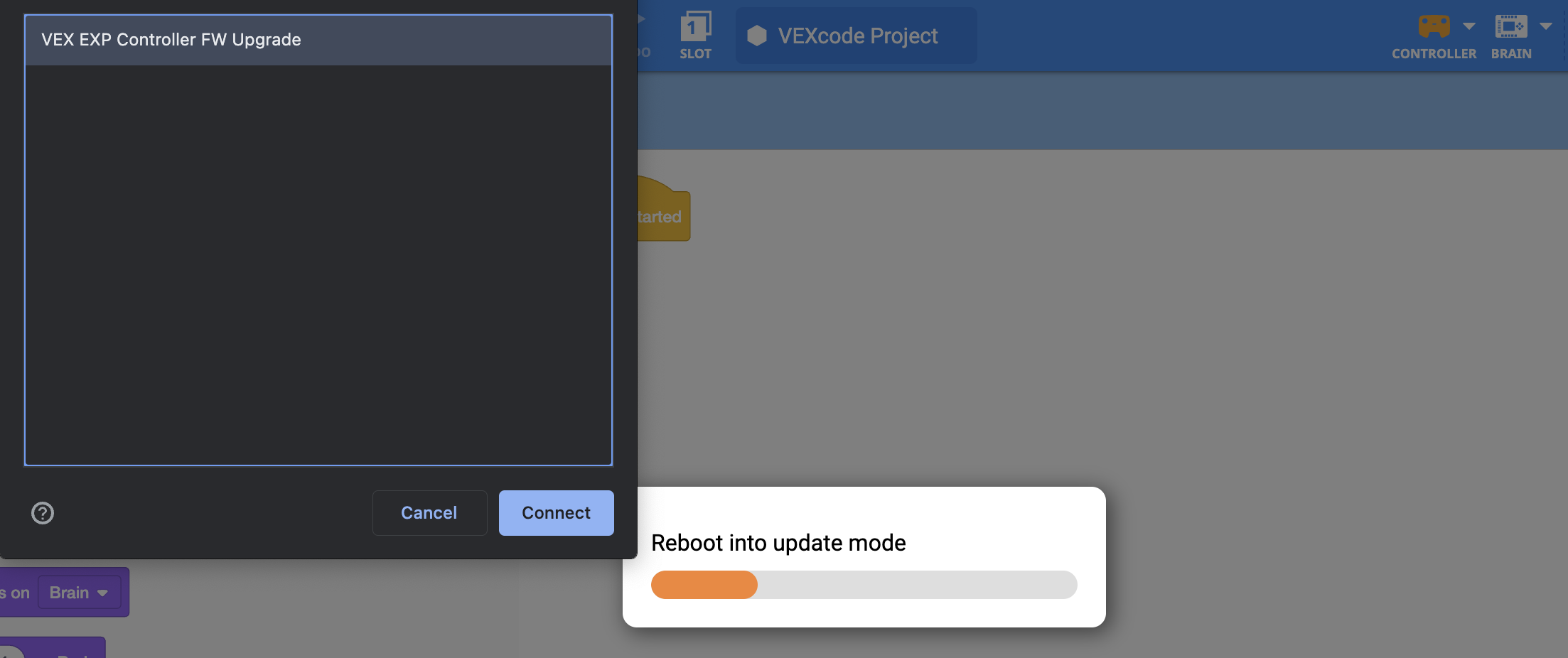

Select “VEX EXP Controller FW Upgrade” and then “Connect.”
The Controller will become disconnected and the following prompt will appear.

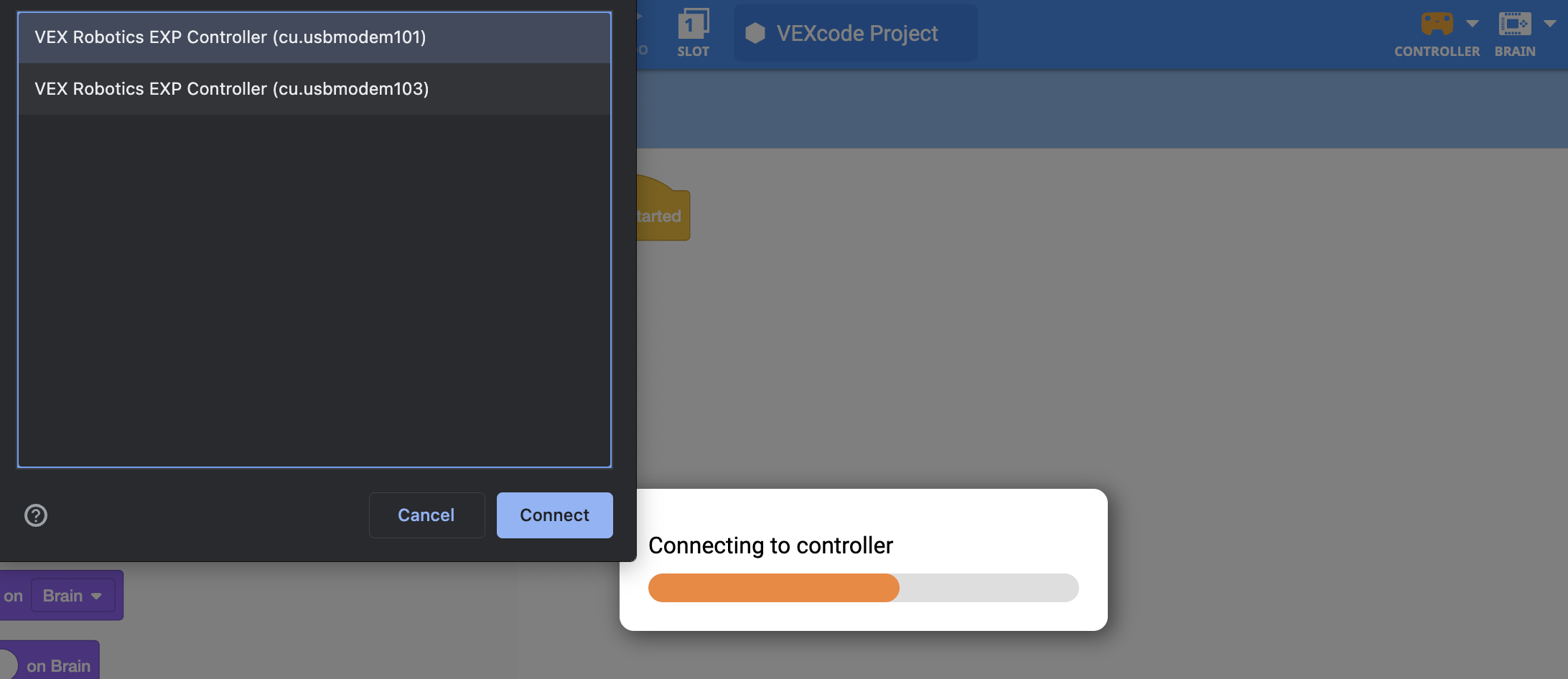

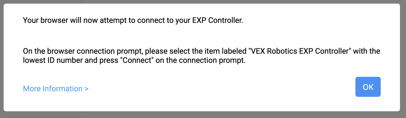

The Controller will then attempt to reconnect.
Select the EXP Controller with the lowest ID number from the list of Controllers available, and then “Connect.”
Please wait while the Controller updates.

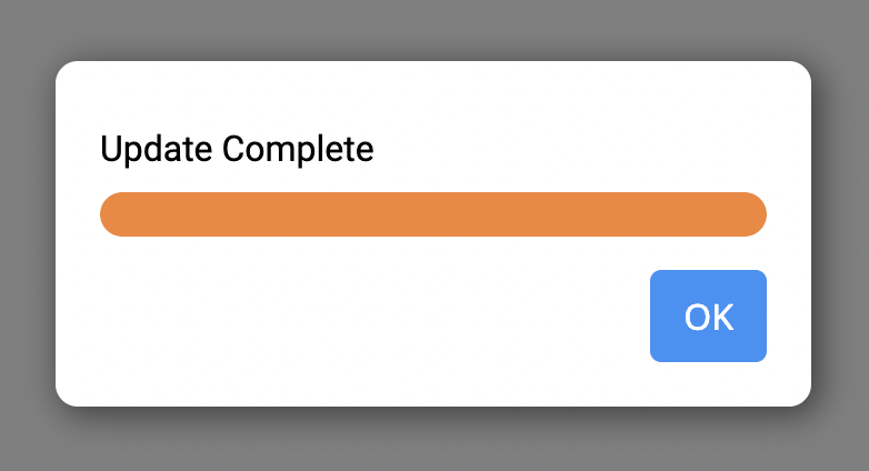

A prompt will appear when the update is complete.
Select “OK.”

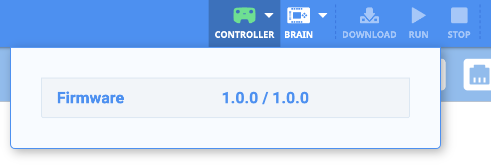

The Controller firmware is now updated and the Controller icon in the Toolbar will display green.
