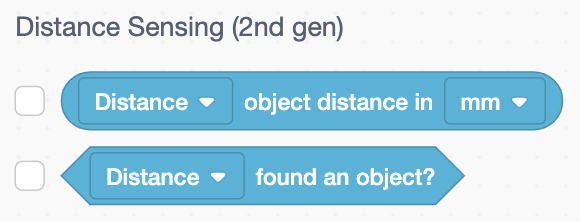

Distance Sensor (2nd gen)
The Distance Sensor reports if an object is close to the sensor, as well the approximate distance from the front of the sensor to an object, in millimeters or inches.
The Distance Sensor on the front Snapshot can be used to detect how far away from the fence the robot currently is.
