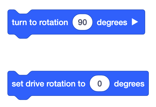

Rotation
Rotation is reported when the robot spins around the center axis of the Brain. The amount of degrees reported on the sensor dashboard indicates the direction of the turn and the degree value of the turns the Brain has completed since calibration. Unlike heading, the numeric values are not limited to the 0-359.99 degrees. The robot can rotate counter-clockwise for a negative value or clockwise for a positive value and will continue to increase the degree value to match the number of rotations the Inertial Sensor within the Brain reports.
In the sensor dashboard on the Brain's screen, rotation is the second value listed. If you rotate the Brain while on this screen, you will see the values update in real time.
This is set to 0 degrees when the Brain is turned on and the Inertial Sensor calibrates. If you want to reset the rotation of your robot, select the check button on the Brain. This will reset the heading and rotation to 0 degrees, and all data on the Inertial Sensor sensor dashboard will be based on this new starting location.
| VEXcode EXP Blocks | VEXcode EXP Python | |
drivetrain.turn_to_rotation(90, DEGREES) |
| VEXcode EXP C++ | ||
int main() |
In VEXcode EXP, the [Turn to rotation] block, turn_to_rotation Python command, and turnToRotation C++ command can be used to turn the robot for a specific number of degrees. |
drivetrain.set_rotation(0, DEGREES) |
int main() |
Similar to the calibrate option in the sensor dashboard, the rotation value can be set while the project is being run using the [Set drive rotation] block, set_rotationPython command, or setRotation C++ command. |
