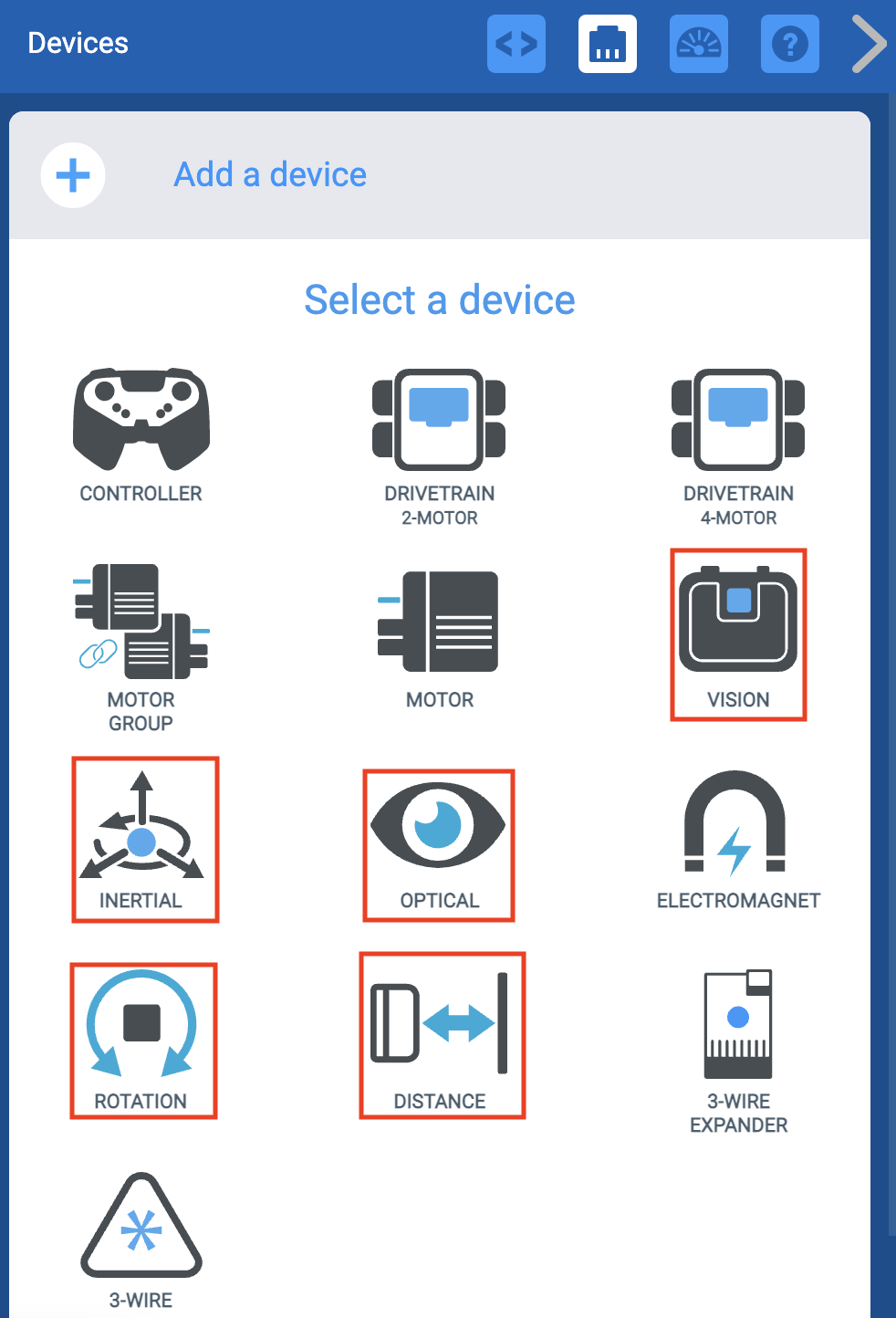

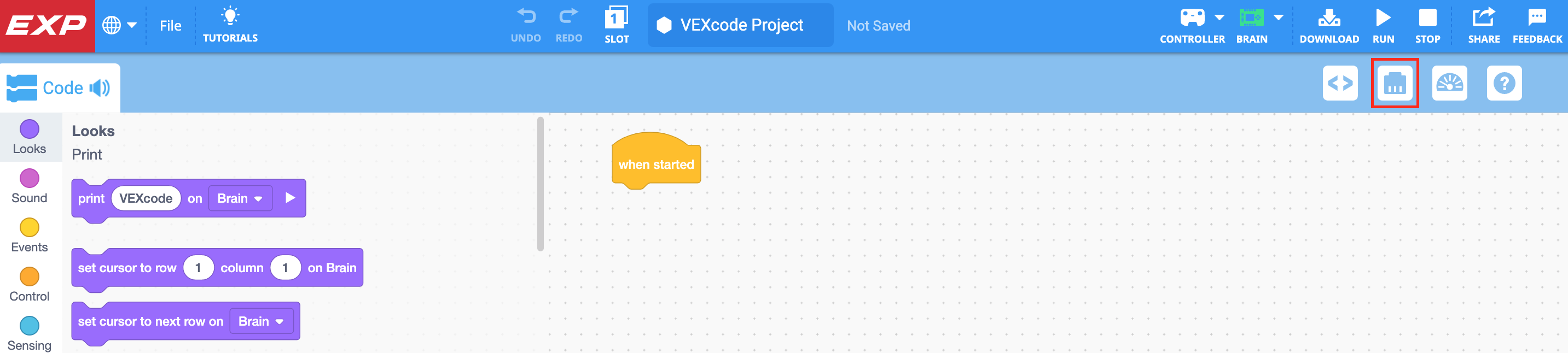

To configure a sensor, select the Devices icon to open the Devices window.
Select “Add a device.”
Select a sensor.
Note: Sensors include the Rotation Sensor, Distance Sensor, Vision Sensor, Optical Sensor, and Inertial Sensor. All sensors follow the same configuration process.

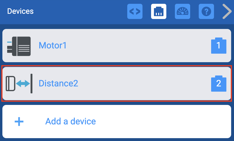

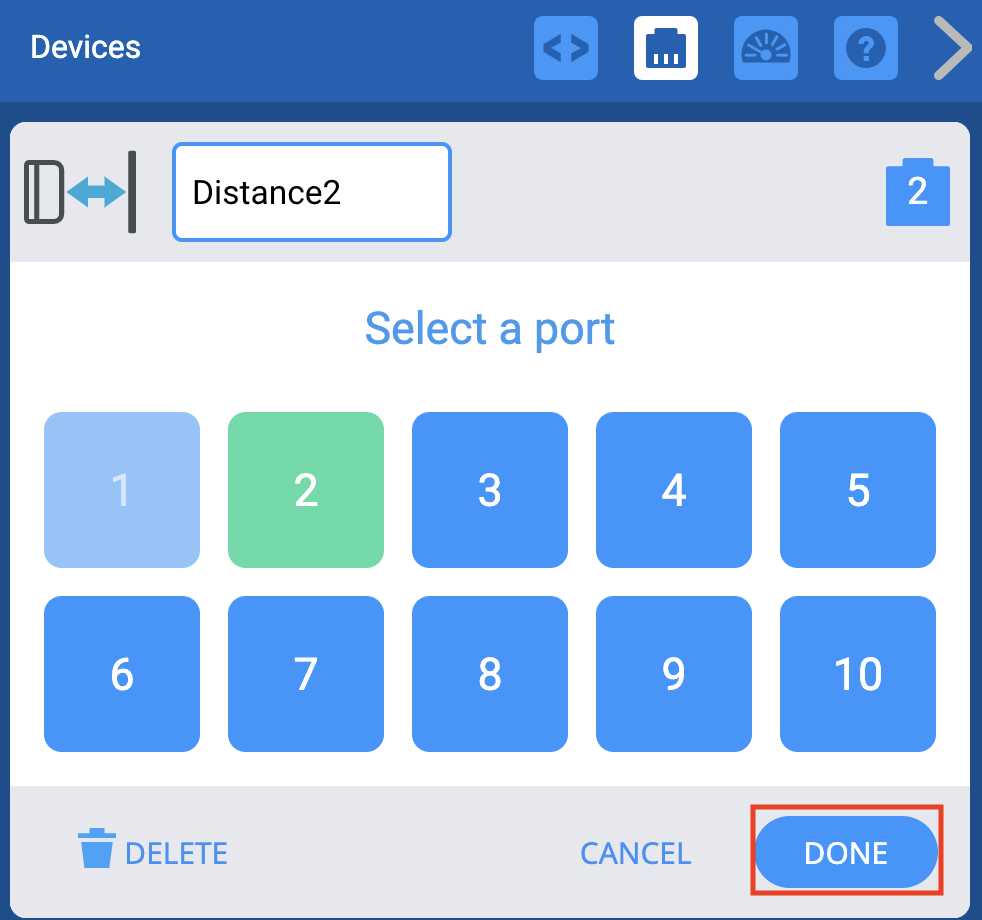

Select which port the sensor is attached to on the VEX EXP Brain. Ports that are already configured for other devices will be unavailable. Once the port has been selected, select “Done” to submit the device to the configuration or “Cancel” to return back to the Devices menu.
Note: Selecting “Cancel” will undo any changes you have made to the device and will not be a part of the configuration.

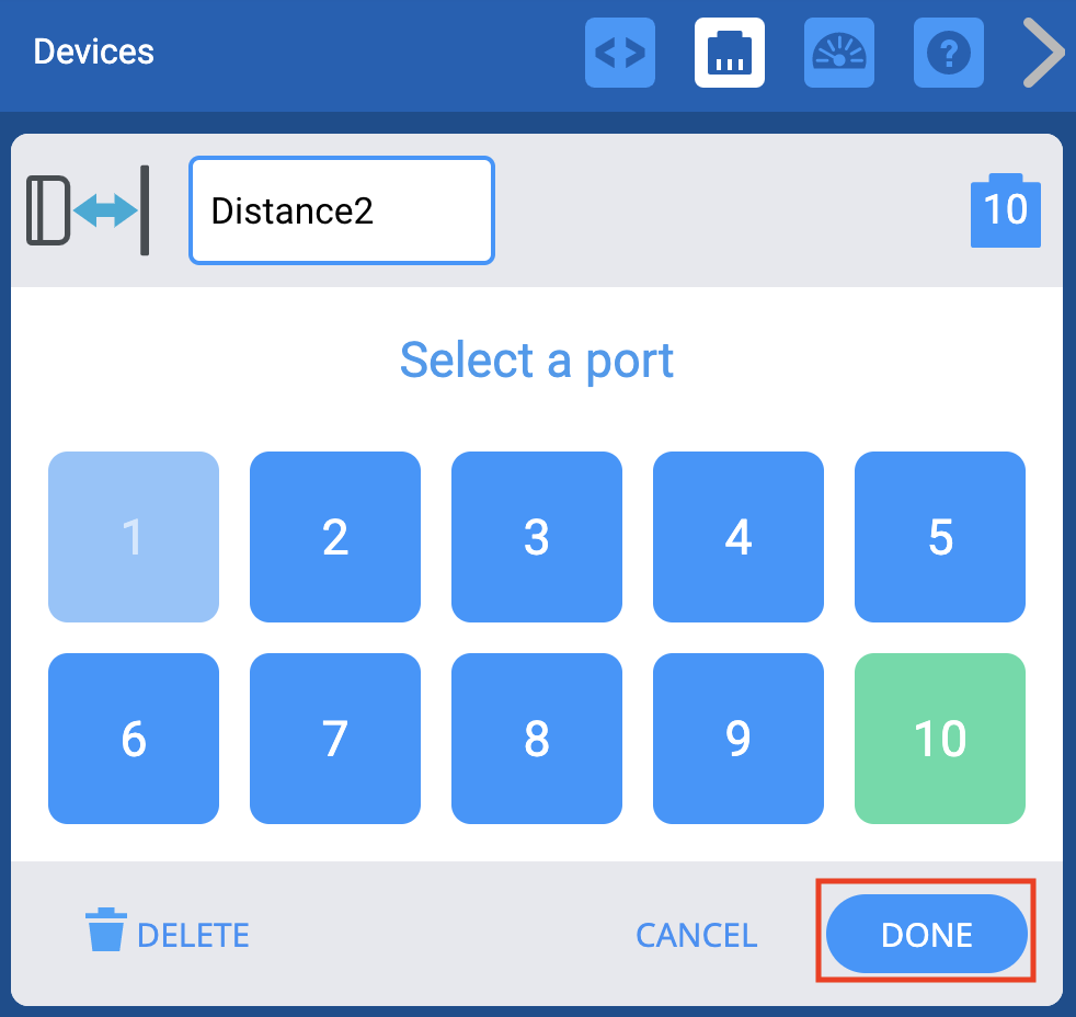

Changing a Sensor’s Port Number
You can change the port number for the Sensor by selecting on the Sensor in the Devices window.
Select a different port on the Port Selection screen and the port number will turn green. Then select Done to submit the change.

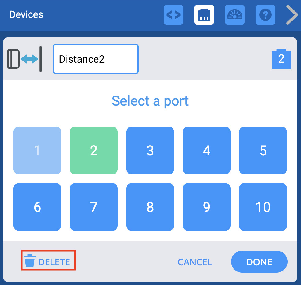

Deleting a Sensor
Sensors can also be deleted by selecting the “Delete” option at the bottom of the Port Selection screen.
Note: If you delete a sensor that is already being used in your project, your project will not work until you also delete the blocks that were using the deleted sensor.
