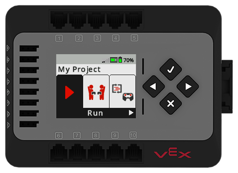

Finally, run your project. You can select Run from the Toolbar in VEXcode EXP, or using the buttons on the Brain. View this article to learn more about running a program from the Brain.
Your project will show in the Programs menu on the Brain screen.
