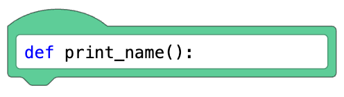

Hat blocksStart a stack of blocks and are shaped to attach blocks below them.define print name block.def print_name() in a hat switch block
