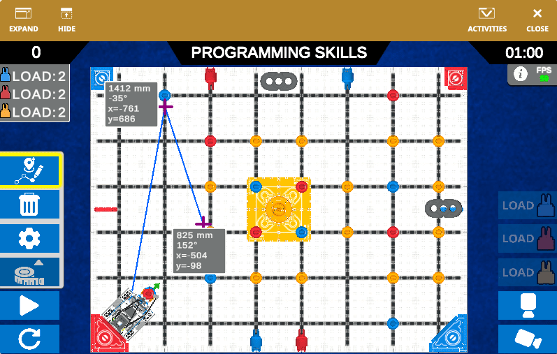

Waypoints are your target locations on the Playground that you want to navigate to. Waypoints are indicated with a plus (+) symbol on the Playground. You can use multiple waypoints to help you plan a path around the Playground. A waypoint can be added anywhere on the Playground to get data about its distance, angle, and x and y-coordinate location.

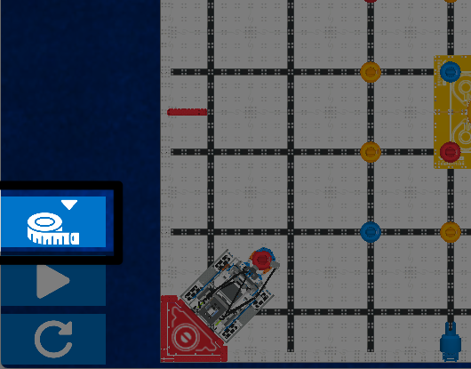

Select the Navigation Kit button to open the Navigation Kit.

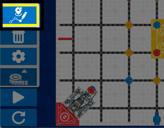

Select the Waypoint button to turn on the Navigation Kit. Once selected, the button will be outlined in yellow, indicating you are ready to add a waypoint to the Playground.

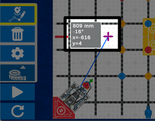

Waypoint marker with distance, heading, and x-y coordinates in the Playground

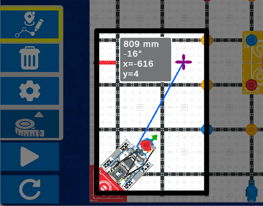

Select your desired location on the Playground to place a waypoint. Once selected, a + symbol will appear to show the waypoint, and navigation data about that point will appear in the box beside it.

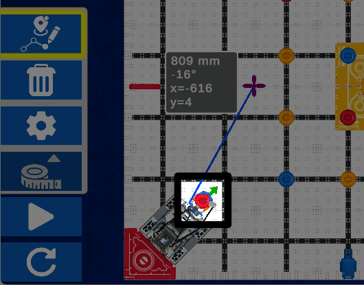

Robot heading and position relative to a waypoint in the Navigation Kit playground
A blue line also appears, showing the trajectory from the turning center point of the robot to the waypoint. You will learn more about the navigation data and trajectory later in this article.
Arrow indicates the robot’s forward direction from the claw.
A small green arrow extends from the front of the robot, indicating the robot's forward direction. This shows the trajectory the robot will move when it drives forward.

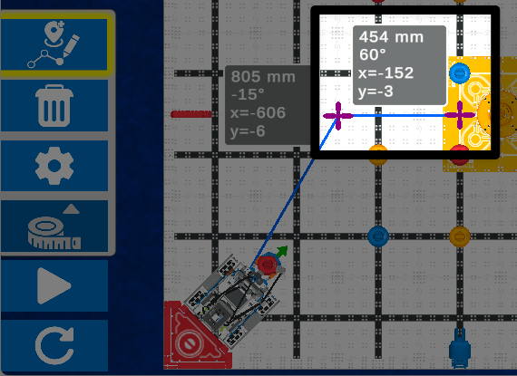

You can add additional waypoints to your path by selecting other locations on the Playground.
Second waypoint placed on the yellow goal area, showing the path and navigation values to reach it.
Select the next location you want to navigate to, and another + symbol will appear.

Select the desired waypoint and drag it to the new location. As the waypoint moves, you will notice the trajectory line and the navigation data change in real time, as shown in the video to the left.

Navigation Data
When a waypoint is placed, the navigation data provided can be used in a project to move the robot to that location.
By default, navigation data for the first waypoint is determined from the turning center point of the robot. For all waypoints added after the first, the trajectory line, distance, and angle navigation data will be relative to the previous waypoint.

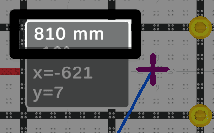

Distance
The distance in millimeters (mm) shows the distance from the turning center point of the robot to the waypoint. As the robot moves, the distance data will change accordingly.
Navigation data box displaying waypoint distance: 810 mm
The distance value is the first line of the navigation data box.
In the video to the left, the distance of 605mm from the navigation data is input as the parameter of the drive for block. When the project is started, the robot drives 605mm forward, as the trajectory line and distance data adjust. Once the center of the robot has reached the waypoint, the navigation data disappears.

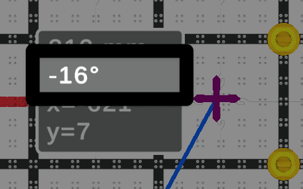

Angle
The angle in degrees shows the turn angle from the turning center point of the robot to the waypoint.
Navigation data showing the waypoint turn angle as -16 degrees
The angle value is the second line of the navigation data box.
A positive turn angle indicates a turn to the right, while a negative angle indicates a turn to the left.
In the video to the left, the angle of 45 degrees to the right from the navigation data are input as the parameters of the turn for block. When the project is started, the robot turns right 45 degrees, as the trajectory line and navigation data adjust.

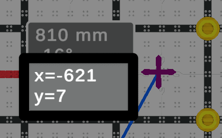

X and Y-Coordinates
The x and y-values in the navigation data show the x and y-coordinates of the waypoint on the Playground. The origin (0, 0) is the center of the Playground.
The x and y-coordinate data will not change as the robot moves, as the waypoint location is fixed within the coordinate system. To learn more about the coordinates of a VR Playground, view the VEXcode API Reference.
Navigation data showing waypoint coordinates X = -621, Y = 7
The x and y-coordinate values are the third and fourth lines, respectively, of the navigation data box.

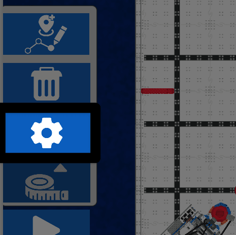

Settings option in the Navigation Kit menu for the Mix and Match Playground
Changing the Offset
Within the Navigation Kit, select the Settings button.
Use the Distance Offset in mm options to change the location where navigation data is generated from. The Distance Offset value will update based on your selection, as shown in this video.
You will see a graphical representation of the position on the right side, to help you position the offset to your desired location on the robot.
Select Confirm to save your settings.

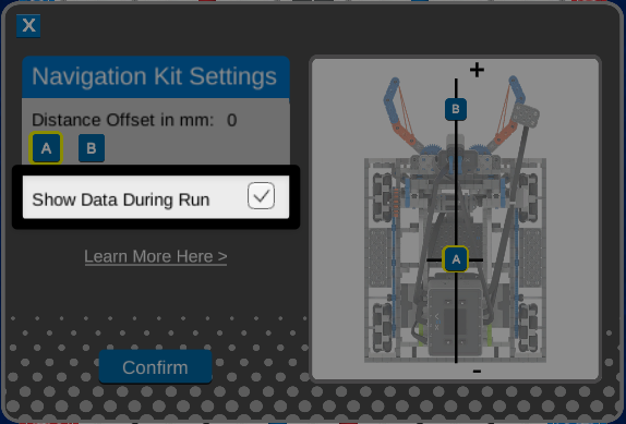

Navigation Kit settings with Show Data During Run enabled and Confirm selected
Showing Navigation Data
By default, navigation data is shown when a project is running, so that both the waypoints and navigation data boxes appear on the Field. To hide navigation data, and only show waypoints during a run, uncheck the box.
