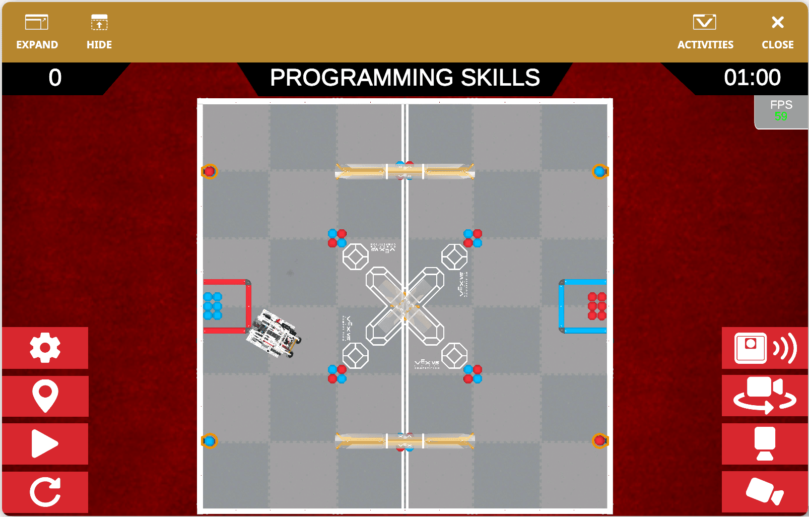

The V5RC 25-26 Push Back Playground is a virtual representation of the Field for the VEX V5 Robotics Competition (V5RC) Push Back (2025-2026) Competition game. The Playground Window is a space for the Hero Bot, Dex, to interact and move to play V5RC Push Back Virtual Skills.
Top-down view of Dex in the Push Back Playground window on the virtual competition field

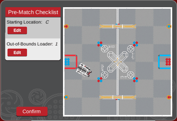

Pre-Match Checklist with Starting Location C selected for the Push Back Playground Window
The Pre-Match Checklist enables you to edit the starting location of Dex on the Field, as well as set the Loader to which Match Load Balls will be added.
Location button above the Start button in the Playground window
Select the Location icon button to open the Pre-Match Checklist.
The Pre-Match Checklist also appears upon opening the Playground window for the first time.
Changing the Starting Location
The default starting location for Dex is location C. To change the starting location, select the Edit button. Then select your desired starting location, A, B, C, or D. You will see the robot change position as locations are selected, as shown in the video to the left.
Select Confirm to save your changes, and close the Pre-Match Checklist.

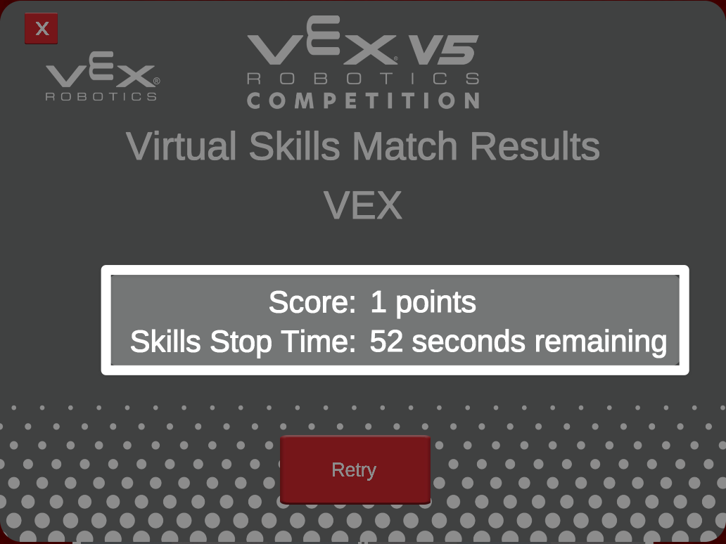

Using the Match Results Window

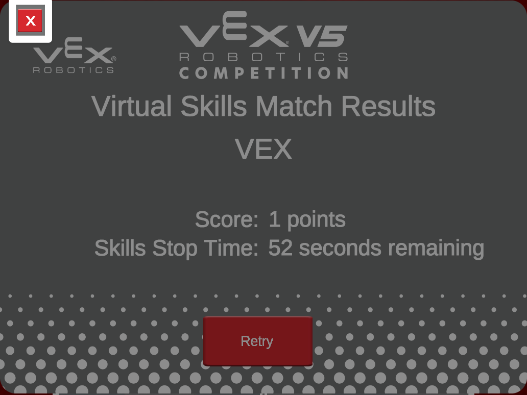

When a project is stopped, or the timer hits 0 seconds, the Match Results window will appear.
virtual skills match results with score and skills stop time highlighted.
The total score for the project will be shown, along with the time remaining when the project was stopped.

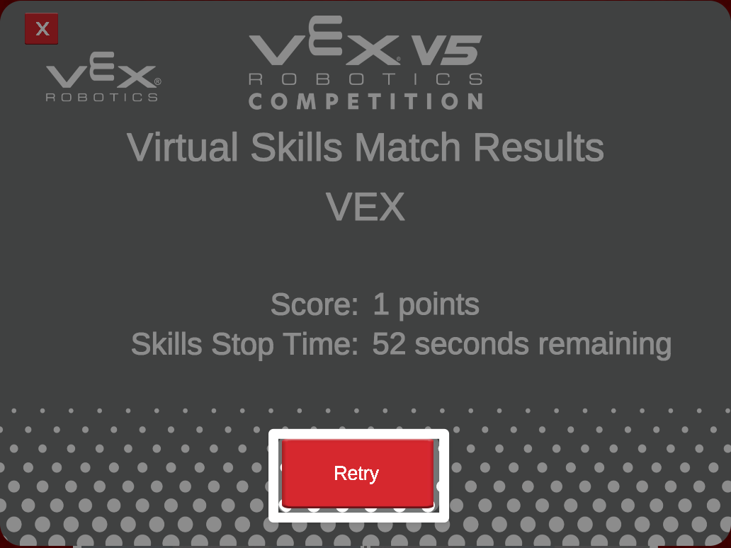

Virtual skills match result with retry button highlighted.
Select the Retry button to return to the Field and reset the timer and score.
Virtual skills match result with an X highlighted on the top left.
Select the X in the top-left corner to close the Score Window and return to the Field.
This will not reset the Field, timer, or score. It will return to the Field exactly as it was at the moment the project was stopped.

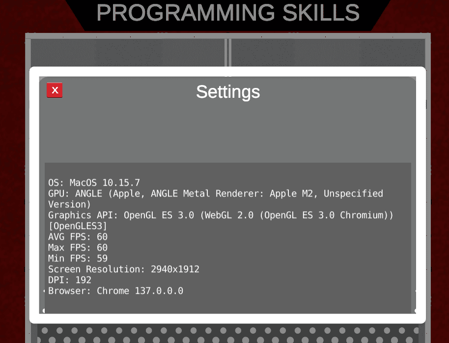

Select the Info icon to open the Graphics and Performance Summary window.
Graphics and Performance Summary showing system performance details for the Push Back Playground window.
Data about your device will be displayed in the Graphics and Performance Summary window. This can be used to help troubleshoot any performance issues.
Select the X button in the upper left corner to close the window and return to the Playground.
