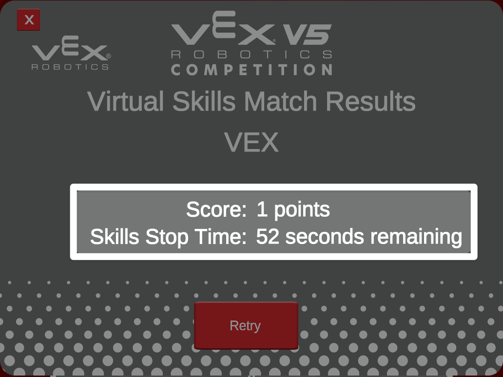

When a project is stopped, or the timer hits 0 seconds, the Match Results window will appear.
Match Results window with score and Skills stop time both set to 0.
The total score for the project will be shown, along with the time remaining when the project was stopped.

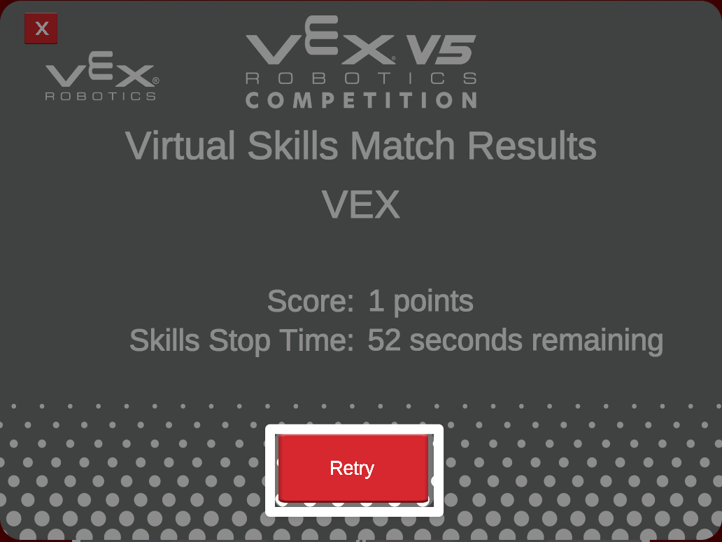

Retry button resets the Push Back Playground match and score timer
Select the Retry button to return to the Field and reset the timer and score.

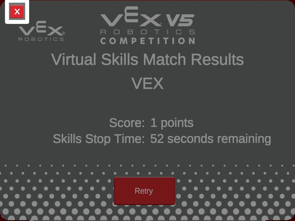

Close button for exiting the Push Back Playground window
Select the X in the top-left corner to close the Score Window and return to the Field.
This will not reset the Field, timer, or score. It will return to the Field exactly as it was at the moment the project was stopped.
