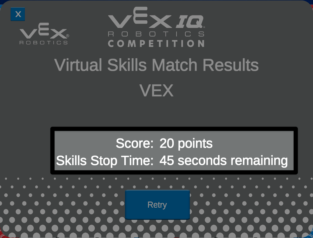

When a project is stopped, or the timer hits 0 seconds, the Match Results window will appear.
Playground match results showing 2 points at the end of the match.
The total score for the project will be shown along with the time remaining when the project was stopped.

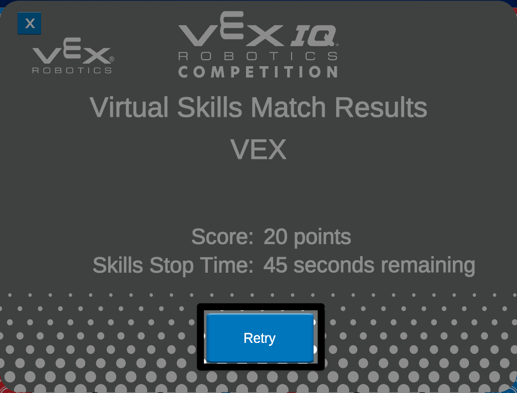

Match results window with Retry selected to start a new match
Select the Retry button to return to the Field and reset the timer and score.

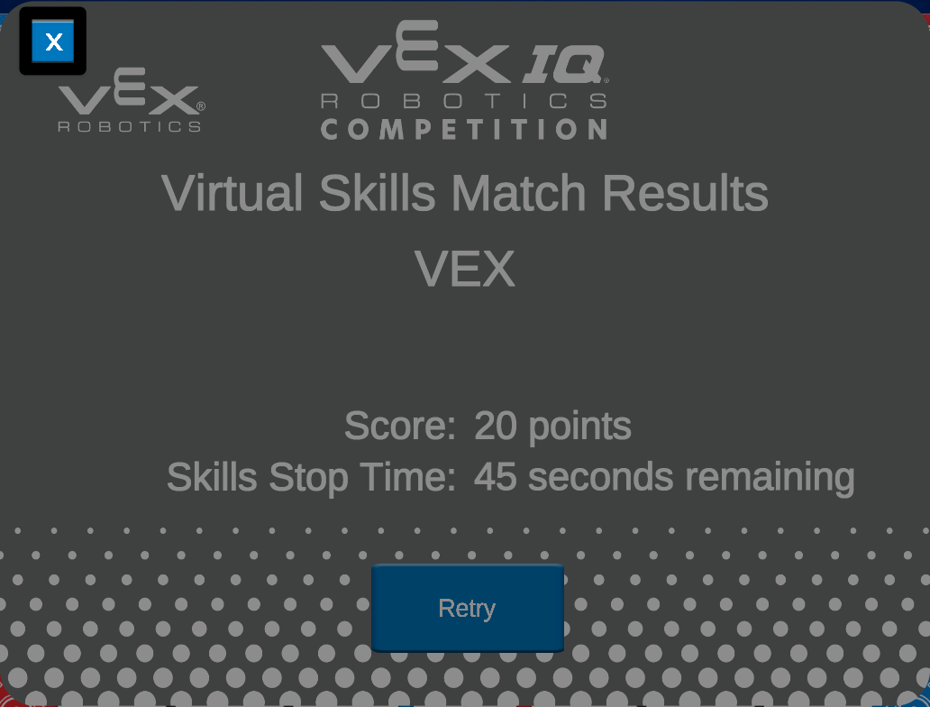

Close Match Results window
Select the X in the top-left corner to close the Score Window and return to the Field.
This will not reset the Field, timer, or score. It will return to the Field exactly as it was at the moment the project was stopped.
