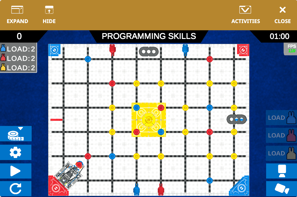

Using the VIQRC Mix & Match Playground Window
The VIQRC 25-26 Mix & Match Playground is a virtual representation of the Field for the VIQRC Mix & Match (2025-2026) Competition game. The Playground Window is a space for the Hero Bot, Huey, to interact and move to play VIQRC Mix & Match Virtual Skills.
VIQRC Mix and Match Playground window upon opening, that reads Programming Skills at the top with a top down view of the Hero Bot on the bottom left corner of the Field.
How to Start, Stop, and Reset a Project
The start button in the form of a white arrow located in in the bottom left of the Playground window. It is the second button up from the bottom.
Select the Start button to start a project.
This button will change to a Stop button when a project is actively running.
The stop button in the form of a white octagon located in in the bottom left of the Playground window. It is the second button up from the bottom.
Selecting the Stop button will stop the project and the timer immediately.
The Score Window will appear at this time. See below for more information on the Score Window.
The reset button in the form of a curved white arrow located in in the bottom left of the Playground window. It is the bottom button in a stack of three.
Select the Reset button to reset the timer, point value, and Field.
Viewing Your Score and the Timer
The score feature to the upper left of the Field, reading 0 and called out with a white box.
Your score can be seen above the Field on the left side. This will be updated in real-time while the project is running.
The timer feature to the upper right of the Field reading 01:00 and called out with a white box.
The timer is located above the Field on the right side.
The timer begins when a project is started and counts down from 1:00. The timer will count down until Stop is selected, the Stop project block is used in the project, or the timer reaches 0 seconds.

Selecting Different Camera Views
A close-up screenshot of the buttons in the lower right corner of the Playground Window with the top camera button, showing a white camera icon pointing downward, highlighted above the chase camera button.
Select the Top Camera button to see an overhead view of the entire Field. This is the default view when you open the Playground Window.
A close-up screenshot of the buttons in the lower right corner of the Playground Window with the chase camera button, showing a white camera icon angled downward to the right, highlighted below the top camera button.
Select the Chase Camera button to see a behind-the-robot view.

Loading Pins
Three load buttons with a pin and the word 'load' are highlighted. From bottom to top, the buttons are yellow Pin, red Pin, blue Pin.
When the project is running, the Load Buttons will become available. Select the Button matching the Pin color you want to load.
A yellow pin in the Load Zone
The Pin will appear in the Load Zone on the left side of the field.
Image of the pin count in the upper left of the field reading blue load 2, red load 2, yellow load 1.
You can see the current number of Pins available to load at any point during the match in the upper left of the Playground window.

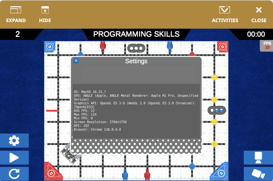

Viewing Additional Information
A close-up screenshot of the upper right corner of the Playground window, with the i icon highlighted, below the timer.
Select the Info icon to open the Graphics and Performance Summary window.
A close-up screenshot of the Graphics and Performance Summary window, showing information about the computer running VEXcode VR. In the upper left corner is an X button to close the window.
Data about your device will be displayed in the Graphics and Performance Summary window. This can be used to help troubleshoot any performance issues.
Select the X in the upper left corner to close the window and return to the Playground.
