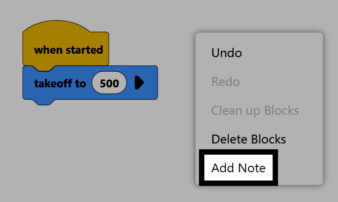

Adding a Note to a Project
A screenshot of the VEXcode AIR workspace with the Context Menu open and the Add Note option highlighted at the bottom below Undo and Delete Blocks.
Add a note to the Workspace by right-clicking to open the context menu. Then select Add Note.

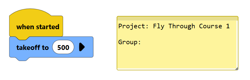

A screenshot of the VEXcode AIR workspace with a started project on the left and a note reading project: Unit 1 Lesson 2 with space to add a group to the right.
Then, type any text, numbers, or symbols into the note.
  • Use the Return or Enter key on your keyboard to write a multi-line note.
  • Select anywhere in the Workspace when the note is complete.
