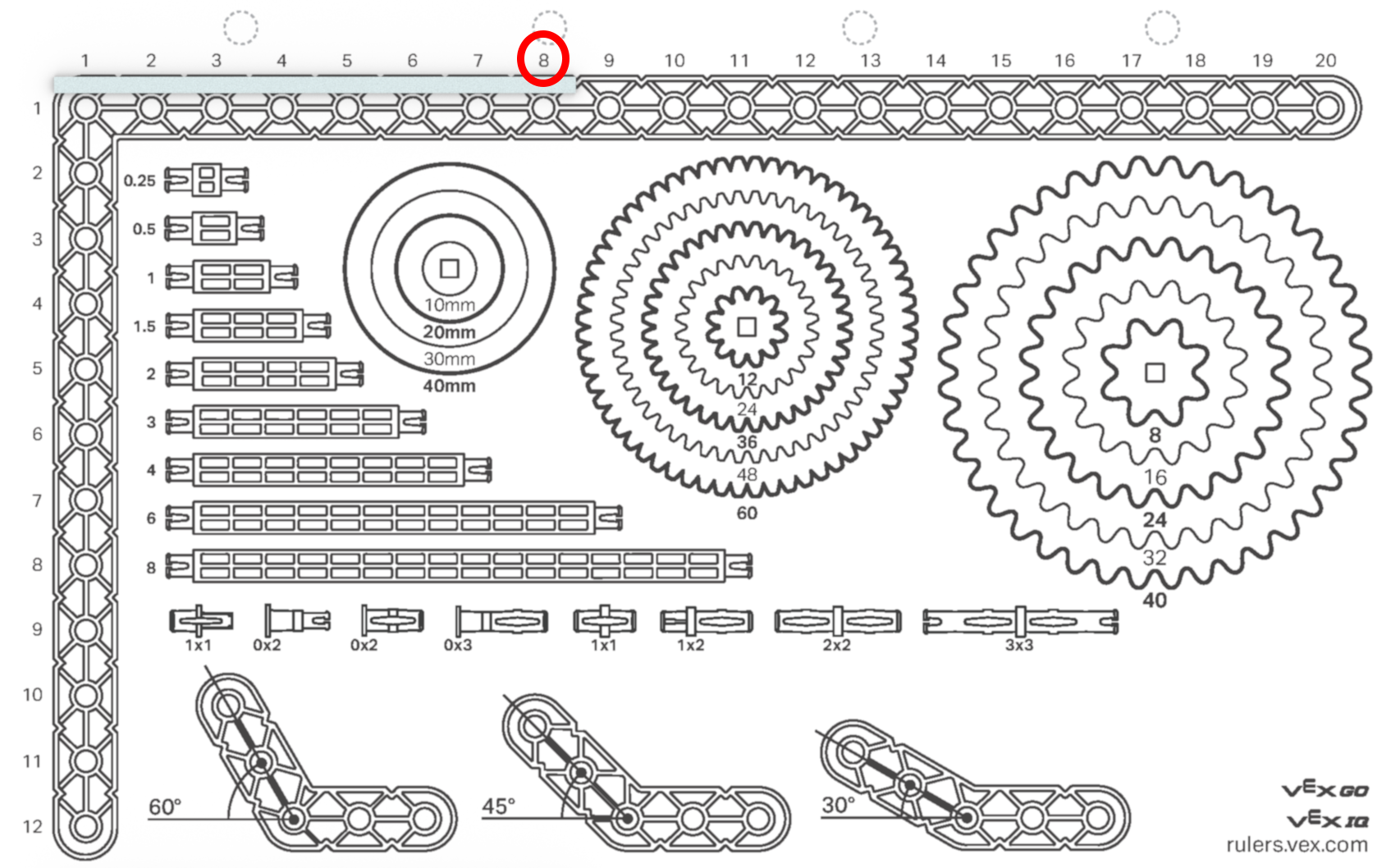

The VEX IQ Parts Ruler can be used to identify parts while organizing parts or following a set of build instructions. The scale on the ruler is 1:1, so parts can simply be placed on top of the ruler.
Measuring Beams and Plates. Example shown is a 2x7 Beam.
  • 2 indicates a width of 2 pitch units.
  • 7 indicates a length of 7 pitch units.
Measuring Standoffs. Example shown is a 4x Standoff.
Measuring Pulleys. Example shown is a 30mm Pulley.
Measuring Gears. Example shown is a 12 Tooth Gear.
Measuring Sprockets. Example shown is a 16 Tooth Sprocket.
Measuring Pins. Example shown is a 1x1 Pin.
Measure Specialty Beams. Example shown is a 30° Angle Beam.
