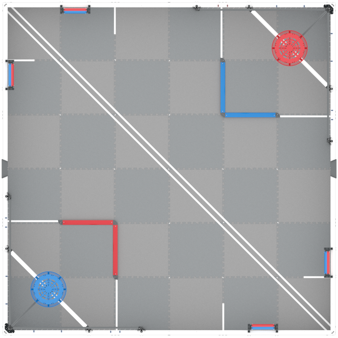

Understanding the V5RC Spin Up Field
The Field in the V5RC Spin Up Playground in VEXcode VR  has the same dimensions and setup as the Field for an in-person Skills Match in the 2022-2023 V5RC Spin Up Competition game. This information can be useful when creating projects in V5RC Spin Up for VEXcode VR.

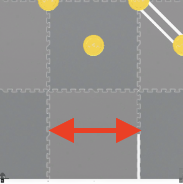

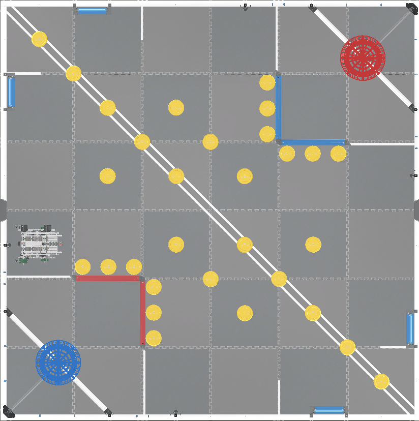

Each tile on the Field is 600mm by 600mm (~24 inches by 24 inches).
Screenshot of VEXcode VR interface showcasing block-based coding options for programming a virtual robot, designed for educational purposes in STEM, specifically within the context of VRC Spin Up (2022-2023) competition.

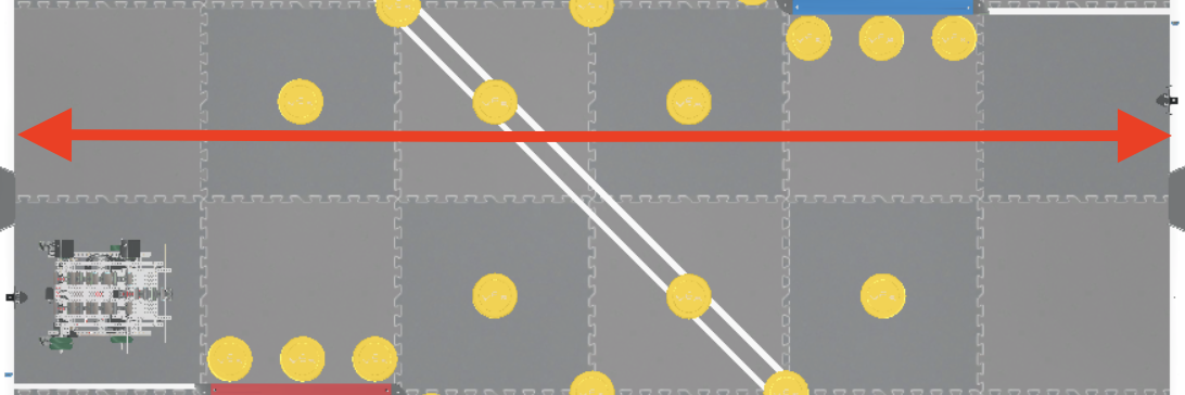

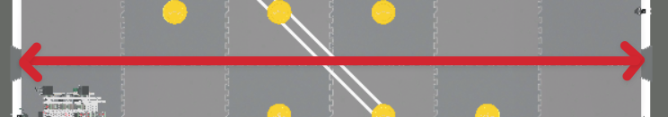

The Field is six full tiles long.
In total, the Field is 3.65m (~12 feet) long.
Screenshot of VEXcode VR interface showcasing the block-based coding environment used for programming a virtual robot, highlighting features for beginners and advanced users in the context of VRC Spin Up (2022-2023).

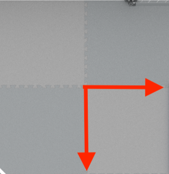

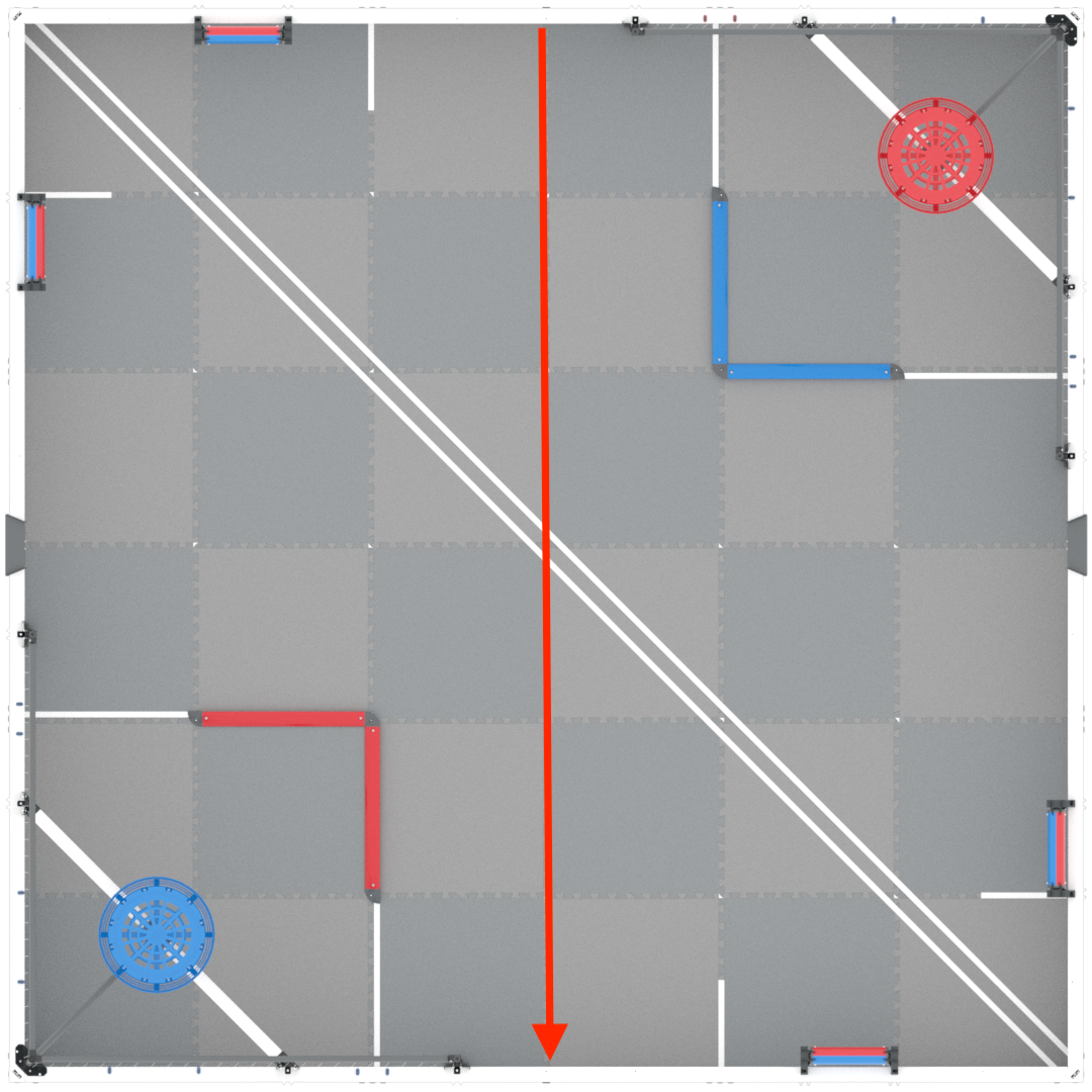

The Field is six full tiles wide.
In total, the Field is 3.65m (~12 feet) wide.

Each full tile measurement begins and ends at the edge of the tile.
Screenshot of VEXcode VR interface showcasing the coding environment for VRC Spin Up (2022-2023), featuring block-based and text-based coding options designed for teaching coding concepts through virtual robotics.
The total Field measurements begin and end at the inner edge of the Field perimeter.

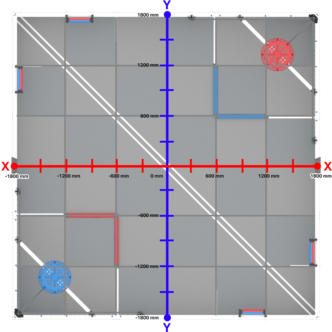

In V5RC Spin Up in VEXcode VR, the virtual Hero Bot Disco is equipped with a GPS Sensor that reports its location and angle. The GPS Sensor reports the (X, Y) coordinates of the center of rotation of the robot on the Field, in millimeters or inches. This can be used to code Disco to drive to specific locations, and navigate the V5RC Spin Up Field in VEXcode VR using sensor feedback instead of set distances.
Screenshot of VEXcode VR interface showing block-based coding options for programming a virtual robot, designed for educational use in coding concepts and robotics principles, relevant to the VRC Spin Up (2022-2023) competition.
The Field in V5RC Spin Up in VEXcode VR ranges from approximately -1800mm to 1800mm for the X and Y positions.
The center location, or the origin (0,0), is located in the center of the Field.
Screenshot of VEXcode VR interface showcasing block-based coding options and a virtual robot, designed to facilitate coding education for students and educators in the VRC Spin Up (2022-2023) program.
