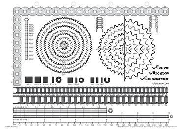

The VEX Metal Parts Ruler is a handy tool to help identify parts.
Note: when printing the .pdf be sure to set to 100% scale.
Using the Ruler to Identify Parts
The VEX Metal Parts Ruler can be used to identify parts while organizing parts or following a set of build instructions. The scale on the ruler is 1:1, so parts can simply be placed on top of the ruler.

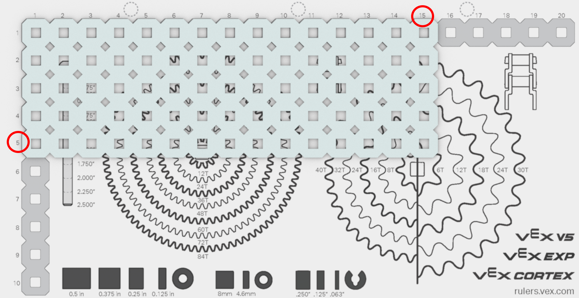

Image of a 5x15 plate used in VEX robotics education, featuring measurement markings and a grid design for precise alignment and construction in robotics projects.
Measuring Structural Metal. Example shown is a 5x15 Plate.
  • 5 indicates a width of 5 pitch units.
  • 15 indicates a length of 15 pitch units.

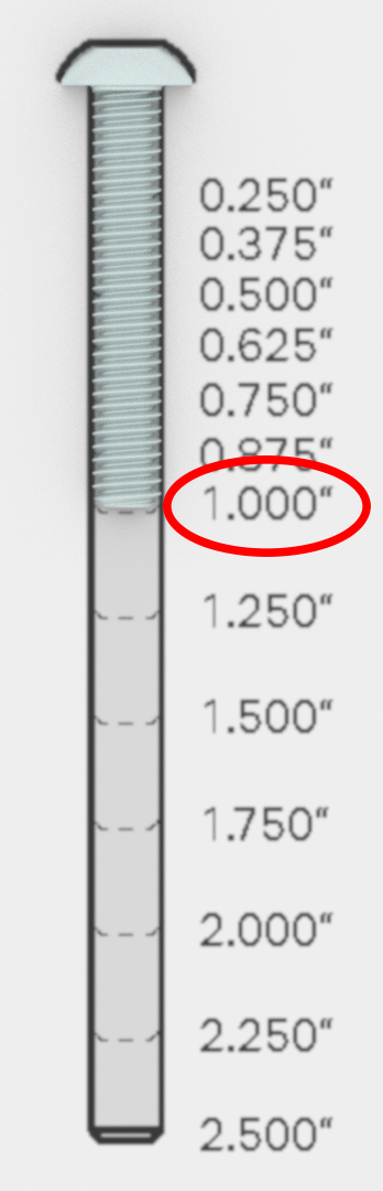

Image of a VEX 8-32 screw, used in educational robotics and engineering projects, displayed on a ruler for scale.
Measuring Screws. Example shown is a #8-32 1.0 inch Star Screw.

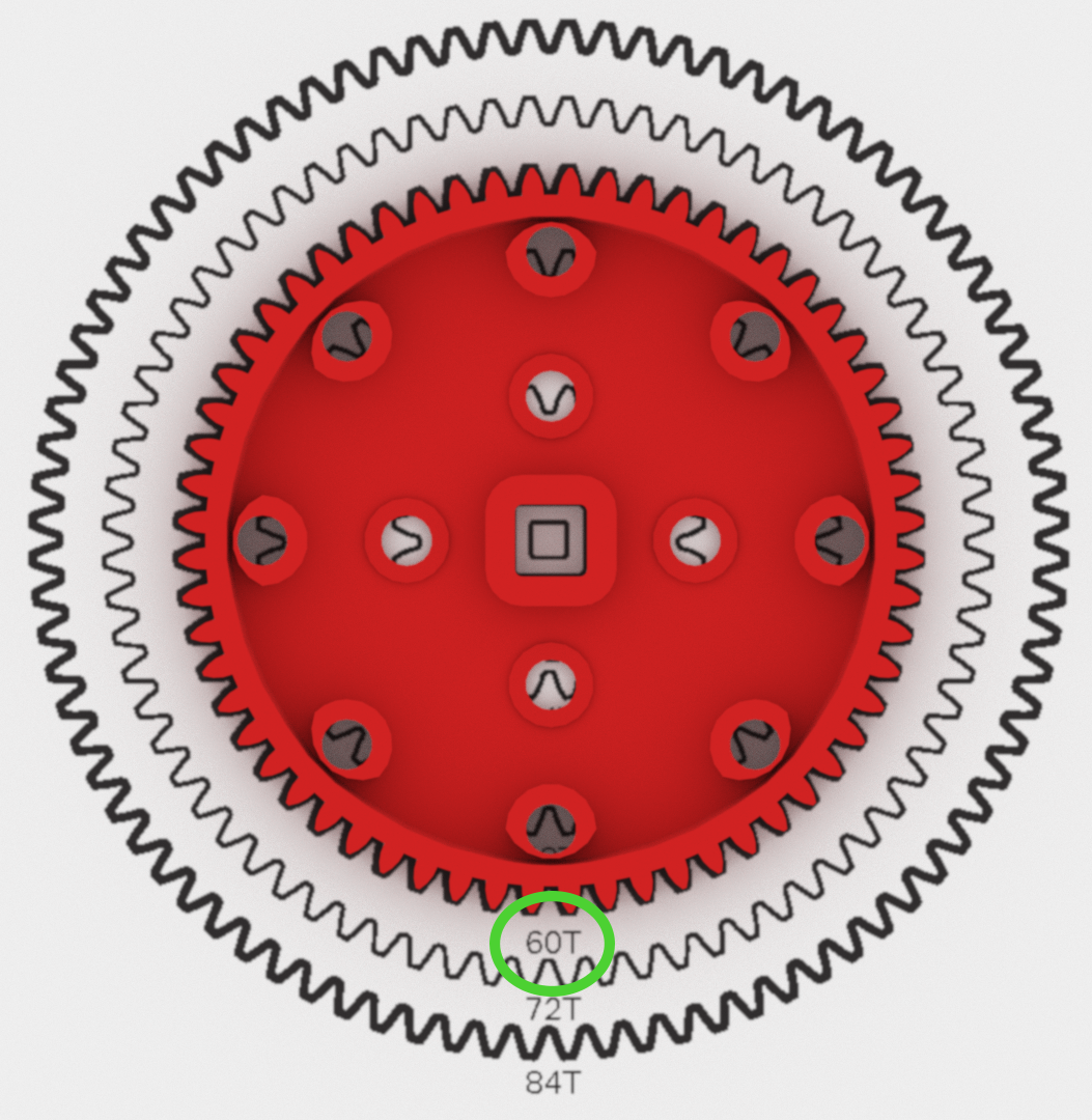

Image of a 60-tooth gear used in VEX robotics education, showcasing its design and features for educational purposes.
Measuring Gears. Example shown is a 60 Tooth Gear.

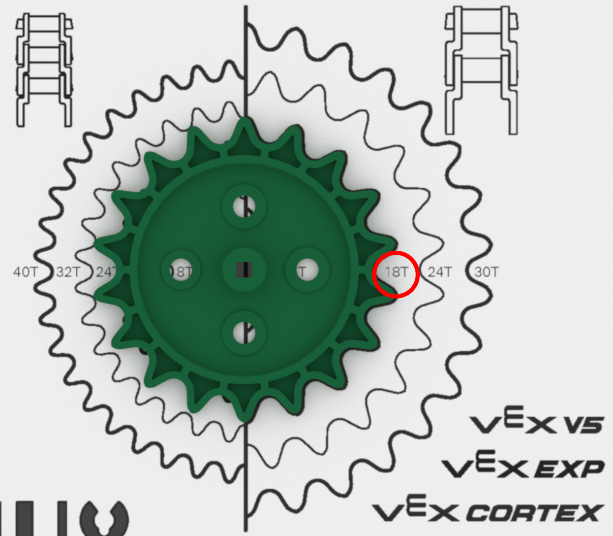

VEX 18T Sprocket image, showcasing a detailed view of the sprocket design used in robotics education, relevant to VEX Rulers section.
Measuring Sprockets. Example shown is a 18 Tooth Sprocket.

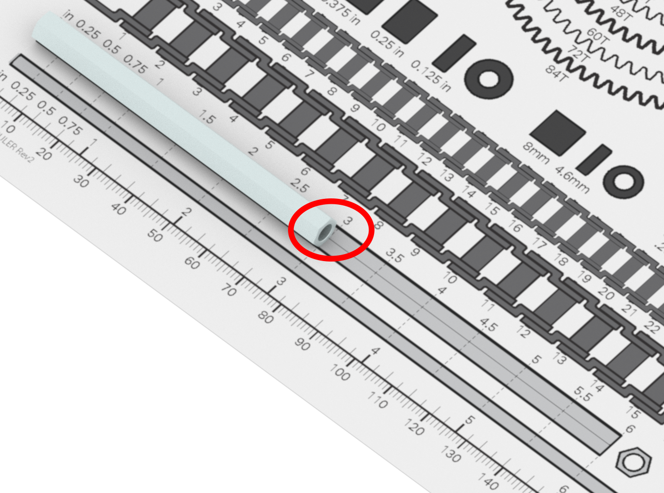

3-inch shaft component from VEX Robotics, used for educational purposes in robotics projects, displayed against a plain background.
Measure Shafts. Example shown is a 3 inch Shaft.

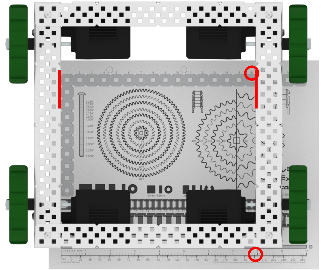

Diagram of VEX chassis components, illustrating the assembly and layout of parts for educational purposes in robotics.
Measuring the distance between C-Channels on a robot chassis. This example shows the C-Channels on the robot chassis measuring 16 pitch or 8 inches.

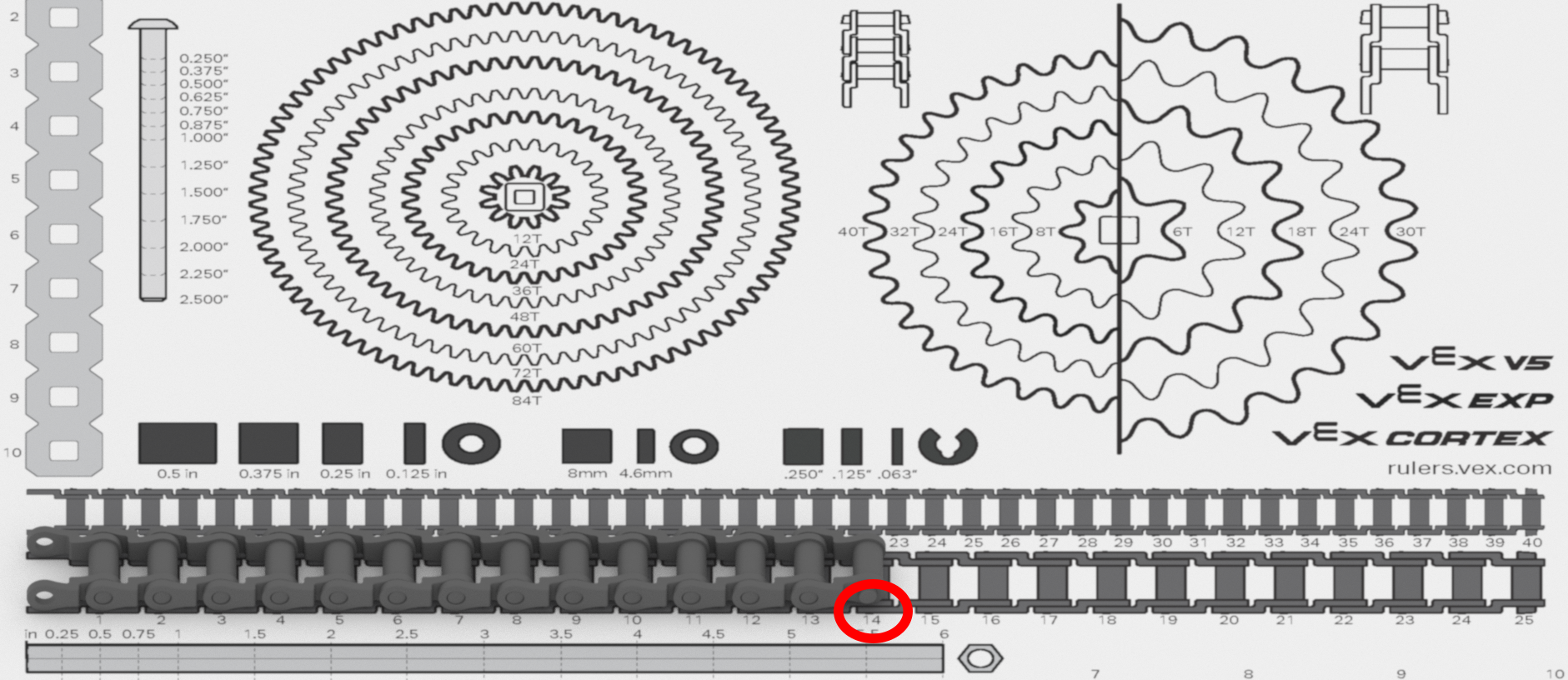

A detailed image of a VEX chain, showcasing its structure and design, used in educational robotics applications. The chain is displayed against a neutral background, highlighting its features for better understanding in the context of VEX Rulers.
Measuring the number of chain links in a chain/sprocket system.
Note that there are two different sized chains on the ruler, this is because there are two different sized sprockets.
The top chain on the ruler is for 6P Sprockets and the bottom chain is for High Strength Sprockets.
  • 6P Sprockets - Chain is 6.35mm / 0.25"
  • High Strength Sprockets - Chain is 9.79mm / 0.385"
