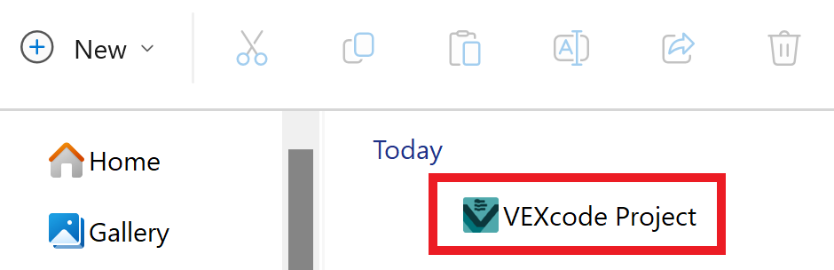

Previously saved VEXcode GO project is visible from the device's files and is highlighted.
Use the device’s interface to navigate and open your existing project.

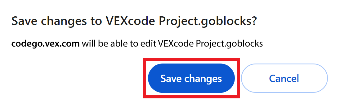

VEXcode GO prompt after opening a project that reads Save changes to VEXcode Project.goblocks? codego.vex.com will be able to edit VEXcode Project.goblocks.
A prompt will appear in your browser. Select Save Changes to open the project and allow auto saving.
VEXcode GO with a previously saved Blocks project successfully opened.
Your project will then open.
