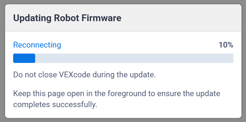

When using an iPad or Android device, VEX GO will automatically update when the Brain is connected to VEXcode GO.
A Brain that is updating will blink green and red while it is updating. It will return to solid green once the update is complete.
Note: the update length has been shortened for the animation. An actual firmware update may take up to 2 minutes.

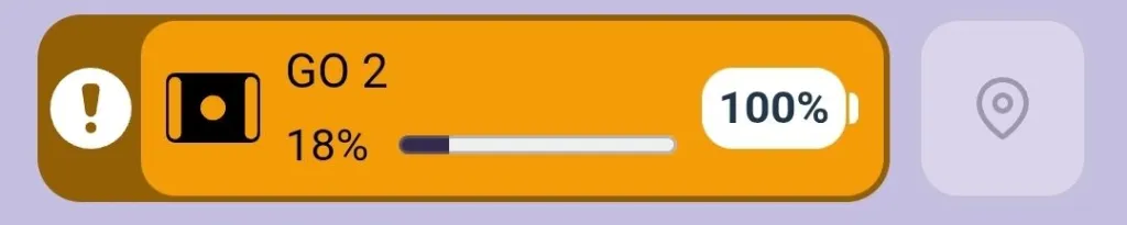

A progress bar will appear to show the progress of the update. Note that all other options will remain unavailable until the update has finished.

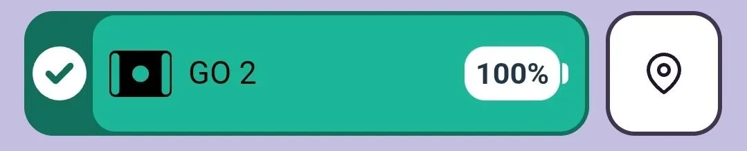

Once the update is complete, the Brain name and icon will now show green in the app. Note that the ‘Update’ option is unavailable since the Brain is now up to date.
The button on top of the GO Brain will remain a solid green once the update is complete.

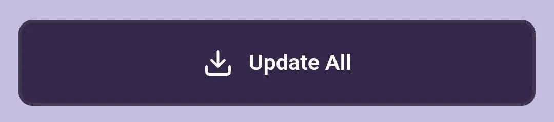

To update the firmware on multiple GO Brains at once, select ‘Update All Devices.’
Progress bars will appear to show the progress of each Brain’s update as well as the overall update for all Brains. Note that the ‘Update All Devices’ option changes to ‘Updating All’ until the updates have finished.
Note that one Brain will update at a time.
