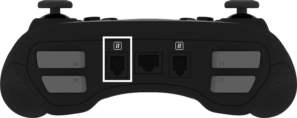

The top of the V5 controller showing one of the smart ports being highlighted.
Plug the Ethernet cord from the Field Control System into the V5 Controller.
Do not connect to the center port, only to one of the smart ports on the top of the controller.
