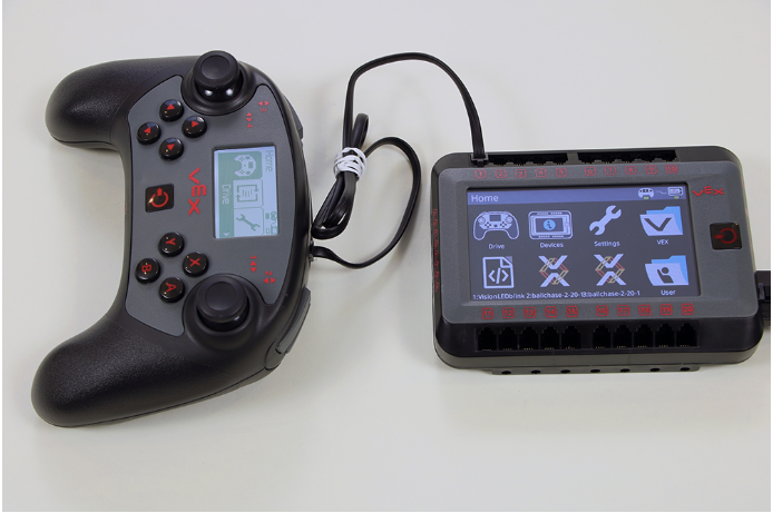

Wirelessly connect the V5 Controller to the Brain or connect them via a Smart Cable. The Controller must be connected to the Brain either wirelessly or via Smart Cable throughout the entire wireless download process.

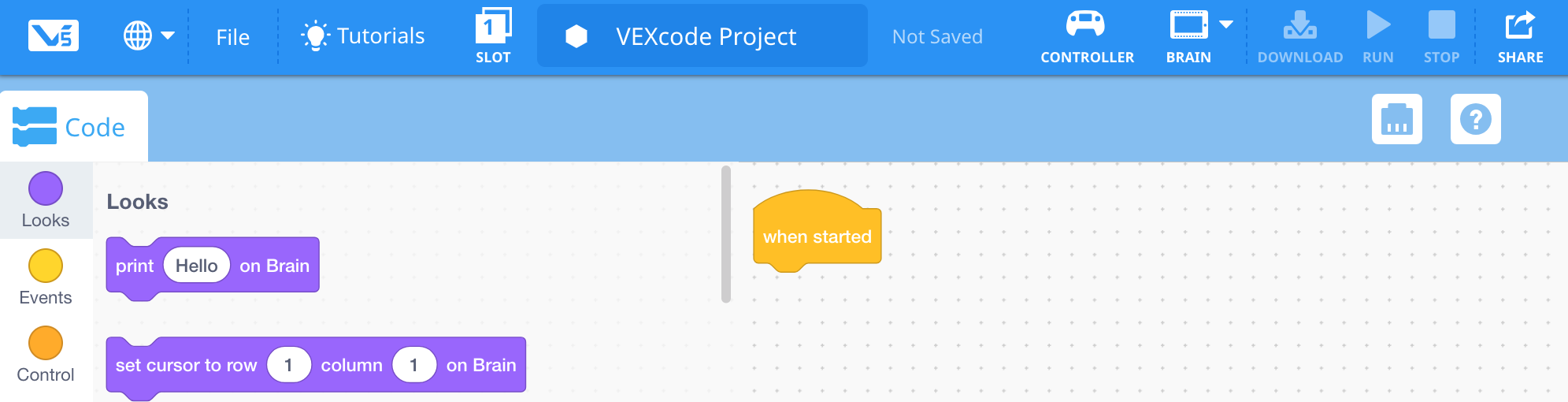

Open VEXcode V5.

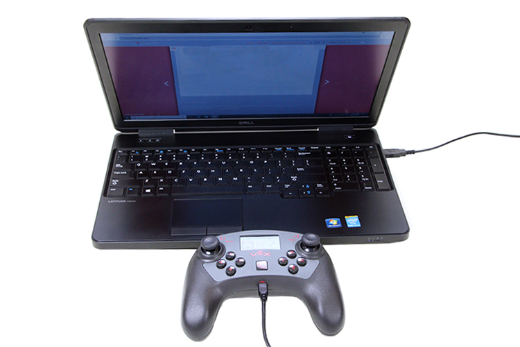

Connect the Controller to the computer via a USB cable. The Controller must be connected to the computer via a USB cable throughout the entire wireless download process.

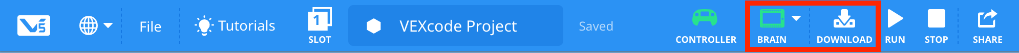

Check that the Brain icon is green and the Download and other icons are white.

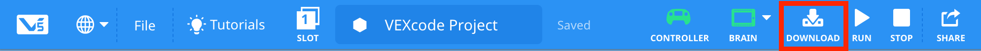

Select Download to download the project to the Brain’s selected slot.
Note: The Download, Run, and Stop icons will turn briefly gray until the download is complete. Downloads done wirelessly take slightly longer than wired downloads.

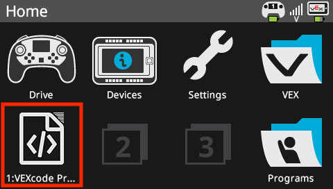

Screenshot of VEX V5 Blocks programming interface showcasing various programming blocks and their connections, illustrating a tutorial on how to use blocks in VEX robotics programming.

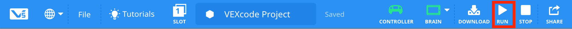

Finally, run the project on the Brain.
Diagram illustrating the various blocks available in V5 robotics, showcasing their functions and connections, as part of the Blocks Tutorials section.
You can also run the project from the toolbar.
Note: The project must already be downloaded before you can run the project from the toolbar.
