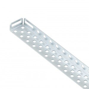

Structural Metal Pieces
What type of structural metal pieces will be used to assemble the chassis? The VEX EDR system has many available options in steel and aluminum. There are C-Channels available in 5 Hole and 2 Hole width in both steel and aluminum. There are aluminum C-Channels in 3 Hole width available. The wider the C-Channel, the less likely it is to bend or twist, however the chassis will be heavier. There are Angles available in both steel and aluminum with square holes and there are steel Angles with slotted holes. Angles are ideal for attaching and supporting towers. The steel Angle with slotted holes allows for connections which are not 90 o. There are Rails available in both steel and aluminum. Rails have end connectors which provide an additional connection point. Rails are one of the types of structural metal included in the Chassis Kits.
C-Channel Angle Rail
Angled view of a metal V5 C-Channel piece. Angled view of a metal V5 Angle piece. Angled view of a metal V5 Rail piece.
Things to consider when selecting a structural metal material. VEX offers metal structure pieces in two material options: steel and aluminum. There are advantages and disadvantages to using a specific material based on the material properties and the pieces available. Both material options can be cut, drilled, filed, and re-shaped to allow for custom designs.

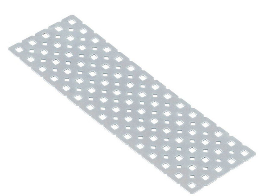

It needs to be noted that metal Plates and metal Bars (which are also available in both steel and aluminum) were left out of this discussion of Structural Metal pieces. This is because plates and bars do not have material which extends in all 3 (X,Y,&Z) spatial axis and therefore do not have the structural strength to be used as a main component for a chassis. However, these metal parts can serve some very important functions in a chassis such as:
  • Plates and Bars can be used to support and connect the other structural components to stiffen a chassis.
  • Steel Plates or steel Bars can be mounted flush to a piece of aluminum structural metal to reinforce its square holes when a shaft or screw is inserted through the hole and the shaft/screw has a large stress applied to it.
  • Plates and Bars can provide a flat surface on a chassis to mount components like the V5 Robot Brain, the V5 Robot Radio, and the V5 Robot Battery.
Plate Bar
Angled view of a metal V5 Plate piece. Angled view of a metal V5 Bar piece.
