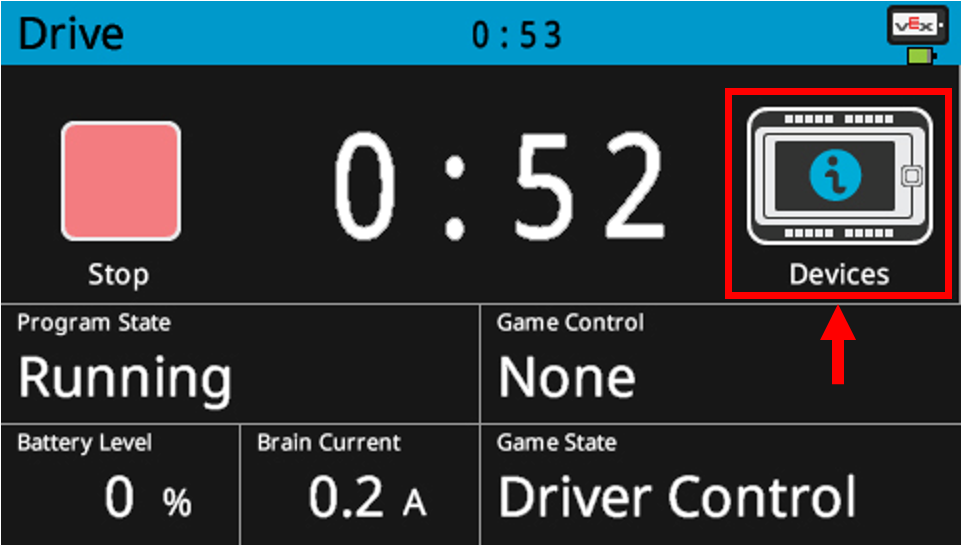

Brain screen is shown while a program in running. There is a Devices option in the menu and it is highlighted.
Click on Devices while a program is running

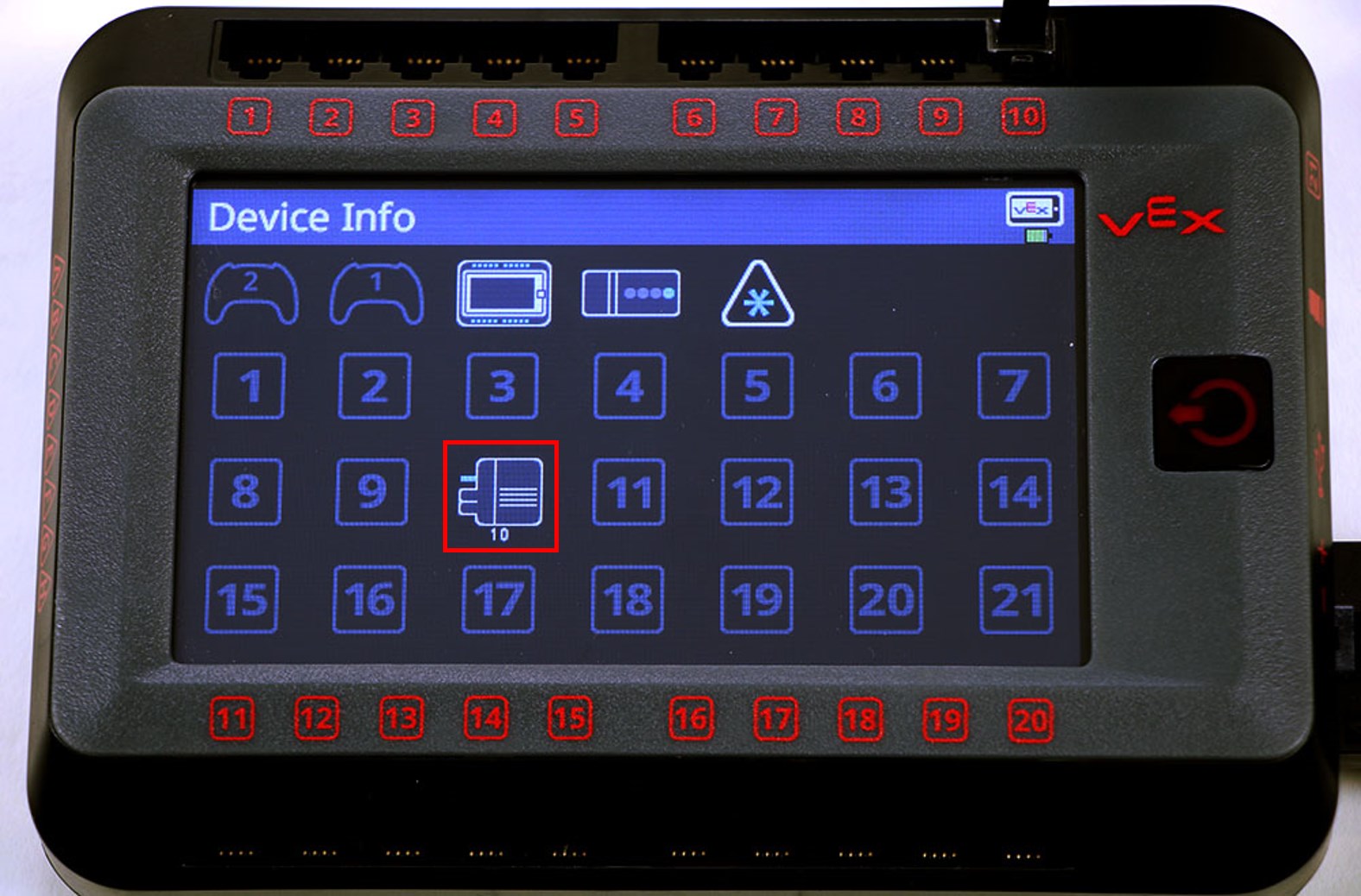

Brain screen is shown in the Device Info menu which has a list of all of the Brain's Smart Ports and connected devices. The Smart Motor icon in the Device Info menu is highlighted to indicate that it can be selected to open its information menu.
Choose the V5 Smart Motor to see its Motor Dashboard
