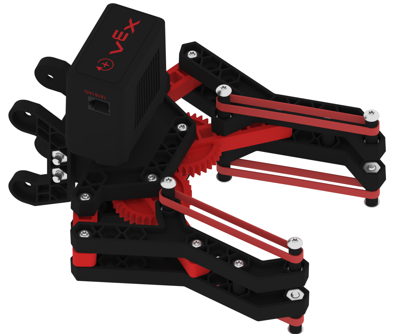

Double-sided Claw
| Double-sided Claw |
Double-sided claw will activate both sides of the claw. Double-sided claws products are available with the Claw Kit and the Claw Kit v2.
Custom assembled double-sided claws typically have an even number of gears setup to move the two sides of the claw. One side of the claw will be attached to the first gear in the assembly and the second side of the claw will be attached to the last gear in the assembly, allowing the claw to open and close as the gears are rotated.

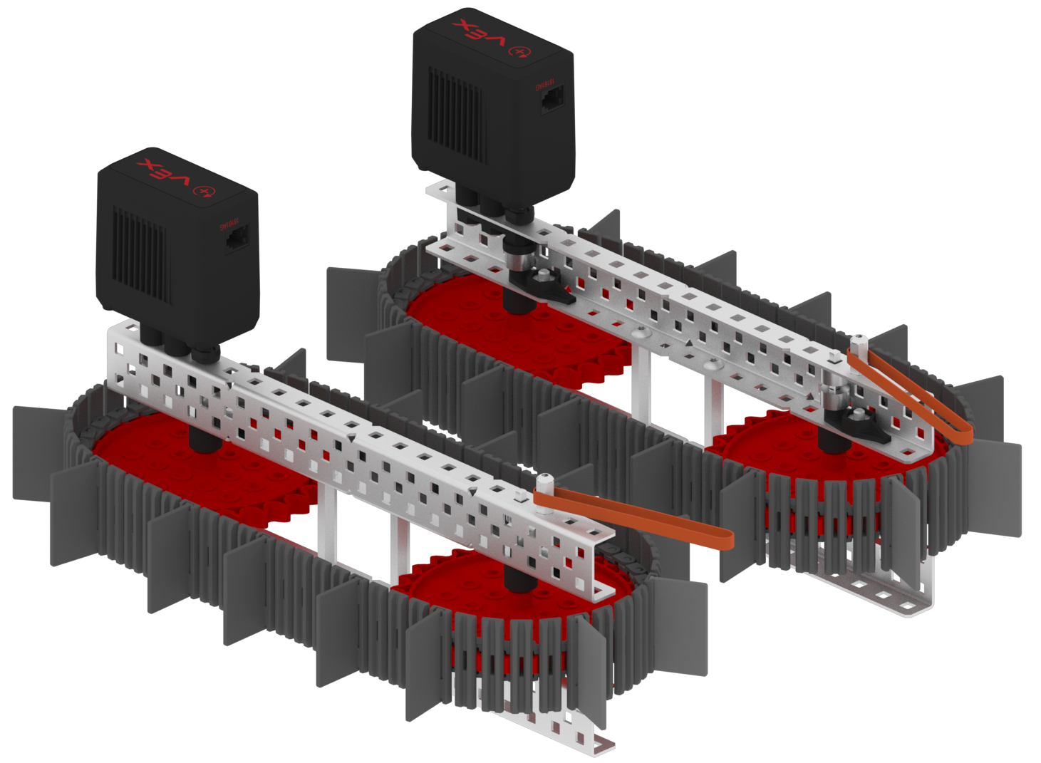

Roller Claws
| Roller Claw |
Roller Claws are typically assembled using Wheels, Intake Rollers, or Tank Treads. Roller claws function by spinning their rollers and having game pieces pulled into the claw. Then the rollers can be reversed, pushing them out.
Roller claws can be assembled with one side of the claw having a fixed piece of structural metal serving as a friction plate. The other side will have an active roller to roll the game piece in, along the fixed side. A roller claw can also be assembled with a roller on both sides of the claw.
Typically roller claws are designed to spin faster than the robot can move forward.
Roller claws allow game pieces to be picked up with less time aligning the robot, however, they require more time and planning to assemble.
