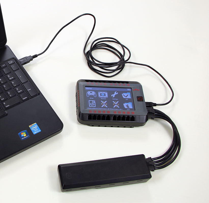

White
Diagram illustrating troubleshooting steps for V5 category issues, featuring labeled components and flowchart elements to guide users in resolving common problems.
No connection - The Brain is not connected to the computer properly or is not powered on.

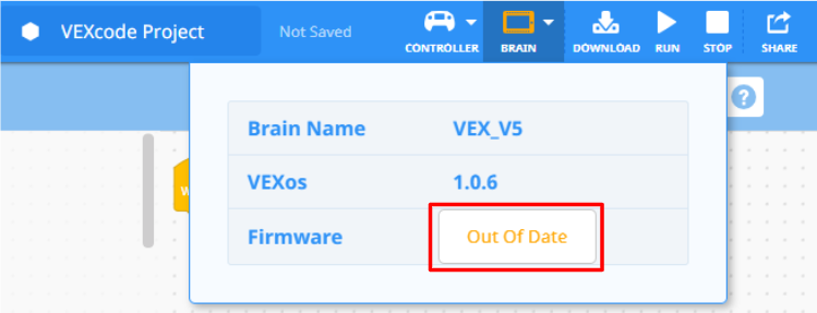

Orange
Diagram illustrating troubleshooting steps for V5 category issues, including key components and their interactions, to assist users in identifying and resolving common problems.
Connected but the Brain's firmware is not up-to-date.

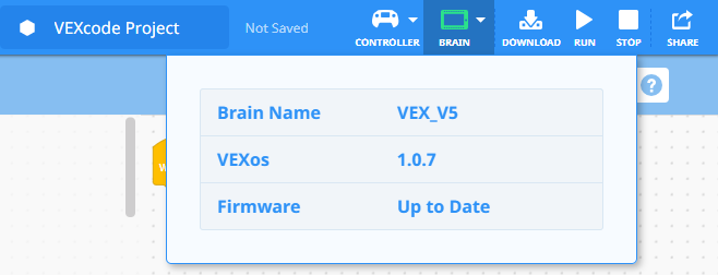

Green
Diagram illustrating troubleshooting steps for V5 category, including key components and potential issues, to assist users in resolving problems effectively.
Connected with up-to-date firmware and ready for a download.
White Brain Icon
Diagram illustrating troubleshooting steps for V5 category issues, featuring labeled components and flowchart elements to guide users in identifying and resolving common problems.
Make sure the Brain is properly wired to your computer and powered on.
  • Check that the USB cable is working properly.
  • Click here for help in getting your Brain to power on.
Orange Brain Icon
You can update the Brain in VEXcode V5 by selecting the Out Of Date button.

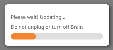

Wait while the firmware updates.

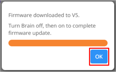

Select OK and power cycle the Brain.
Green Brain Icon
You are ready to download your project.
