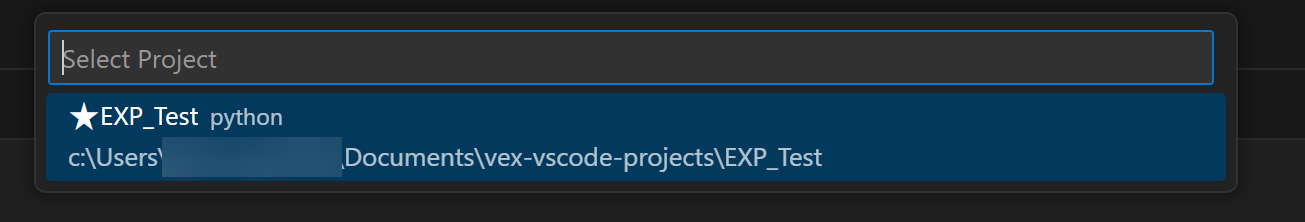

  • (Optional) Select the VEX project for the VEX Extension to build when multiple VEX projects exist inside the workspace.
    Note: VS Code supports multiple workspace projects.
    • Click on the Project Selector Icon on the Toolbar.
      Note: The Project Selector displays the name of the selected project.
    • A Quick Pick List will prompt with all the valid VEX projects inside the workspace. Click on the list item of the VEX project that you want the VEX Extension to build.

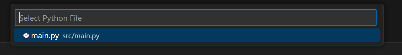

  • (Optional) Select the Python file as the source code for the VEX Extension to build when a Python Project is selected and there are multiple Python files located in the workspace directory.
    Note: The VEX Extension only supports single Python file downloads currently.
    • Click on the Python File Selector Icon on the Toolbar.
      Note: The Python File Selector Icon will appear on the Toolbar only when a VEX Python project is selected. It displays the name of the selected Python file.
    • A Quick Pick List will prompt with all Python files located in the workspace directory. Click on the list item of the Python File to choose it as the source code you want the VEX Extension to build.

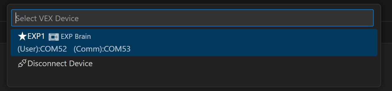

  • (Optional) Select the device for the VEX Extension to connect when multiple VEX devices are connected to the computer.
    • Click the Device Picker Icon on the Toolbar.
      Note: The  Device Picker will appear on the Toolbar only when a VEX device is connected to the computer. It displays the Icon representing the connected VEX device type (a Brain or a Controller) and the Brain name.
      Note: If a VEX Controller is connected to the computer but does not have a radio link to a Brain, no Brain name will be displayed next to the Controller Icon.
    • A Quick Pick List will prompt with all the VEX devices connected to the computer. Click on the list item of the VEX device that you want the VEX Extension to connect.

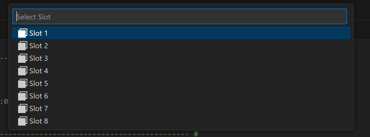

  • Select the Slot the VEX project will be downloaded to on the Brain.
    Note: The EXP Brain has eight Slots to store downloaded programs. Users can choose which Slot to use by selecting the Slot within VS Code. Keep in mind that downloading will replace the previous program using the selected Slot.
    • Click on the Slot Selector Icon on the Toolbar.
    • A Quick Pick List will prompt with the available user program Slots 1-8. Click on the list item of the Slot that you want the VEX project to be downloaded to on the Brain.
