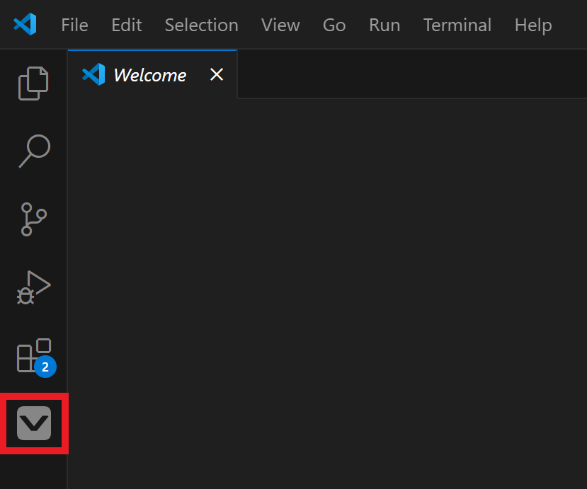

  • Connect the Brain to the VEX VS Code Extension. Click on the VEX icon on the Activity Bar.

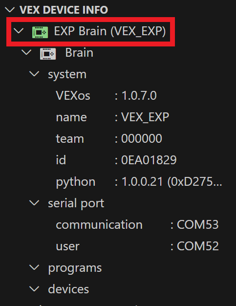

  • The VEX view will open in the Side Bar. Hover the mouse over the VEX Brain Icon or the Brain text under VEX DEVICE INFO in the VEX view.

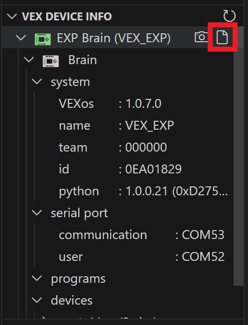

  • The icons will appear next to the Brain text. Click on the Event Log Icon.

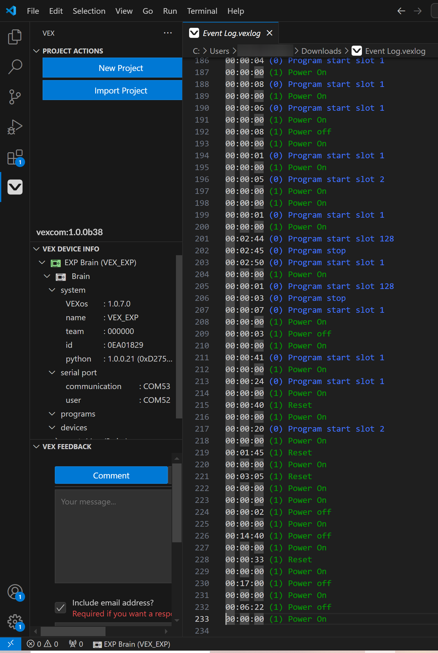

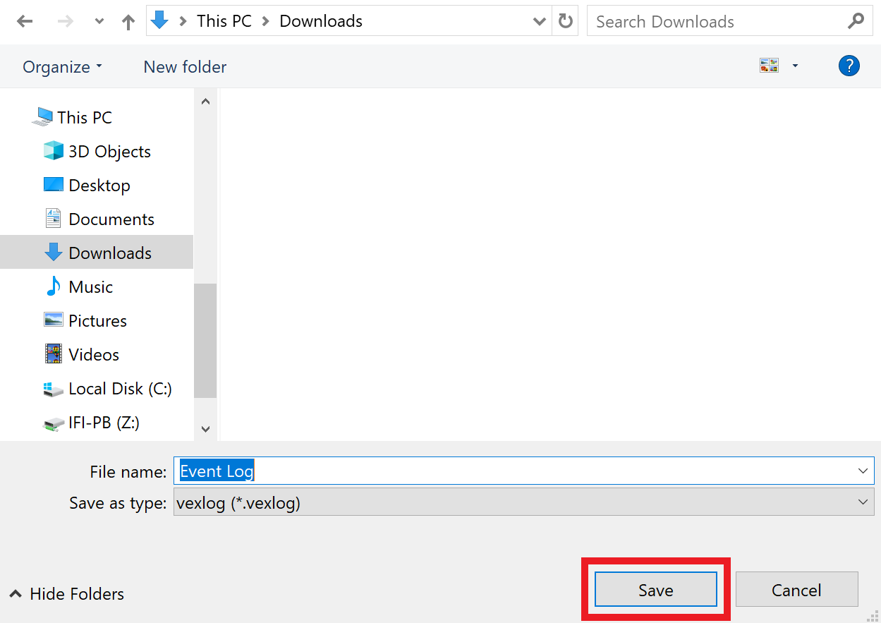

  • The Save As window will prompt. Type a name for the Event Log file in the File name Text Box and click on the Save Button.
  • The Event Log file will be saved on the computer and will be opened in the Editor area of the VS Code.
