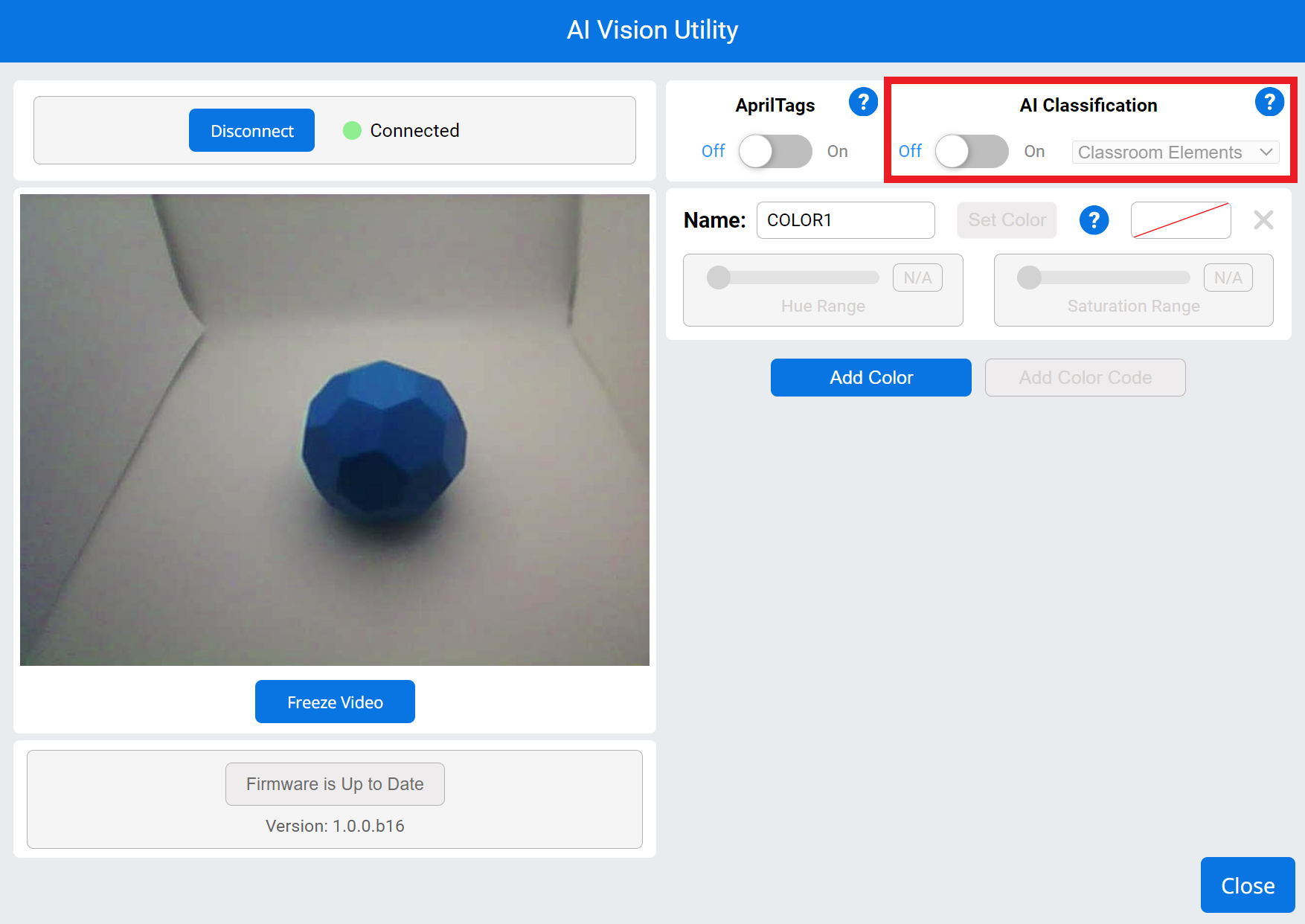

Enable AI Classification Detection
To be able to detect AI Classifications, the AI Vision Sensor's Detection Mode must first be enabled in the AI Vision Utility.
AI Vision Device menu, The configure button in the middle is highlighted.
Select Configure in the AI Vision Sensor's device menu.

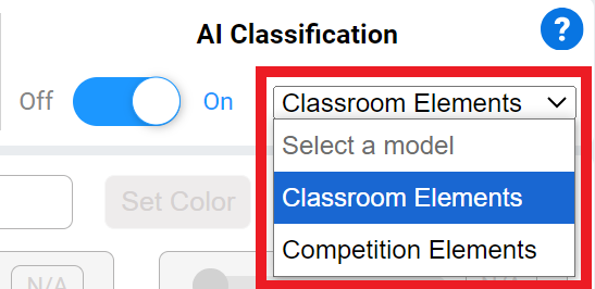

The AI Vision Utility will open. Select the toggle underneath AI Classification to turn on the AI Classification Detection Mode.
AI Classification selection. Select a model, classroom objects, V5RC Push Back, V5RC High Stakes
Select which AI Classification model to use.
For more information on what AI Classifications are included in each model, go to the "AI Classification Models" section in this article.

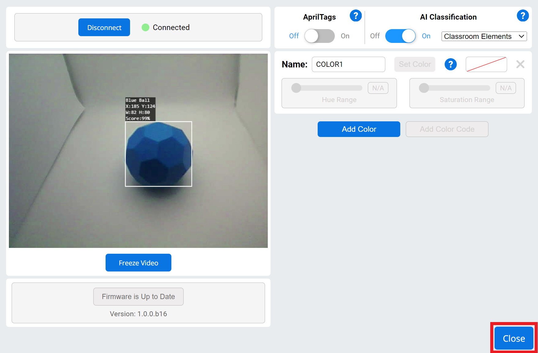

AI Vision Utility with a blue ball in the middle and the AI classification is on.  the close button is highlighted.
Select Close to exit the AI Vision Utility.

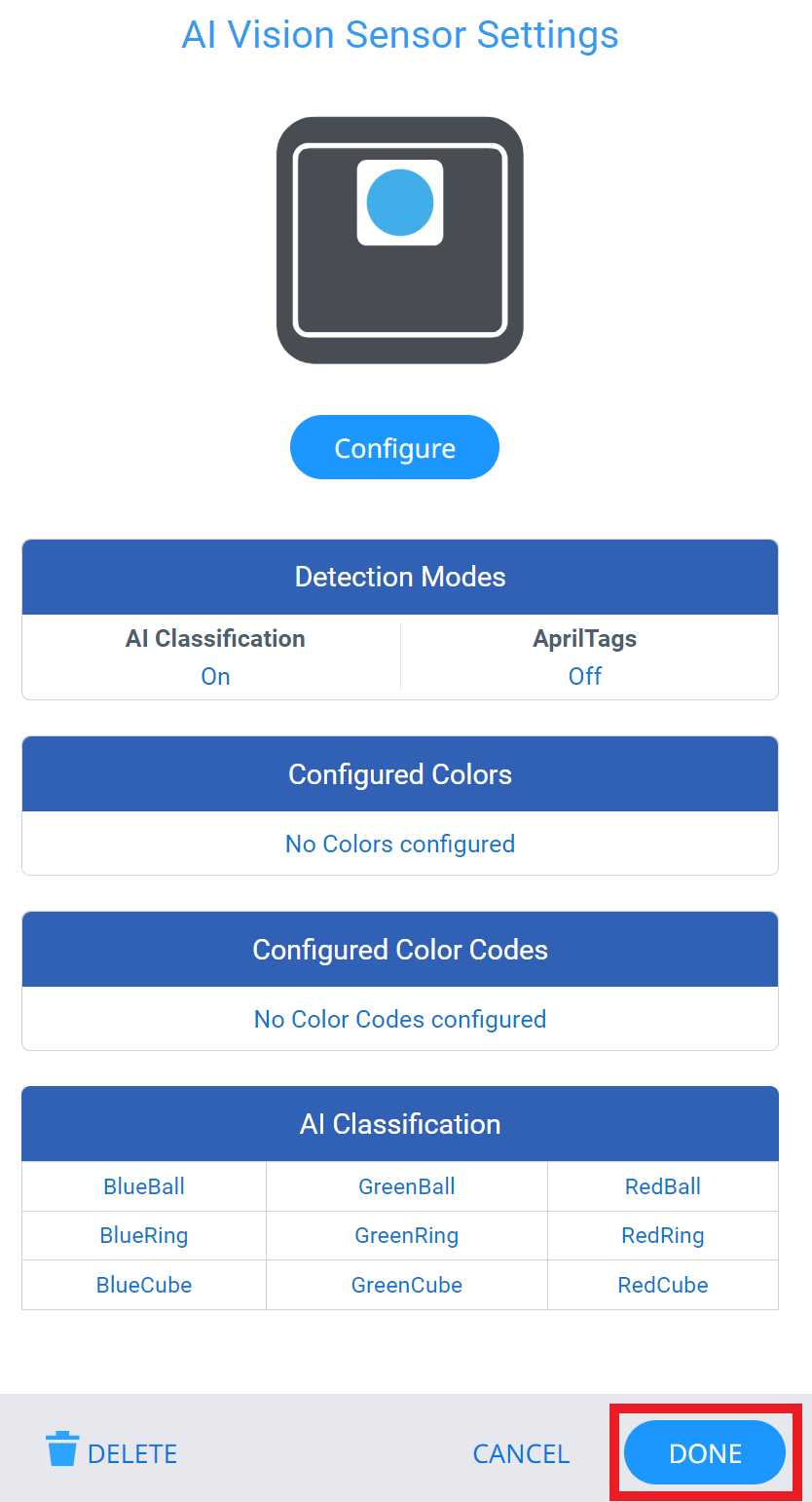

AI Vision Device menu, with the AI Classification turned on and the done button on the bottom right highlighted.
You will see the new AI Classification Detection Mode be set to on and the AI Classifications that will be detected are added at the bottom of the AI Vision Sensor's device menu.
Select Done to save your changes to the AI Vision Sensor's configuration.
