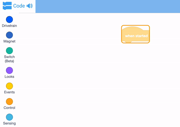

Enable Keyboard Navigation
Screenshot of a VEX IQ Blocks tutorial interface, showcasing programming blocks for building and controlling VEX IQ robots, designed for educational use and beginner robotics enthusiasts.

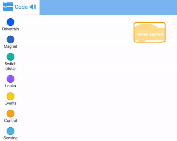

To enable keyboard navigation, press the shift + control + k keys at the same time. When keyboard navigation is enabled, the Block that's highest on the workspace will be highlighted.
To disable keyboard navigation, press shift + control + k again.

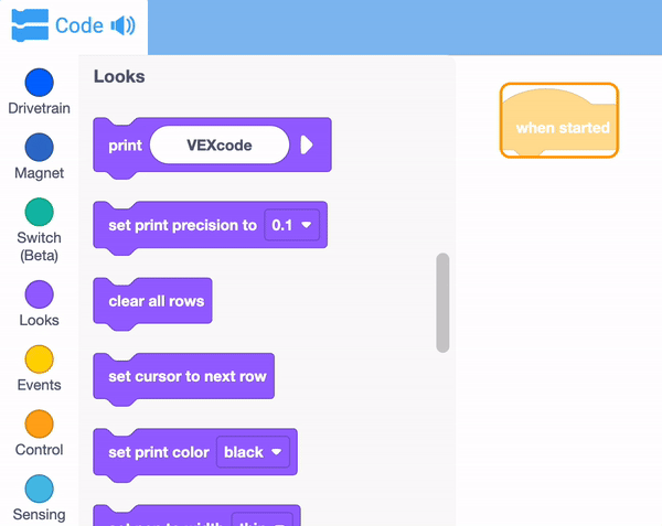

1. Press T on the keyboard, then press S to open the Toolbox. Use S to scroll down and W to scroll up through the Block categories in the Toolbox.
Screenshot of VEXcode IQ Blocks interface showing programming blocks and workspace, illustrating a tutorial for VEX IQ Robotics platform, aimed at educators and students learning robotics concepts.

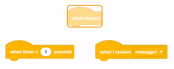

2. Navigate to the section containing the Block you want to add to the workspace.
Screenshot of a VEX IQ Blocks programming tutorial, showcasing various programming blocks and their functions for educational robotics projects.

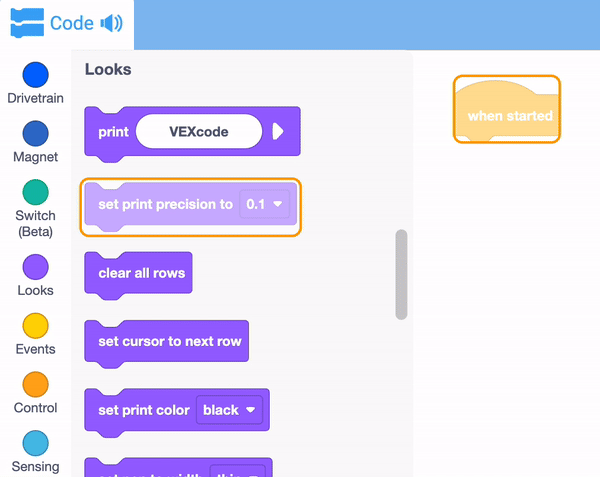

3. Press D, then press S until you reach the desired Block.
Screenshot of a VEX IQ Blocks tutorial interface, showcasing programming blocks and options for building robotic projects, aimed at educational purposes for beginners in robotics.
4. Press return to add the Block to the workspace.

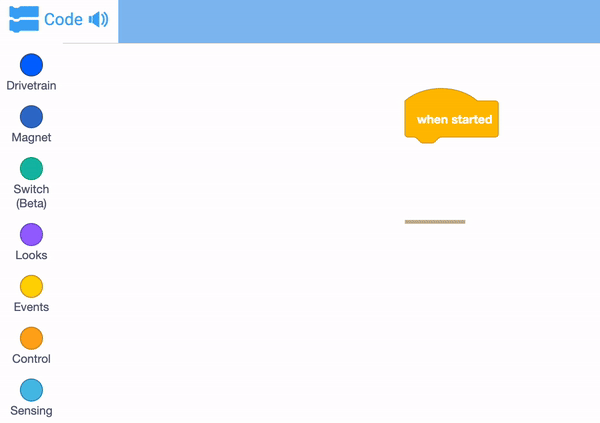

Change Where Blocks are Added on the Workspace
The location where Blocks are added to the workspace can be changed by doing the following:
Screenshot of a VEX IQ Blocks tutorial interface, showcasing programming blocks and options for building educational robotics projects, aimed at beginners and educators in the VEX IQ Robotics platform.
1. Press A to select the stack.
Screenshot of a VEX IQ Blocks tutorial interface, showcasing programming blocks and options for building educational robotics projects, designed for beginners and educators in the VEX IQ ecosystem.

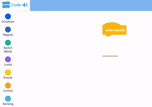

2. Press A again to go to the cursor select.
Diagram illustrating the VEX IQ Blocks programming interface, showcasing various programming blocks and their functions for educational robotics projects.
3. Hold shift and use WASD (W and S move up and down, A and D move left and right) to move the cursor to where you want the new Block to be added.
Screenshot of a VEX IQ Blocks programming tutorial, showcasing various coding blocks and their functions, aimed at helping beginners understand programming concepts for the VEX IQ Robotics platform.
4. Press Enter to save the cursor's current location.
Diagram illustrating the VEX IQ Blocks programming interface, showcasing various programming blocks and their functionalities for educational robotics projects.
5. Use the steps from above to scroll through the Toolbox and add a Block to the workspace.

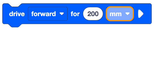

Edit Block Parameters
Screenshot of a VEX IQ Blocks tutorial interface, showcasing programming blocks and options for building and controlling VEX IQ robots, aimed at educators and students learning robotics concepts.

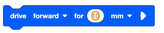

1. Press D to enter the block and access its first parameter.
Diagram illustrating the VEX IQ Blocks programming interface, showcasing various programming blocks and their functions, designed to assist educators and students in learning robotics concepts through visual programming.
2. Use W and S to navigate through the block's parameters.

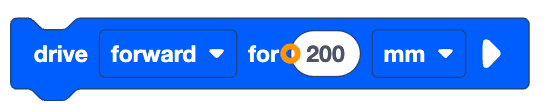

Edit Text Inside a Non-Comment Block
Diagram illustrating the VEX IQ Blocks programming interface, showcasing various coding blocks and their functions for educational robotics projects, as part of the Blocks Tutorials section in the VEX IQ knowledge base.
1. To edit text inside of a Block, navigate to the circular highlight to the left of the text field.
2. Press D to go inside the text field parameter.

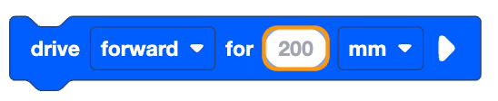

3. Press S to select the text field.
Diagram illustrating the VEX IQ Blocks programming interface, showcasing various blocks and their functions for educational robotics programming tutorials.
4. Press D to select the text.
Screenshot of a VEX IQ Blocks tutorial interface, showcasing programming blocks and coding options for building and controlling VEX IQ robots, designed for educational purposes and beginner robotics enthusiasts.
5. Press return to start typing in the field. Once you are finished, press esc to deselect the text field.

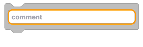

Edit Text Inside a Comment Block
Diagram illustrating the VEX IQ robotics system components and their connections, used in Blocks Tutorials for educational purposes in robotics programming and building.
1. Once the stack that the Comment Block is inside is selected, press D to select the Comment Block.
Screenshot of VEXcode IQ Blocks interface, showcasing programming blocks for VEX IQ robotics projects, illustrating options for building and programming robots in educational settings.
2. Press D again to select the Comment Block's text field.
Screenshot of a VEX IQ Blocks tutorial interface, showcasing programming blocks and options for building and controlling VEX IQ robots, aimed at educational purposes and beginner robotics enthusiasts.
3. Press return to start typing and press esc once you are finished to save what was written.
Note: Pressing return to type inside a Comment Block will delete all text that was previously in the text field.

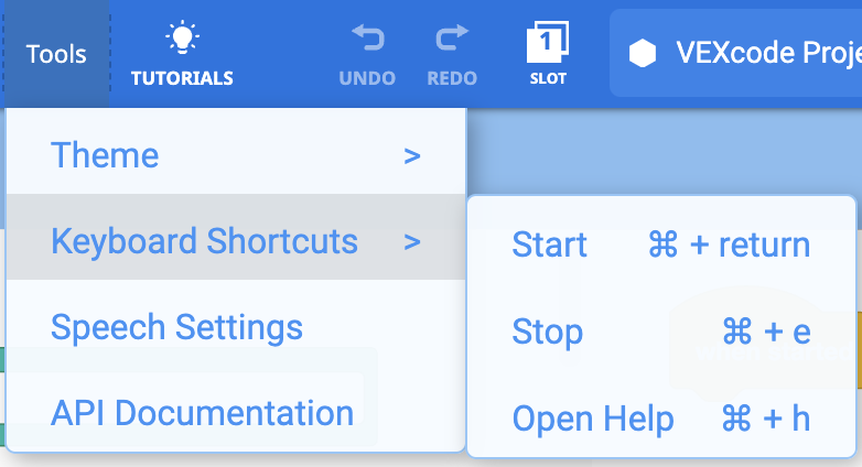

Start and Stop the Project
Diagram illustrating the VEX IQ Robotics platform components and programming concepts, featured in the Blocks Tutorials section of the VEX IQ knowledge base, aimed at educating beginners in robotics and enhancing their understanding of the VEX IQ system.
Once you are finished coding your project, you can use keyboard shortcuts to activate the project:
  • + return will start the project.
  • + e will stop a running project.
  • + h will open the help documentation for Blocks.
