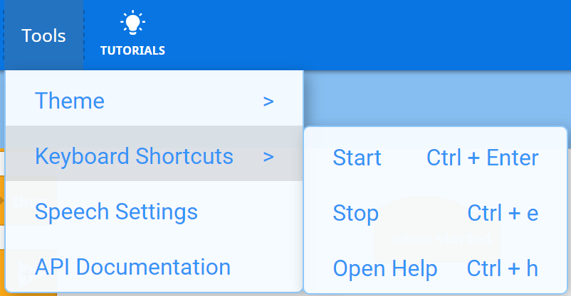

Once you are finished coding your project, you can use keyboard shortcuts to activate the project:
  • Ctrl + Enter will start the project.
  • Ctrl + e will stop a running project.
  • Ctrl + h will open the help documentation for Blocks.
