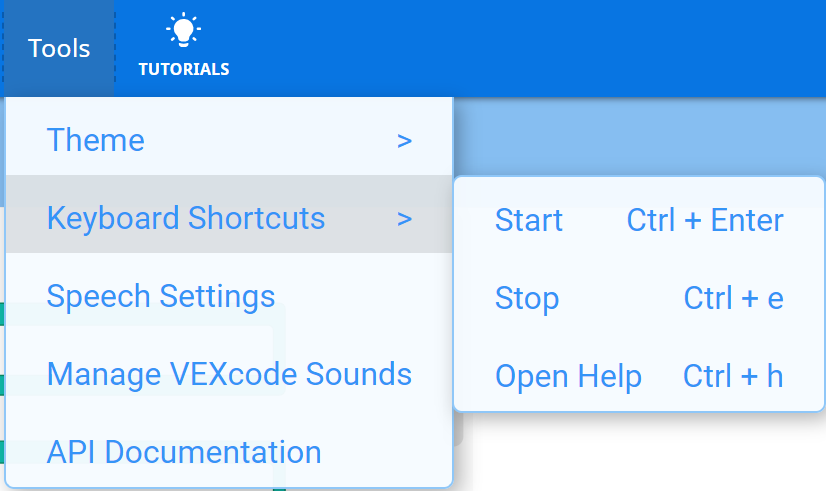

Start and Stop the Project
Diagram illustrating various V5 blocks used in robotics tutorials, showcasing their connections and functions for educational purposes.
Once you are finished coding your project, you can use keyboard shortcuts to activate the project:
  • Ctrl + Enter will start the project.
  • Ctrl + e will stop a running project.
  • Ctrl + h will open the help documentation for Blocks.
