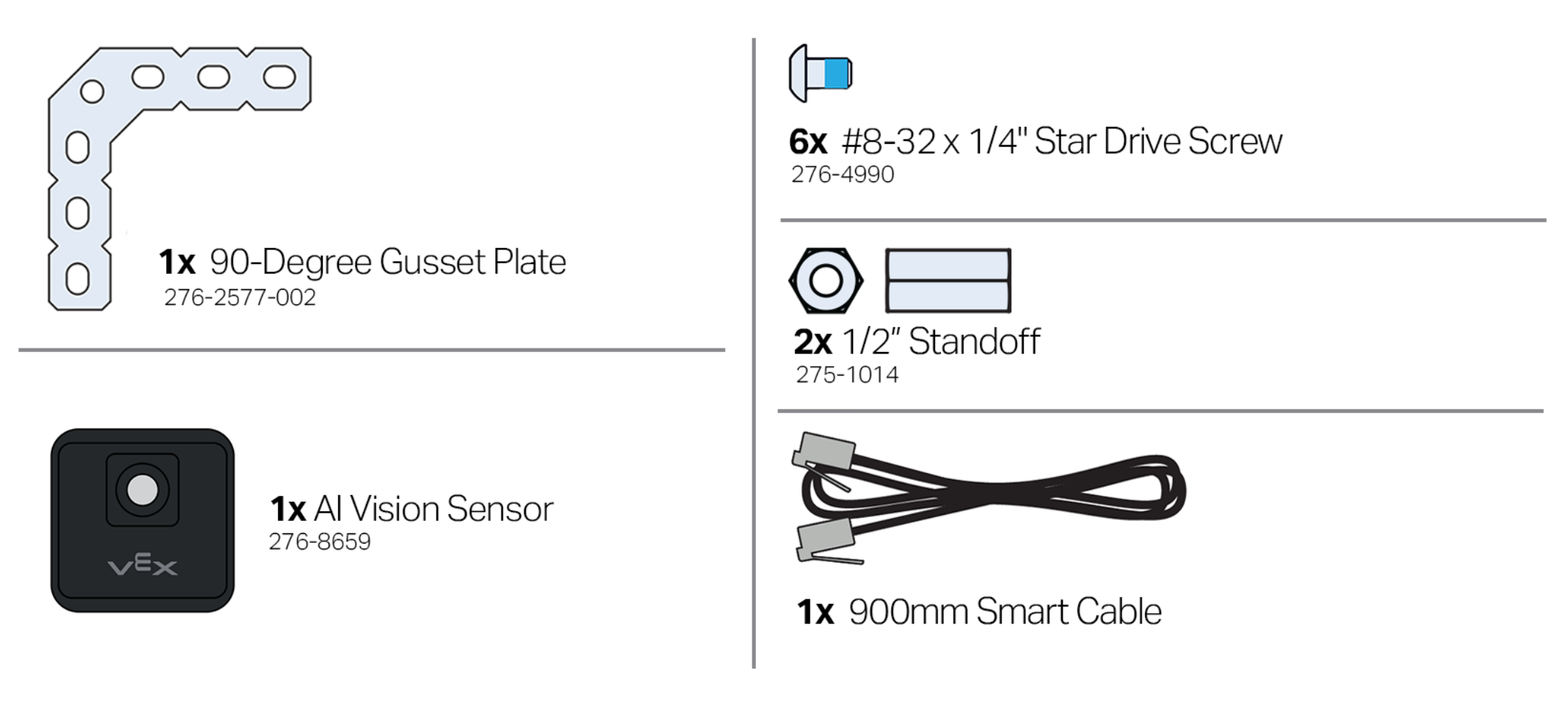

Visual list of parts that are needed to mount and wire the AI Vision Sensor to the V5 Advanced Trainingbot. An image of each part is shown along with its name and quantity.
Gather the hardware you will need:
  • 1 - 90-Degree Gusset Plate
  • 1 - AI Vision Sensor
  • 6 - 1/4" Star Drive Locking Screws
  • 2 - 1/2" Standoffs
  • 1 - 900mm Smart cable
Once your hardware is gathered, follow the 3D Build instructions to mount your AI Vision Sensor to the V5 Advanced Trainingbot!
