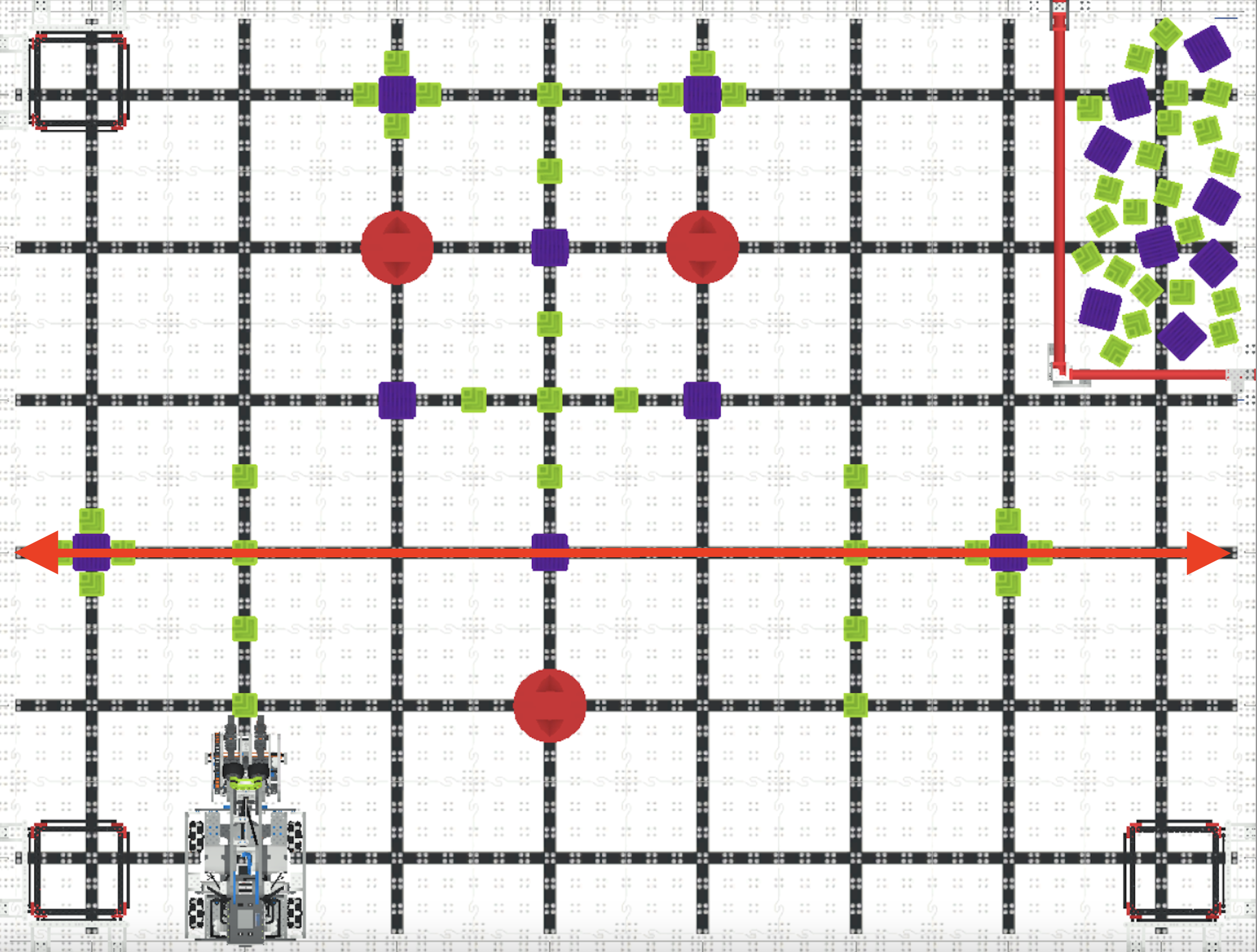

Field Dimensions

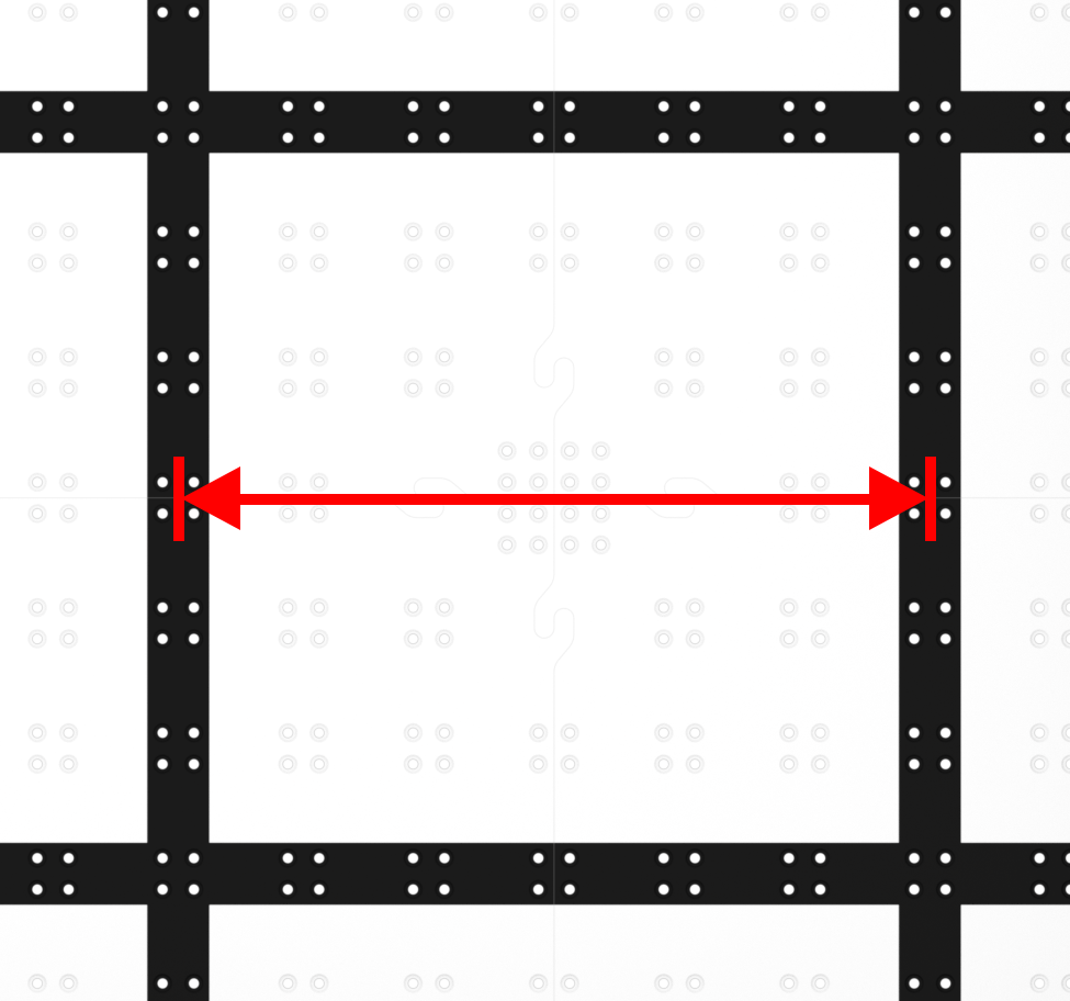

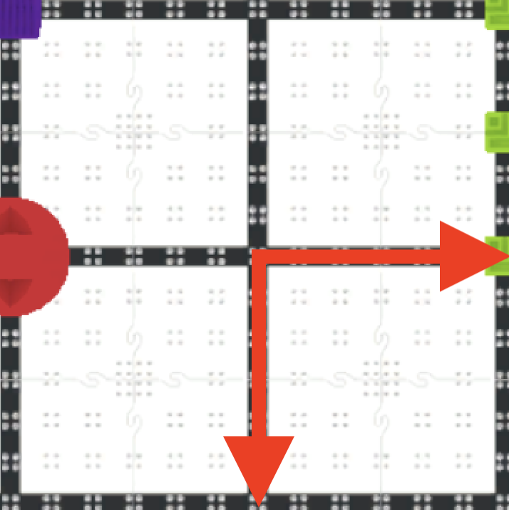

Each full black square on the Field is 300mm by 300mm (~12 inches by 12 inches).

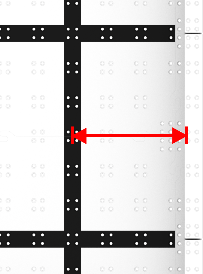

Each half black square on the Field is 150mm by 300mm (~6 inches by 12 inches).

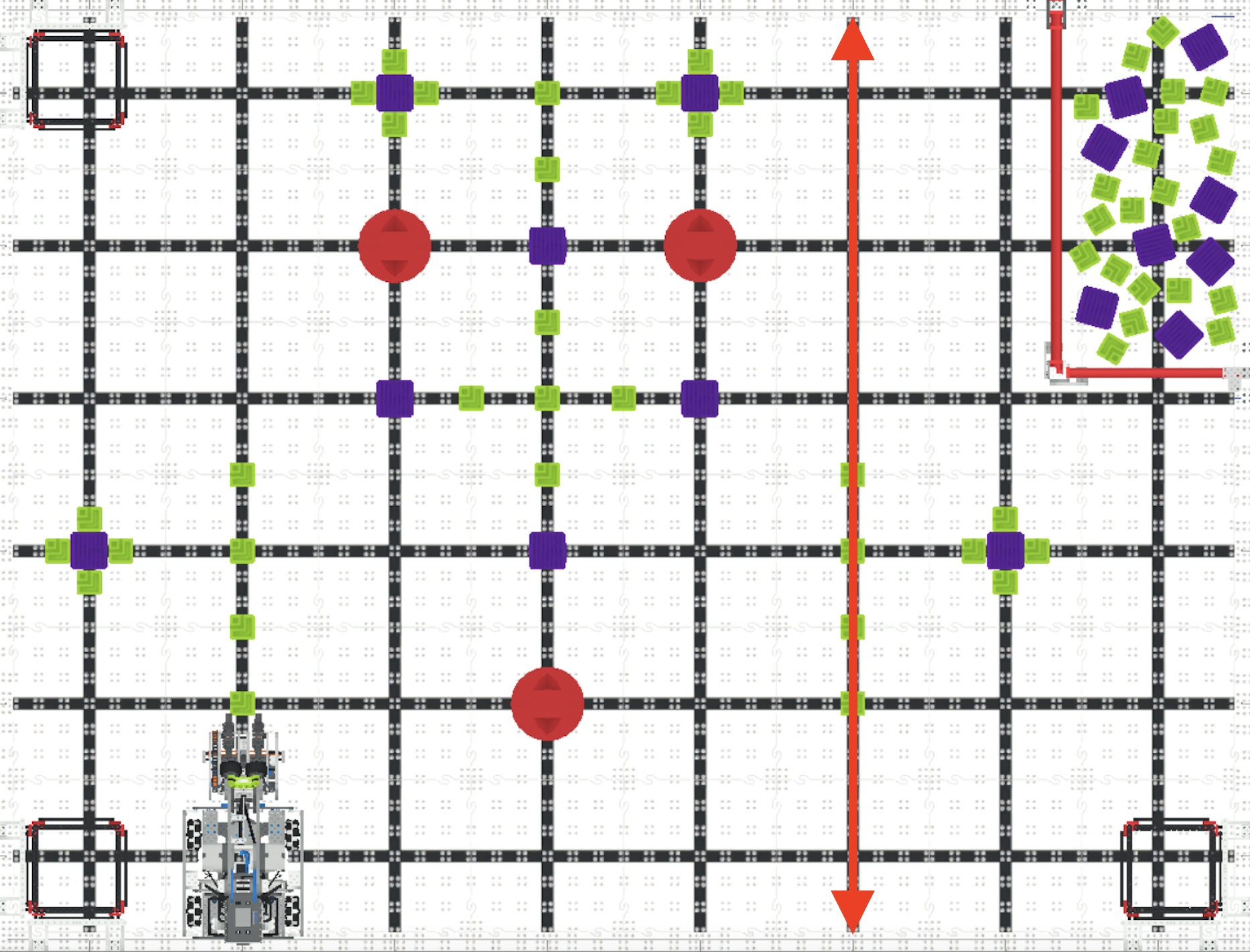

The Field is 5 full black squares, and two half-squares long.
In total, the Field is 1.8m (~6 feet) long.

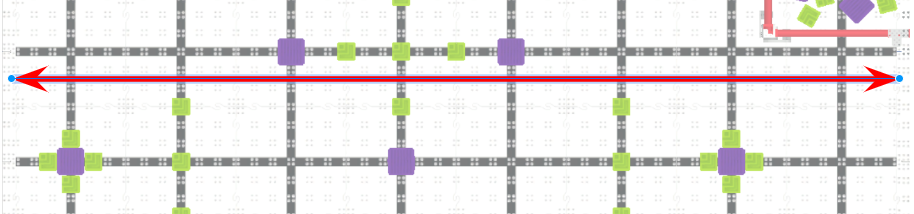

The Field is 7 full black squares, and two half-squares wide.
In total, the Field is 2.4m (~8 feet) wide.

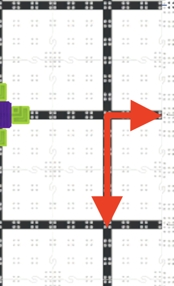

Measurement Notes
Each full square measurement begins and ends at the center of the black line on the Tile.
Each partial square measurement begins at the center of the black line and ends at the inner edge of the wall.

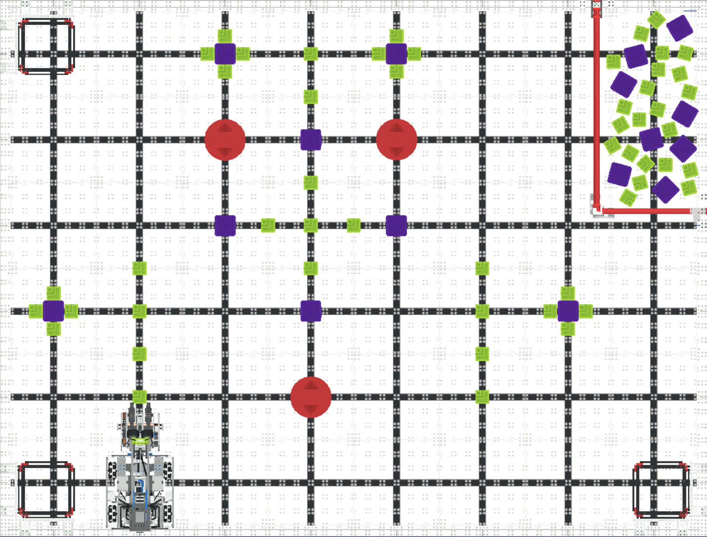

The total Field measurements begin and end at the inner edge of the walls.
